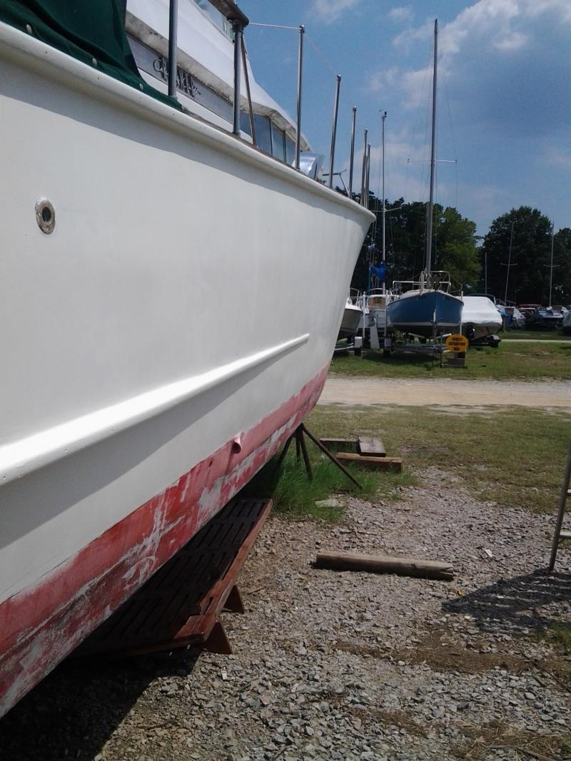

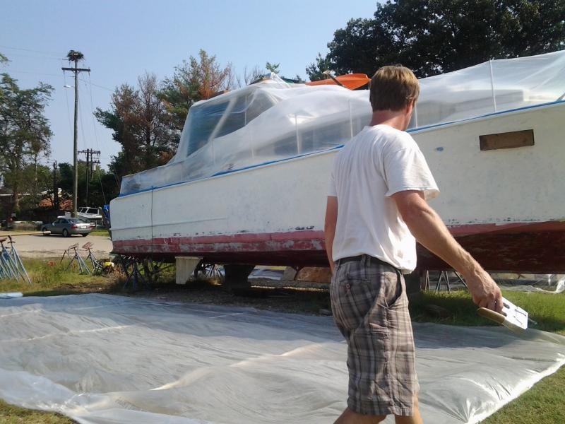

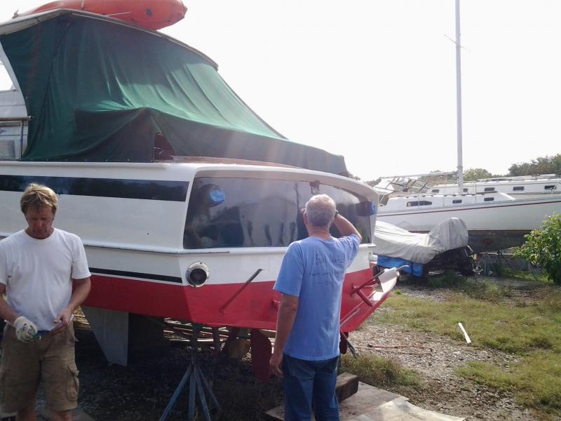

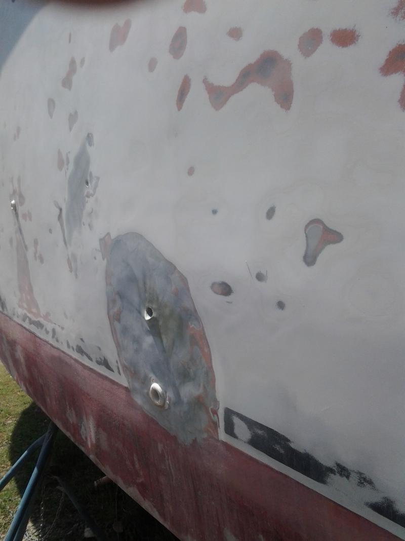

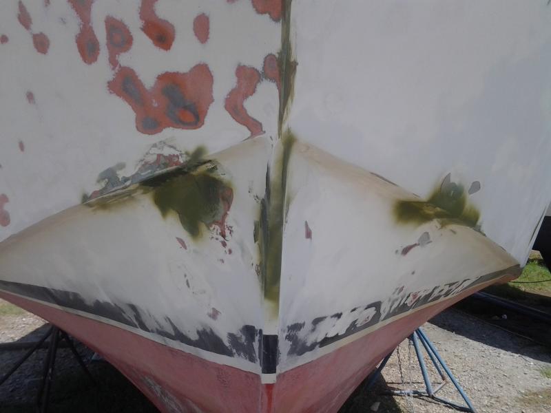

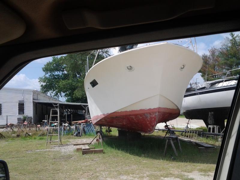

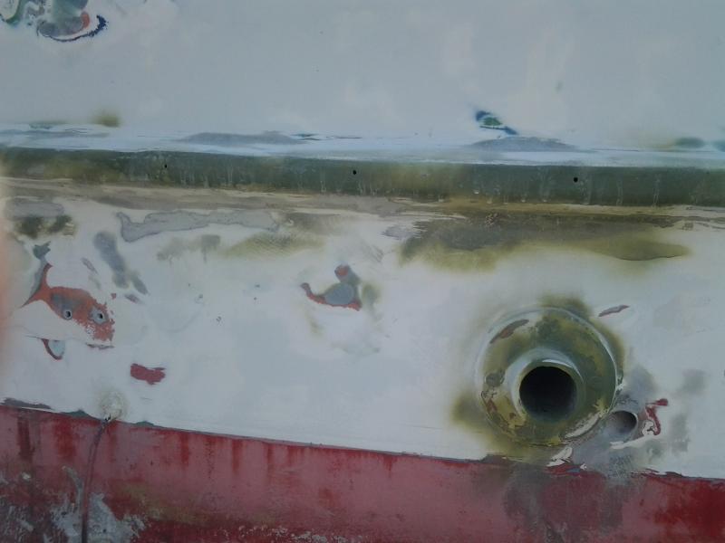

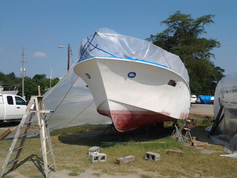

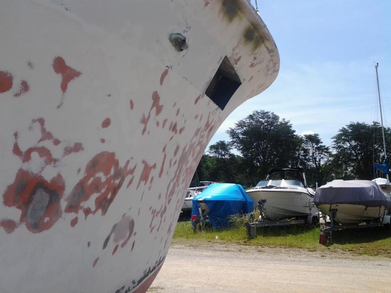

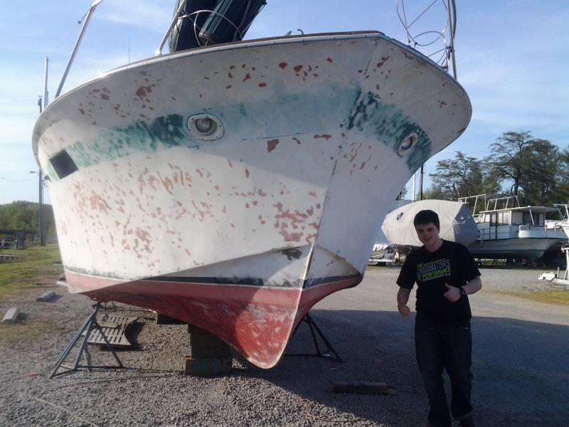

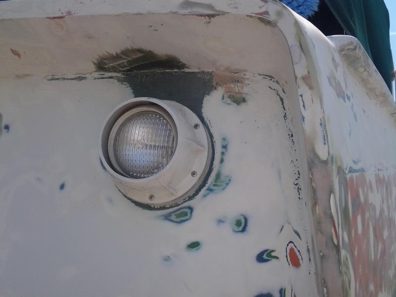

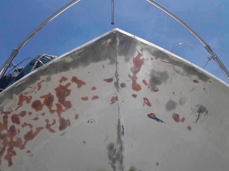

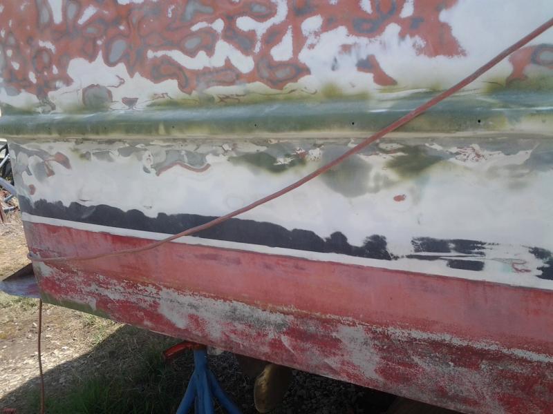

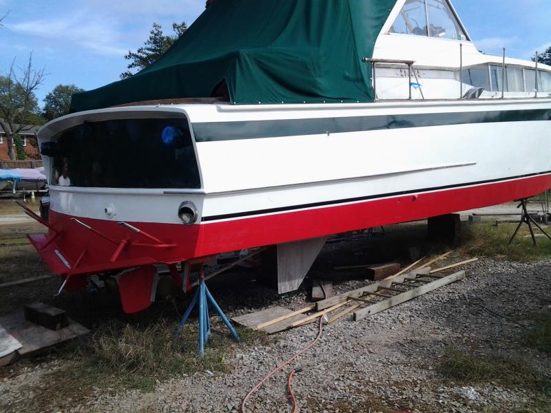

    Well, it only took all summer and six elbows, but we laid on the final touches today - stripes and shadowbox transom paint -- all in Hunter Green (yes, its a factory color).
    Starting with photos showing early stages - strip and sand; then - fill and fair, and sand some more: all down to 320. After paint, wet sand out to 1500-2000. Take a look and be amazed! :p

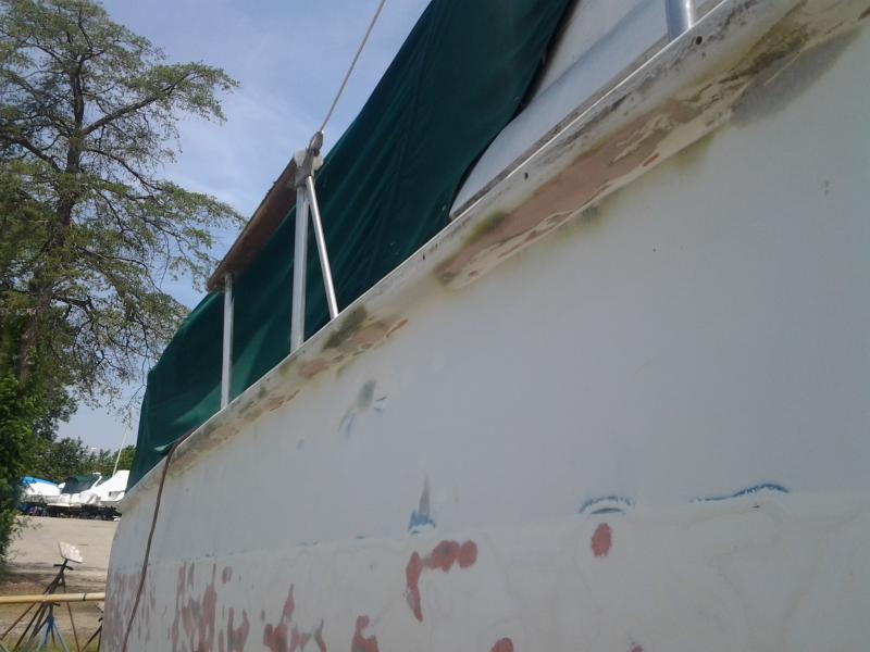

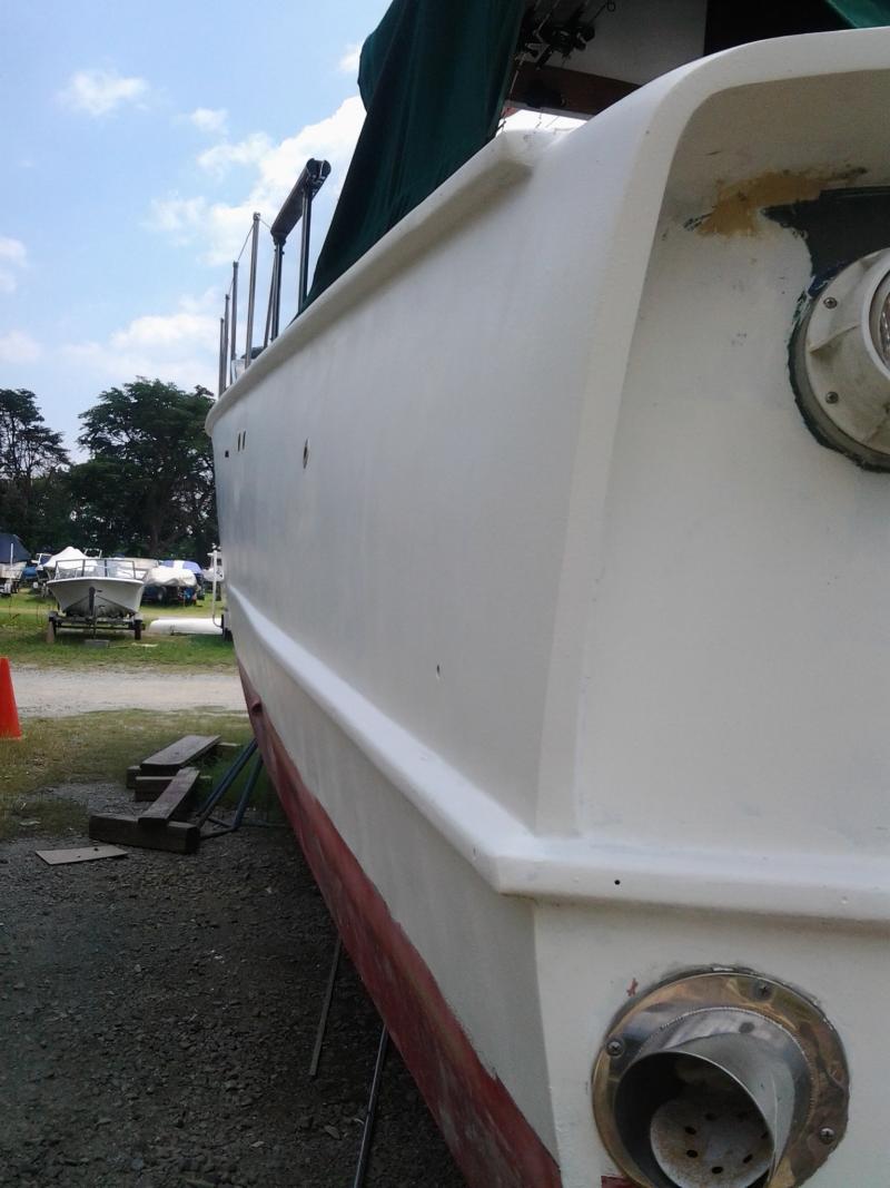

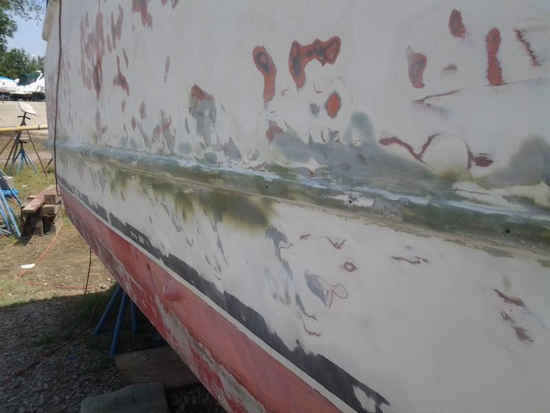

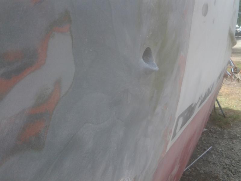

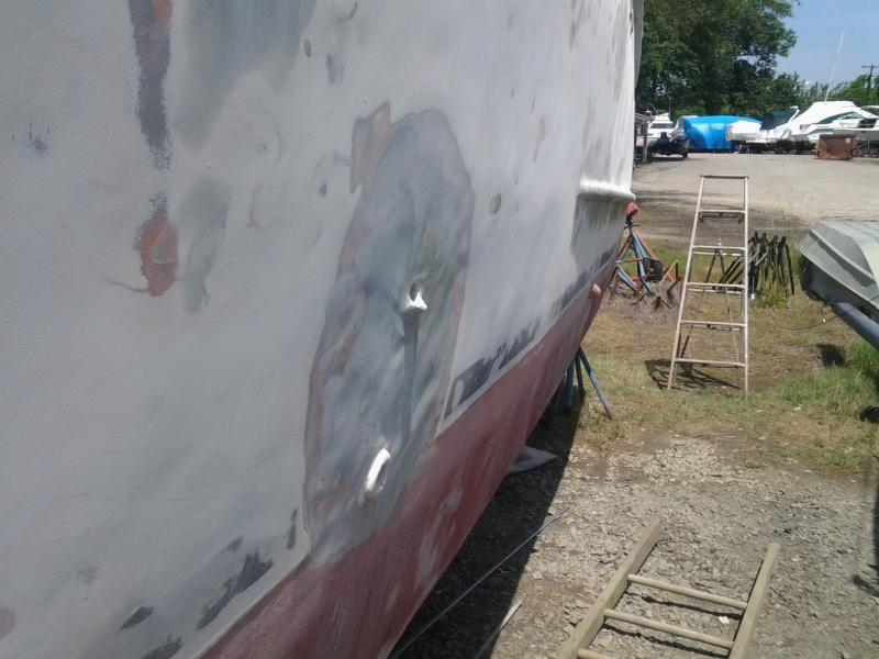

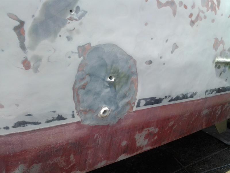

    Fill and Fair
    Used Evercoat Gold and Bondo Green (fiberglass strands) after cleaning out voids and zinc chromating to ensure adhesion and corrosion reduction.
    Actually the second time we have painted in past 12 years - all those memories came rolling back in as we did it again.:eek:
    Cheers!
    -Eric

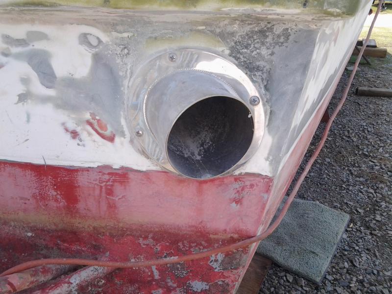

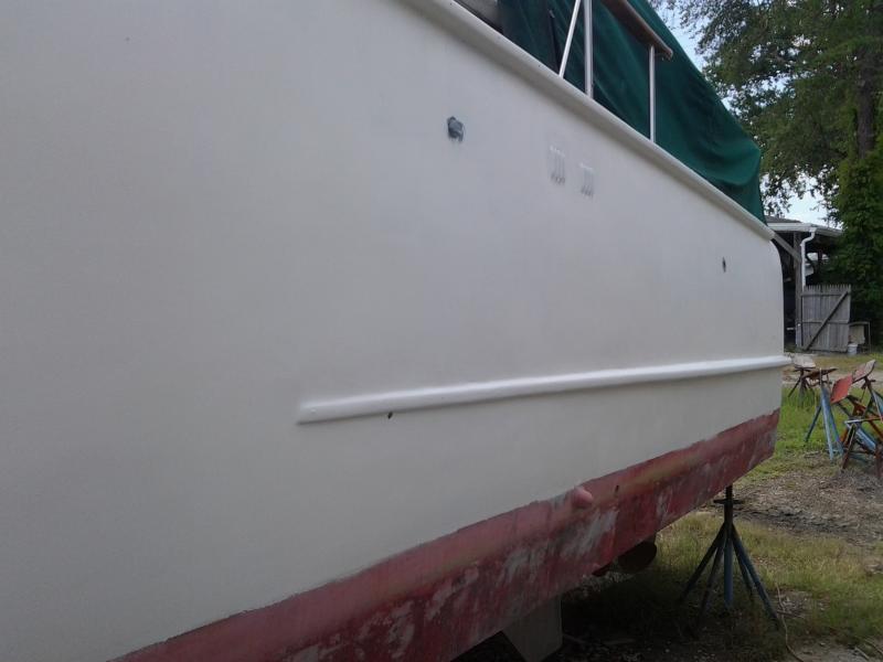

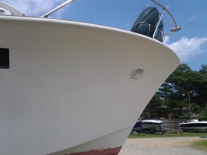

    Custom feature..,
    ..., made from green goo: the new ac drain "spout" - maybe now the water won't run down the side all the time.
    We'll see (it worked in rehearsal).
    :cool:
  4. alloyed2sea
    alloyed2sea Moderator
    Jan 28, 2004
    872
    Alex, VA

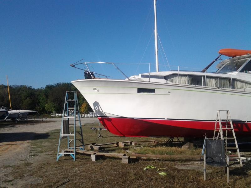

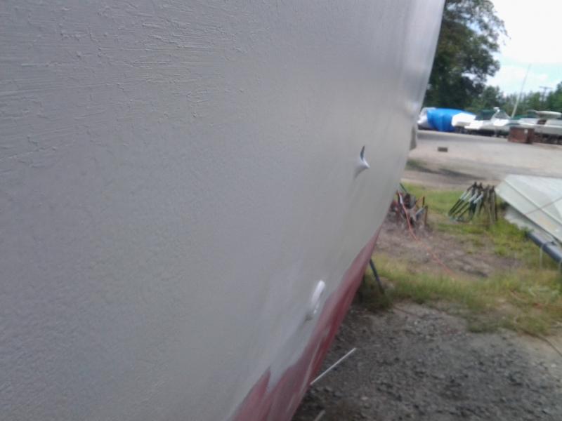

    Epoxy primer
    Expensive and demanding (another round of sanding 37 feet of Roamer up, over and back) but worth it. Rolled and tipped.
    Elbow #'s 3 & 4. :(

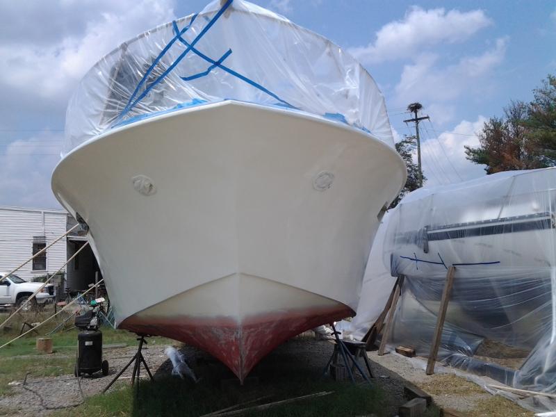

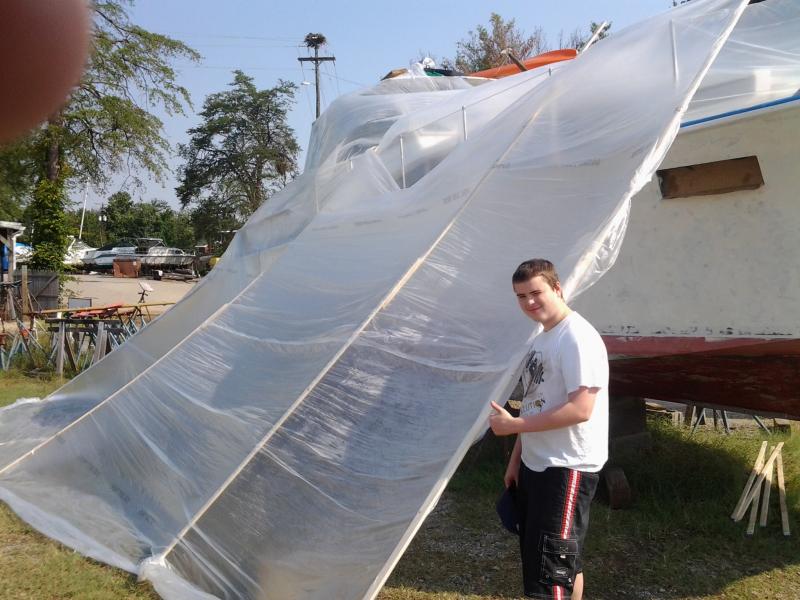

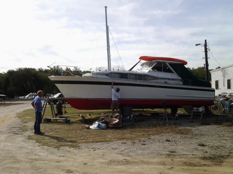

    Next up: Mr. Urethane
    Two parts: mix and spray.
    We even tried to make a tent - too windy.
    Waited for a better day (early in the morning that is).

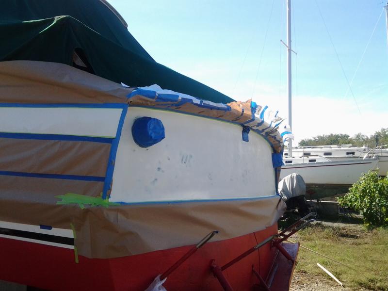

  6. alloyed2sea
    Jan 28, 2004
    872
    Alex, VA

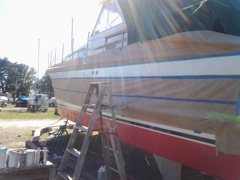

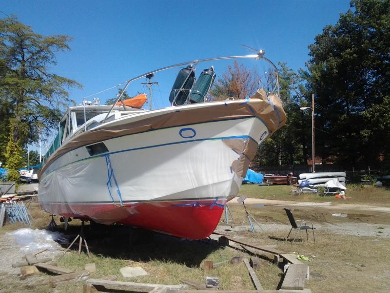

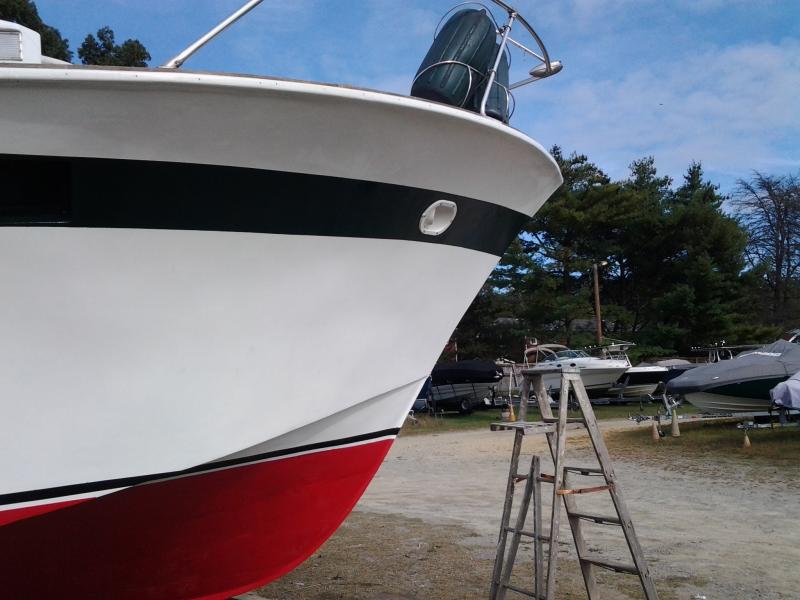

    Something's Missing
    Duh!
    Stripes laddie.
    Now where did my measuring sticks go anyway.
    Measure twice and tape her up nice.
    Not allowed to do it twice.
    :eek:

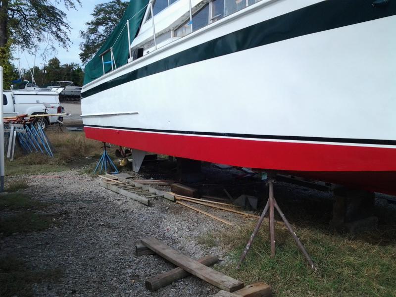

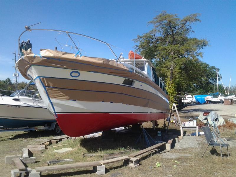

  7. alloyed2sea
    Jan 28, 2004
    872
    Alex, VA
    Punch me Judy!
    Red bottom, black booties, and green stripes on iceberg white - quite rite!
    :D
  8. NYCAP123
    11,210
    Beautifully done job, but OMG! May I suggest that you mark your calendars for 11 years from now with the reminder "Get 4 sale signs", because by then you probably won't have much elbow grease (or knees) left and your helper may be involved with other projects (such as a helper like yours when you did this the first time).:D
    P.S. I love that little buildout at the outflow. Never seen anything quite like it. Please be sure to let us know how that works out.
    Great father/son project. Kudos.

    Next Up
    Wet sand stripe out to 2000 and buff/compound out entire job (photos, soon, soon!).
    Then maybe we'll start on next big project: Gel coat the cabin top and replace wood between fiberglass and deck with fillets!
    :cool:.
    Who wants to help out?
