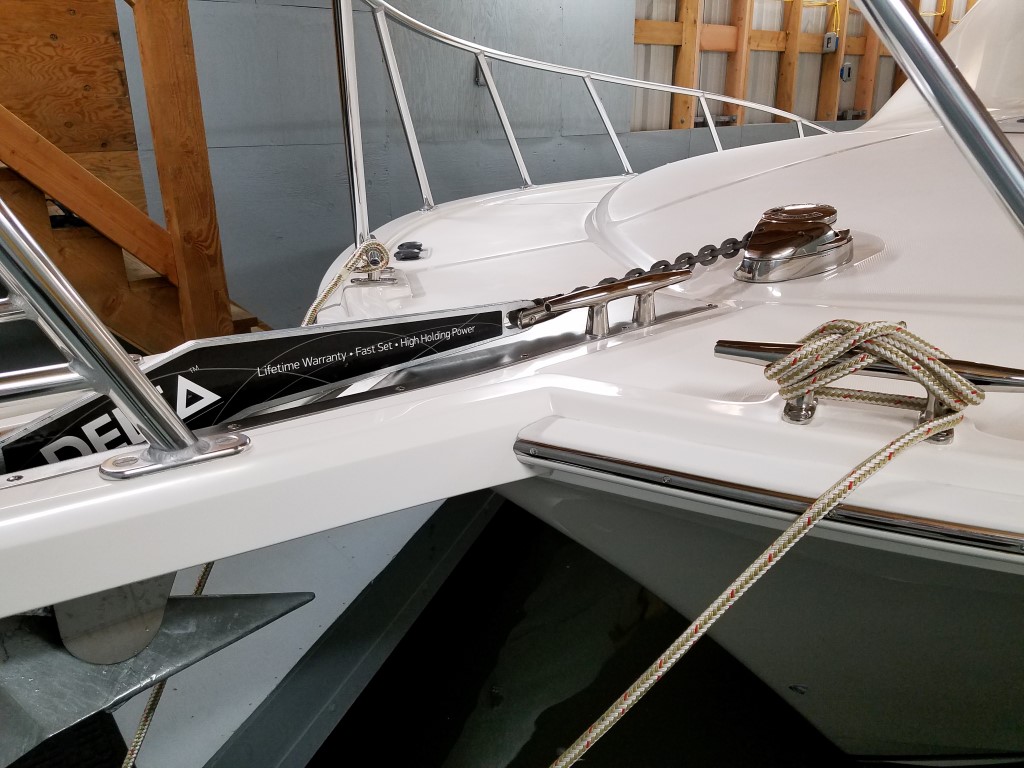

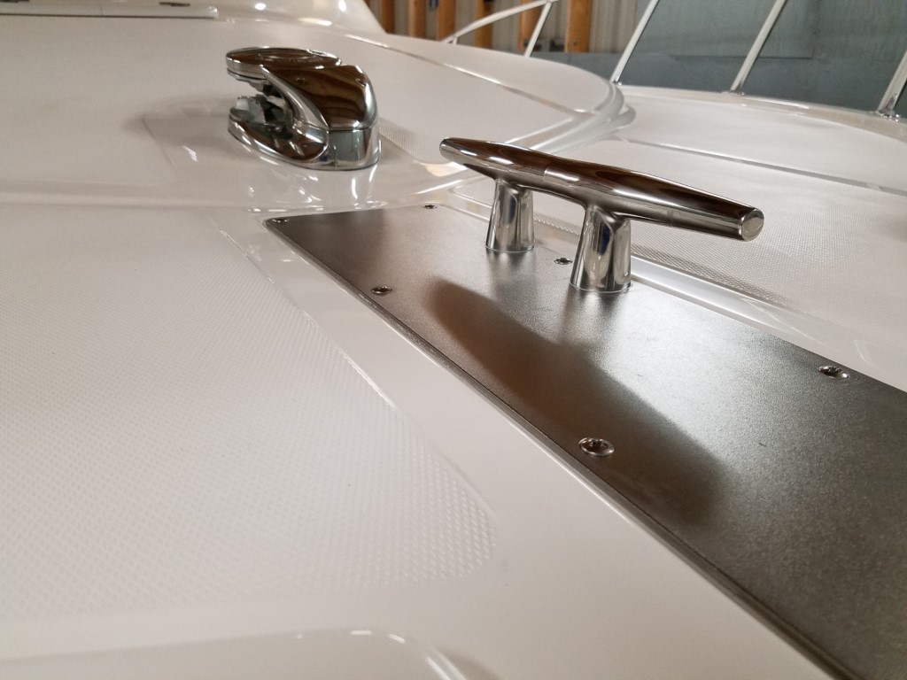

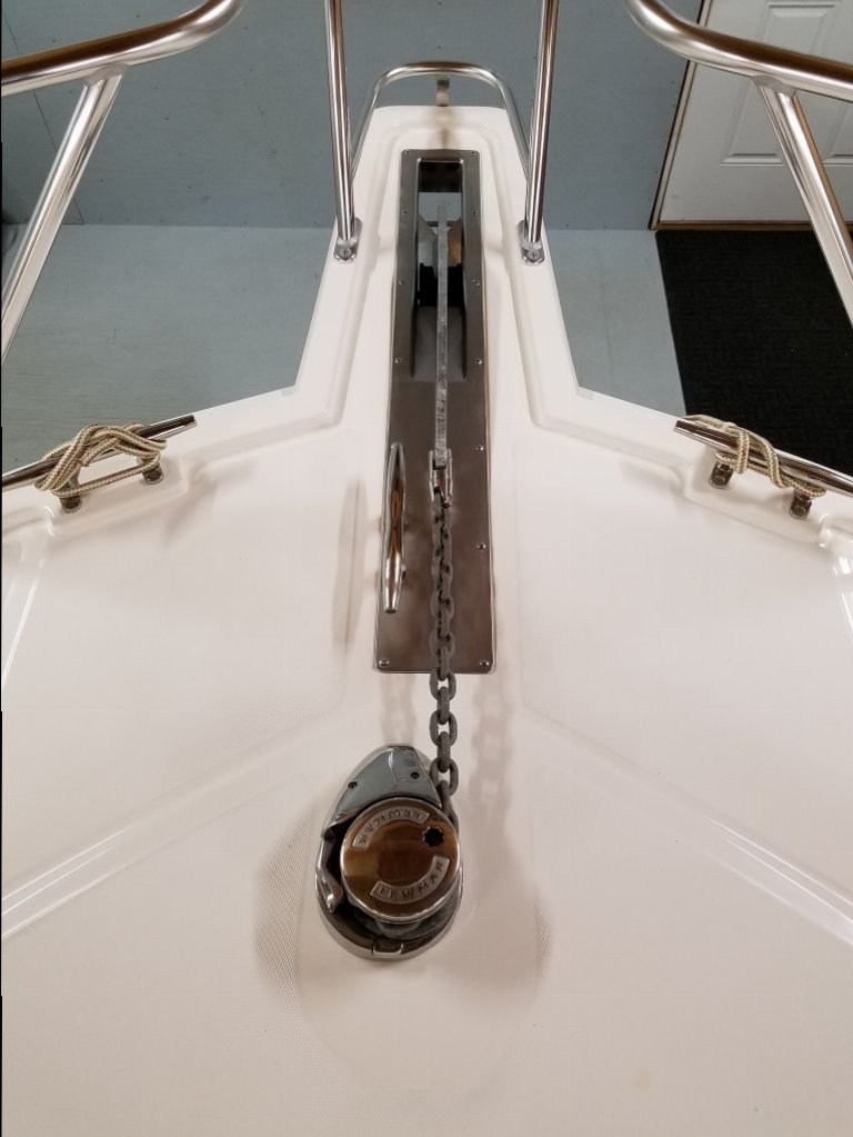

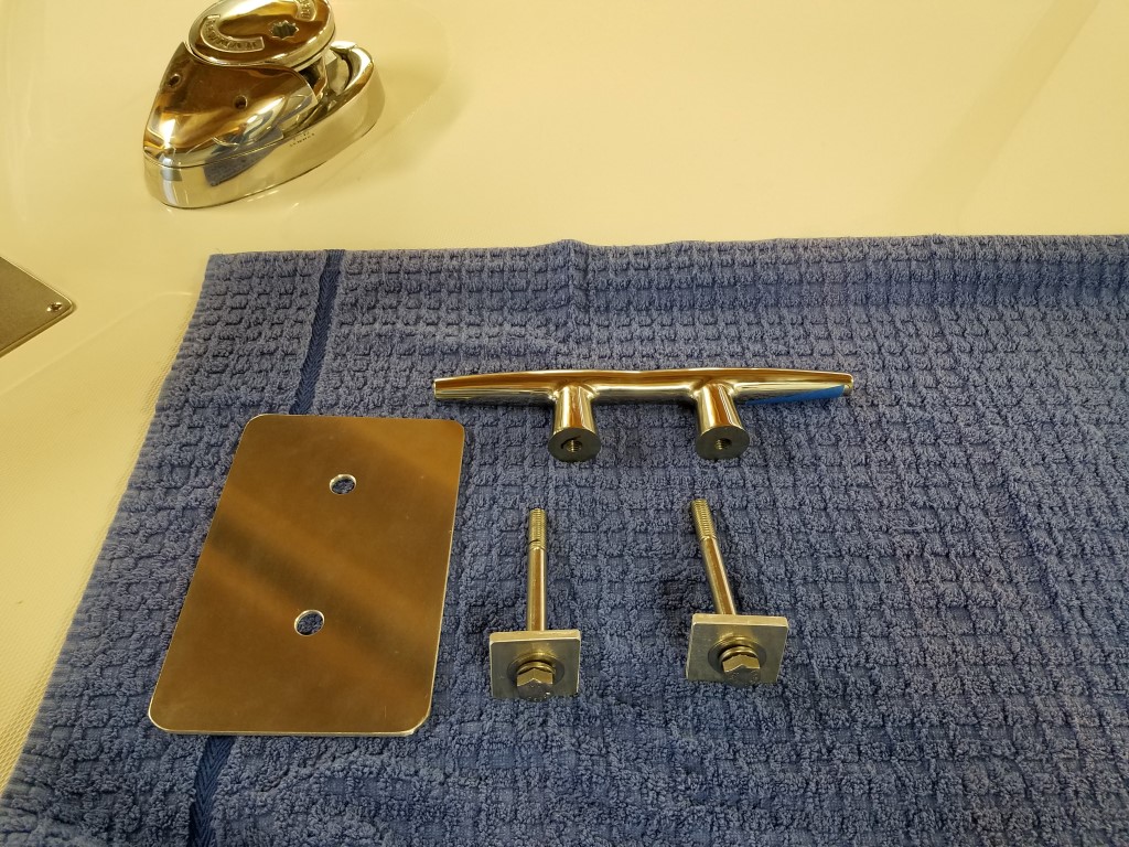

    Finished up the new windlass cleat yesterday while working on the boat. The chain to 8 plait connection is almost done as well so I am planning to put the ground tackle on the boat today. Going to measure pulpit before and after and see what effect 200lbs has on static trim with 3/4 fuel and water.

    Was pleasantly surprised today after adding the chain, rode, and anchor to the boat. Pulpit height off the water only changed by 1.25 inches. Went from 64 to 62.75 inches off the water to bottom of pulpit.

    Nice pics! the setup looks good. With that cleat there it is also pretty easy now to put a safety line to the chain for when running. Have heard of too many horror stories of windlasses disengaging and captains seeing the anchor dragging behind at high speed, or worse ending up in one of the wheels

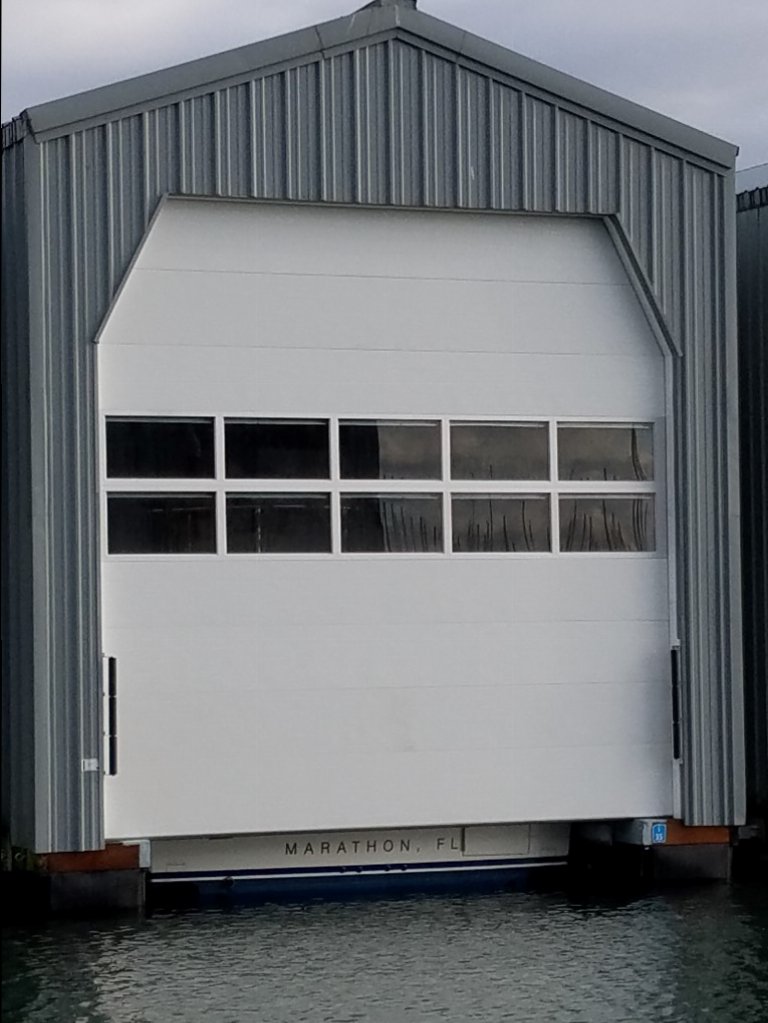

    I just love the pictures in a wonderful shop.
    I finally recognized it was an enclosed slip (lil slow at times).
    Double wow on all.

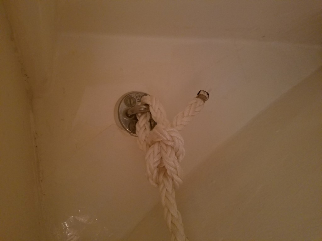

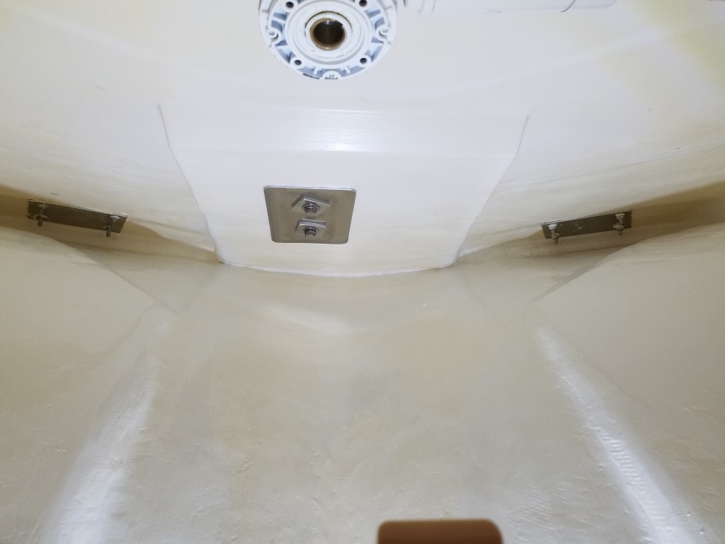

    This was the tie off point that the Cabo has in the anchor locker. Would be curious to know if other Cabo's are outfitted the same. To mark the end of the rode we marked a 12 inch section 20ft from the end as a warning.

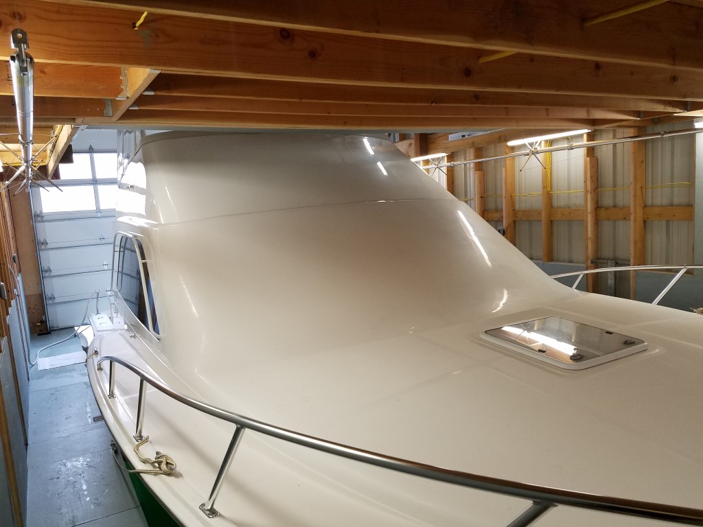

    Thank you. I bought the building in 2009 and absolutely love having it to house the boat. Loft with couch and tv upstairs that is finished and work room for equipment and tools as well. The 40 Cabo is a perfect fit after some mods to house so I will not be moving up for a long long time.

    The boat house is awesome.
    Yes, that is the factory tie off point for the anchor from Cabo. All of the Cabo's from the factory came with a Fortress, 6-10' of chain and around 300' of rope.......
