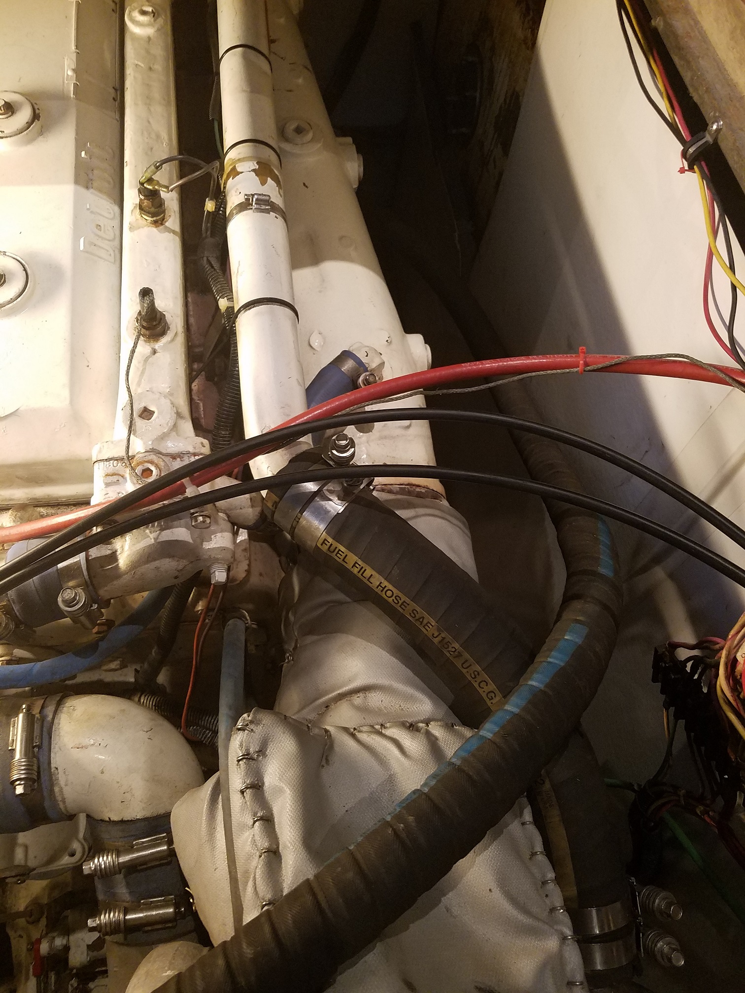

  8. Capt Ralph
    14,585
    20180605_194745 1.jpg Resized for Boomer

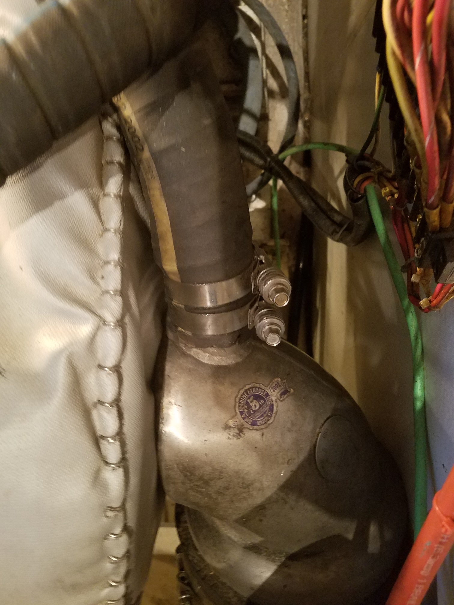

  9. Capt Ralph
    14,585
  10. Capt Ralph
    14,585
    I'm going to call this a 6-71 TI, not a 6-71 TIB.
    I also see it's vert tight back there remembering it's the stb main.
    Also MES from 2002?
  11. Capt Ralph
    14,585
    Under the heat shield (blanket wrap), keeping the riser tight to the turbo is a large V clamp.
    Pick up a new clamp.
    Remove this clamp, the water hose and loosed the 5" exhaust hose.
    The riser will fall away from the turbo. With a twisting motion, the riser should come out of the 5" hose.
    Big Screwdriver opening up the hose a lil bit and squirting wd40 in that opening between the can and hose should help.
    Raise the riser up. Have a Nerf football or small boat fender (anything 5" & round) ready to stuff in the hose should sea water want to splash in.
    Wear old gloves during this. The inside of the riser at the turbo may be covered in black slobber, the metal edges could be sharp.
    And there is wire in those hoses.
    Did you ever get a temp reading (under load) rite where the decal or MES stamp are located?
    Or even the 5" hose itself?
