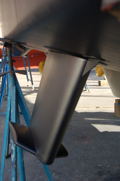

    I've had the pleasure of sea trialing both the 65 and 80 OR. They run well, have exceptional craftmanship on the interior and are stylish long range cruisers. Had the 80 out in 5+ seas and with the stabilizers on, gave a gentle roll, no snapping, no loss of control.
    Before the 65 trial, the yacht was on land and the hull style showed a fine running surface.
    Here's a shot of the 65 stabilizer.
