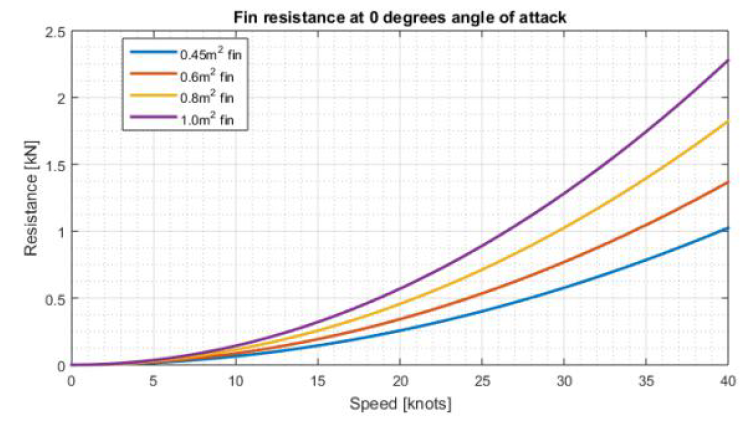

    1000 Wh = 1000W during 1 hour, depends how you read.
    Fins are not made for very fast boats (+30 knots) but they are used on normal planing boats.
    Information from Humphree:
