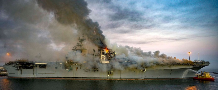

  11. Capt Ralph
    14,555
    USS Bonhomme Richard Fire – Was it Arson Or Widespread Safety Failures?
    by Megan Rose (ProPublica) On the morning of July 12, 2020, the first orange flickers of destruction took hold in the bowels of the hulking USS Bonhomme Richard as it sat moored at a San Diego naval base.
    Unimpeded, the fire gathered force, surging upward, conquering one level of the 844-foot ship and then the next, while the crew — the ship’s critical firefighting force — fled to the pier. There, the captain and his sailors stood by as the Bonhomme Richard burned, in cruel irony of its motto “I have not yet begun to fight.”
    Not until the San Diego fire department went aboard did anyone spray water on the fire — nearly two hours after it had started. By then it was too late. Gas cylinders were exploding and shooting through the air, and firefighters didn’t have a map or even a sailor to guide them through the smoky maze of the ship. A firefighter’s warning that a compartment was “about to blast” forced firefighters off the Bonhomme Richard just minutes before an explosion so powerful it was heard 13 miles away and hurled debris onto a nearby destroyer.
    That afternoon, the flames, hot enough to warp steel beams, danced along the flight deck and engulfed the ship’s outer structure. As the inferno raged, it melted the inside of the 300-ton control center on top of the ship, spewing molten aluminum onto the decks below.
    Before nightfall, the Bonhomme Richard was a salvage heap. Sailors later watched as the forward mast, where the American flag flies while the ship is at sea, collapsed.
    Four days later, when the fire was officially out, the U.S. Navy faced the sickening loss of a $1.2 billion warship, not to war, or even at sea. But to a wholly preventable fire while moored in a stateside port. For the Navy, whose reputation as the world’s finest had been battered by recent collisions at sea and allegations of shoddy equipment and training, the loss of the Bonhomme Richard was an embarrassing — and painfully public — blow.
    The service immediately launched two parallel investigations into what went wrong and why.
    The command investigation, led by a three-star admiral, sent a team of investigators on a prodigious and methodical examination of the fire. As the months passed, the investigators uncovered in exhaustive detail an astonishing array of failures — broken or missing fire hoses, poorly trained sailors, improperly stored hazardous material — that had primed the ship for a calamitous fire.
    A separate investigation by the Naval Criminal Investigative Service, for its part, focused on whether anyone was criminally responsible. As the months passed, NCIS investigators appeared to operate in isolation, discounting the damning findings of the command investigation to pursue a case of arson, despite scant evidence.
    Six weeks into both inquiries, the Navy told the command investigation to accept at face value what NCIS and federal fire investigators judged to be the fire’s origin. Both investigations concluded in 2021.
    The command investigation traced the problems back to when the Bonhomme Richard docked for maintenance and Navy leaders throughout the ranks abandoned responsibility for the ship’s safety. Risks mounted, and nobody paid attention. All told, investigators determined that the actions of 17 sailors and officers directly led to the loss of the ship, and those of 17 more, including five admirals, contributed. The long list was a staggering indictment of everyone from sailors to top admirals who had failed in their jobs.
    The NCIS investigation, however, laid the blame at the feet of a single young sailor. The true culprit, the one who bore responsibility for the billion-dollar loss, the Navy said, was then-20-year-old Ryan Mays. And for that, he should face life in prison.
    The Navy continued its pursuit of Mays, even as a military judge recommended against it, bluntly calling out the lack of evidence and citing the findings of the Navy’s own command investigation.
    Starting this week, Mays is being court-martialed in a military trial in San Diego for aggravated arson and willfully hazarding a vessel.
  12. Capt Ralph
    14,555
    A Navy spokesperson said the service couldn’t comment on ongoing litigation, but noted that the admiral who ordered the court-martial carefully reviewed the recommendation before deciding to move forward. “Everyone is entitled to a fair trial and the Navy is committed to upholding that principle,” Cmdr. Sean Robertson said.
    In court, the Navy has tried to stymie questions about its motivations — and even to quash evidence its own officers gathered about dangerous conditions aboard the Bonhomme Richard. Last month, the prosecutor, Capt. Jason Jones, asked the judge to forbid Mays’ counsel from presenting the conclusions of the command investigation. Mays, who now holds the lowest military rank of E1, should not be able to ask the court to view him as the fall guy, Jones said.
    The Navy wasn’t the problem, Jones said in court, and the trial argument shouldn’t in any way imply that “the Navy needs a scapegoat and therefore we picked an E1.”
    On Naval Base San Diego’s Pier 2, investigators cordoned off the charred wreckage of the Bonhomme Richard with yellow police tape.
    Within days of the fire being extinguished, Bureau of Alcohol, Tobacco, Firearms and Explosives investigators, who co-led the criminal inquiry with NCIS, stepped into the watery shell of the ship, looking for what ignited the blaze.
    Because the amphibious assault ship had been “in the yards” at the time of the fire, its flight deck, which stretched longer than two football fields, had been empty of the helicopters and F-35 fighter jets it was designed to carry. One of eight such ships in the Navy, the Bonhomme Richard is like a small aircraft carrier, made to ferry thousands of Marines into combat. It had been out of commission for a year and half during a $249 million overhaul. The morning of the fire, the upgrade was nearly complete.
    The agents determined that the fire had started in an area of the ship known as the “lower V,” which normally stowed dozens of Marine Corps tanks and other vehicles, but during the overhaul was being used as a catchall, according to testimony and reports. On the day of the fire, the lower V had been packed with two fueled forklifts, a man lift, pallets of hand sanitizer, lithium batteries and other combustibles, wood beams, scaffolding, rope and thick, tall cardboard crates, some stacked two high.
    A warship is an unusual scene for ATF investigators. They turned to the ship’s damage control assistant, Lt. Cmdr. Felix Perez, for a tour. Perez was the officer directly in charge of the firefighting hoses and systems aboard the ships, training sailors to fight fires and ensuring the ship followed fire prevention precautions.
    Perez guided the agents through the ship, stopping at the fire stations closest to where the fire began. At three, hoses were missing, cut or otherwise unusable. Perez told the agents he or his staff had walked the ship two days before the fire, and it was nearly impossible they had overlooked the fire stations, according to an NCIS affidavit about the case.
    The stations, Perez told the agents, must have been tampered with.
    A few weeks later, in a building catty-corner from the Bonhomme Richard, some 77 naval officers, enlisted experts and civilians set up shop for the command investigation.
    Early on, investigators realized Perez had not done his job well, according to a person close to the investigation who spoke to ProPublica on the condition their name wouldn’t be used so they could speak freely about sensitive matters. The fire stations were inoperable from broad neglect — and Perez and other leaders had failed to recognize the disintegration of the ship’s condition.
    From the start of the command investigation, NCIS immediately curtailed the team’s efforts, forbidding its experts and officers from interviewing anybody from the ship, command investigators wrote in their report. Backed by Navy policy, NCIS’ criminal inquiry took precedence over the systemic investigation. So the command investigators turned instead to 26,000 pages of records, downloading databases and piecing together logs of the ship’s equipment, maintenance and training.
    The investigators soon discovered an astonishing list of ways the ship was at risk, so many that cataloging the bad decisions day after day became depressing, the person involved said. For long stretches, all the ship’s heat sensors, sprinklers and other emergency systems were turned off, investigators wrote in their report. On the day of the fire, just 29 of the ship’s 216 fire stations and 15 of 807 portable fire extinguishers were in standard working order.

    The Navy was at risk for mishandling even a minor fire, investigators found.
    A year after the fire, as top Navy leadership was endorsing the command investigation findings, the service was also charging Mays.
    To some, the Navy’s actions were reminiscent of an ugly piece of its history. In 1989 an explosion on a turret of the USS Iowa killed 47 sailors, and the Navy tried to pin it on one of the dead sailors, who leaders suspected was gay. Only after Congress stepped in did the Navy acknowledge there was no evidence for its assertions.
    More recently, after back-to-back collisions in the Pacific in 2017, ProPublica exposed how the Navy downplayed systemic culpability and fired those who had raised alarms.
    After a dayslong probable cause hearing for Mays in December 2021, the judge said she wasn’t persuaded of Mays’ guilt. A nuclear-trained surface warfare officer who later became a Navy lawyer and then judge, Capt. Angela Tang is known for being thorough.
    “Given the state of the evidence presented to me, I do not believe there is a reasonable likelihood of conviction at trial. Therefore I do not recommend referral of these charges even though there is probable cause to support them,” Tang wrote in her findings.
    ProPublica reviewed the conclusions of her 43-page report, which the Navy has withheld from the public, as it has with almost all other court records in the case. Probable cause is a low bar, Tang cautioned. In explaining her recommendation to drop the charges against Mays, she repeatedly refers to “if” the fire was arson.
    Her report also notes that defense expert witnesses testified about finding two other possible causes: lithium batteries that had leaked and exploded and arcing from an engine wire on a forklift. Given that evidence, the experts testified, the only reasonable conclusion was “undetermined.”
    None of the evidence proved the fire was deliberately set, Tang wrote, and ATF’s conclusion could be doubted because agents missed possible causes found by the defense in the four hours they had at the scene. Tang noted Velasco was the prosecution’s lone eyewitness and — even if believable — wasn’t enough to hang the case on. She wrote that Velasco’s credibility was undercut by how long he took to report seeing someone and by his inconsistent statements, as well as by other witnesses who contradicted what Velasco said Mays was wearing. Furthermore, even if Mays was seen, it did not prove he set the fire or that it was arson, she wrote.
    She also said investigators had valid reasons to suspect McGovern and wrote that jurors would probably view Mays’ “I’m guilty” remark as sarcastic.
    Tang referenced, too, the Navy’s own conclusions that if not for systemic failures, the fire would have been extinguished long before the ship was lost. The Navy charged Mays with hazarding a vessel, but Tang wrote the fire, if arson, seemed intended to cause a distraction, not destroy the ship.
