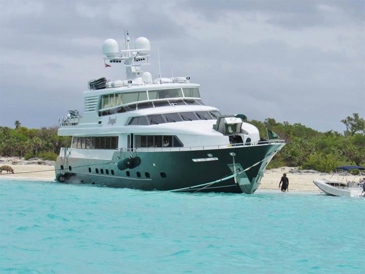

    132' Broward Motoryacht Serque on the Rocks...

    That's going to hurt the pocket book! Interesting yacht, with out a doubt the most heavily modified and re fit Broward out there.
    Owner would place a Captain and Chief engineer on the payroll seasonally? Ex stewardess manages the boat and hires the crew.
    Obvious poor anchor watch or mechanical malfunction to getting underway once the anchor dragged.

    It's a charter yacht too....makes it even a bit more intriguing. Very nice 2008 Broward. $99,000 per week. I'd think they probably lost money this week.

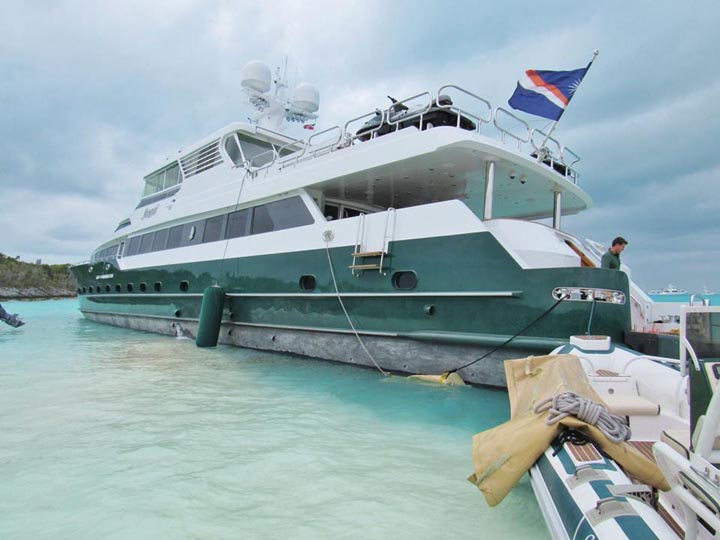

    Plus Broward was well known for under sizing the anchors and windlasses they put on their boat.
    I would expect that with all the work that was done to that boat they would have addressed those issues. But....
    And I hate that style of anchor. Never trust them unless they are way oversized. And even then I don't sleep well with them on duty.

    But based on the few facts known, on a boat this size, watch keepers or proper alarms should have prevented this from happening.

    All the listings for Broward's of that vintage and size from 1992 through 2000's the specs for ground tackle was on the light side calling for 231 lb. Pool anchors and 300' of 1/2 " chain. This particular Broward was built as hull 536 @ 117' in the Lauderdale yard in 1995 as "Independence" and had the same spec. Not to say that was what was on Serque 20 yrs. later as just about every system was touched and upgraded through the multiple refits. But I was certainly surprised at the skinny ground tackle per captbill11's post #4 that has proved to be the case through research.
