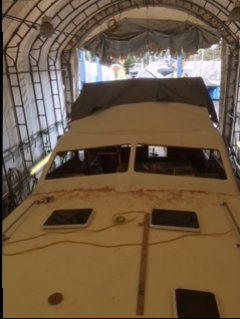

    Here is one of the front. We are putting the front windows back.

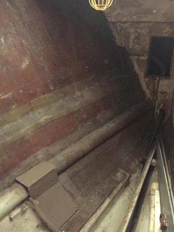

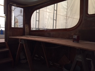

  3. Laurent91
    Laurent91 New Member
    May 6, 2018
    24
    Baltimore
    The inside has nothing left. Removing all materials, up to the fiberglass, we will also replace the side windows. image.jpeg

    some news on the Lace restoration, the windows are installed, the dashbord as well, the transom is in process, all the headliners have been removed, a customized T-Top has been bought but not installed yet. Going to start looking at the electrical wiring tomorrow...

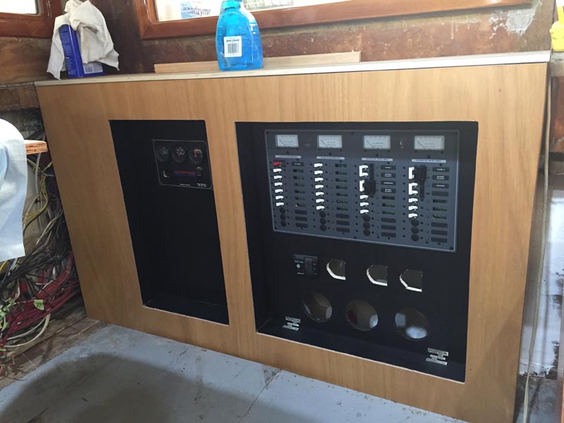

    Baltimore

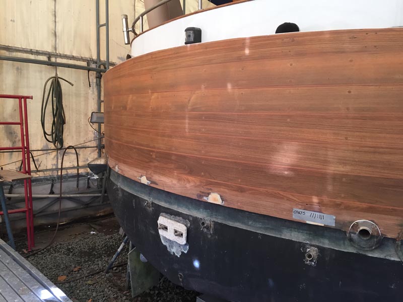

    The transom has been totally rebuilt and is now waiting warmer weather to paint the name and do the final coats. the marks you see is sun going through holes in the tarp… I'm looking to rebuild a new swim platform with SS structure and teck on top. If someone has ideas on the SS structure...
    The electrical cabinet is ready to be rewired and will be soon, all materials and equipments are brand new.
    The V-birth, as said, is totally stripped out and will be fiber glassed, epoxyed before rebuilding with new material while keeping the original doors. Also, will be totally rewired

    The project continues with all the plumbing done, all pipes and hoses replaced, hot water, cold water, vents, diesel... Tomorrow we'll replace all the AC hoses... 3 main tanks repainted (diesel and water)... Electrical rewiring will start this week, all new cables, nothing from former wiring left... What a work!!! Incredible what people can add over time but never remove the old cables...
