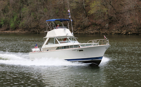

    I bought a 1966 Chris Craft ten years ago, and one cylinder didn't have any compression. After a good tuneup and proper setting of the solid lifters, the cylinder came up to spec and I've been running that boat for TEN YEARS with very good success. Just because the iron is old, doesn't mean it's not viable. There are some other circumstances, like being salt water cooled inside the blocks (without a heat exchanger) in which case it would be bad news.
