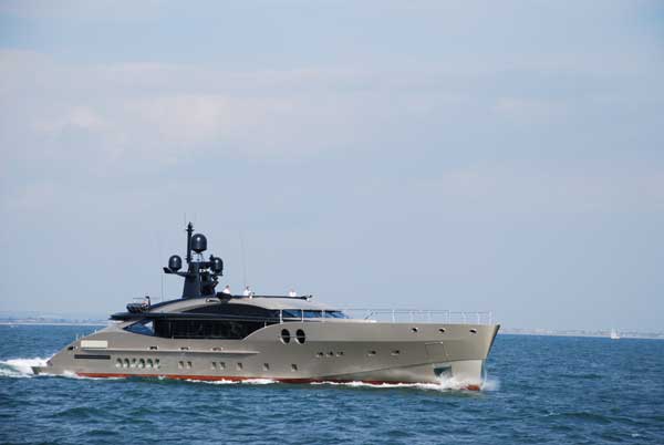

    To clear up some mis-understanding as to my design the statement of only being used on sport fish yachts is not really true . It is true we started in the sport fish market but have moved on to the large motor yacht market.
    Our first large yacht was the Broward 105' back in 2001 and our lastest is the new Palmer Johnson 171 . Our designs are also being desiged into the new Palmer Johnson 210' and the new Trinity TO-61 with the new MTU M-93L 20V4000 Series @ 5780 hp. The 171 Palmer Johnson yachts have the MTU 16V4000 M-93L @ 4600 hp .
    Over the years we have done a number of re-fits from 98 to 130'
    Hope this clears this miss-understanding up.

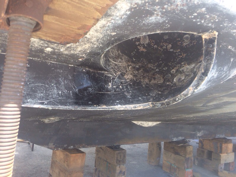

    We are refitting an antago 22.5 meters and need to upgrade the underwater exhaust because of vibration.
    Could you please send more pictures or info regarding this issue? Also if you have a lateral picture to see the shape.

    Some Lazzara's experience terrible cavitation getting on plane and vibration from the cavitation they put a 1" thick lip around the underwater exhaust to direct it away from the props and it helps considerably.

    Correct. On the 84 I run now, you have to accelerate gradually to avoid th exhaust being sucked in an causing cavitation. Boat has the bigger C32 and will be on plane at 1500 in a very short time but if you are heavy handed the cavitation will be horrendous.
    During sea trial, the management company "rent a capt." Was one of those heavy handed sport fish jock who just pushed the throttles forward. Had to back off and then be told to try it again slowly. It's kind of like stepping hard on th gas of powerful car with traction control off. You ll just spin the tires.
    I was told by people familiar with the design and who work at the factory that They tweaked the design adding a fence and a lip to divert the exhaust. It's hard to see in th pic but the fence is about 4" tall and extends aft about 4' or so
