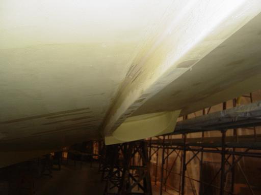

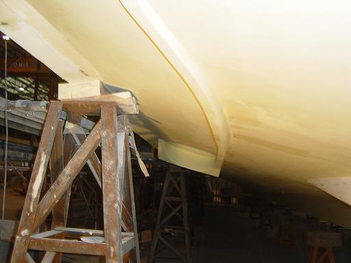

    Another critical issue that somebody has to bear in mind while designing the deflectors is that their height in any given part of its structure should not interfere with the imaginary line from the Keel to Yacht's side.

    Deflectors have other names such as as cowlings, clamshells, and eductors. There are as many different designs as there are boat builders. Some builders turn the exhaust to the outboard side to avoid getting the exhaust into the props. I have seen some that are no more than a 3” lip around the exhaust penetration.
    The ultimate purpose as is mentioned earlier on in this thread, is to reduce the backpressure and get the exhaust out the bottom of the boat. There are other factors that need to be considered. Is the diameter of the penetration, correct to the gas flow of the engine? Is the bypass properly sized? How deep is the penetration with respect to the loaded waterline? What is the vessel’s cruising speed?
    Garry’s drawing is similar the basic design of what we would recommend if we were asked to include this as part of the design and fabrication of the exhaust system. Looking forward to additional feedback from others.

    comship, I believe you mentioned that all this jiggery-pokery beneath the hull would not add any drag.
    From your photos, that long deflector would appear to be adding a not insubstantial amount of wetted surface which does add drag to a hull.

    Comship- Do the exhausts come directly out the bottom of your boat or are they led to the aft edge of hull and transom?
    Any chance of a photo of your yacht from the side showing where these pipes come out in your case?

  11. comship
    comship Senior Member
    Jan 27, 2007
    174
    Greece
    In one of the above posted photos (the one where the deflector has been just laminated) you will see that they do not led to the transom

    Your system is actually nothing like the system shown on the Von Widmann design Website. The fact that you used this guy as an example of what you had and the photos were so different to his site drawings had me and I am sure a number of other people totally confused.
    I have not personally seen anything remotely like what you have there. I would be interested to know how they actually work when you get your boat up and running.
