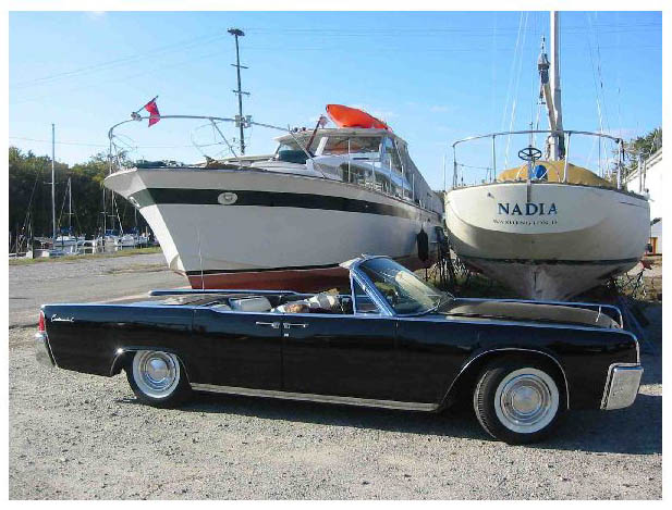

    Well, they are torquey.
    And smooth running (Lincoln once wanted to build the American Rolls Royce).
    Had one in my '61 Continental once (see photo).
    Parts continue to remain available (especially from antique Lincoln parts suppliers) - but are becoming increasingly expensive (ask any 427 motor owner what's that like).
    They do not run up as high as 454s or 440s in terms of rpms. You have to get your thrust from the bigger props 430s can twist.
    Frankly, unless it's a totally original classic you want - try something more modern.
