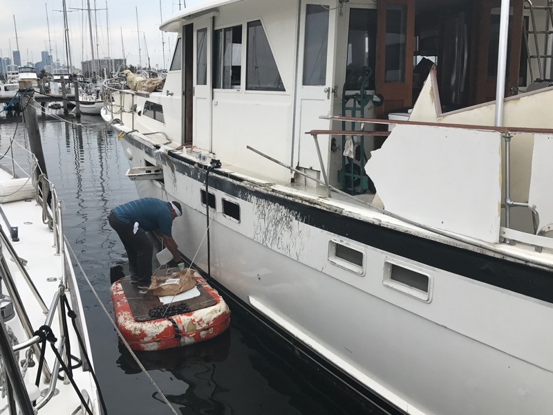

  16. Pascal
    8,166
    Unfortunately it s not vague comments but plenty of cases. Yes, properly installed alum tanks will last a long time but we all know builders take shortcuts
    As to hurricane damage, obviously any boat will take a beating and eventually sustain damage but anyone involved with boats in hurricane country knows damage varies greatly depending on construction. Lighter built hulls will quickly crack when banging against a piling or any other boats. I ve seen it dozens of time in the wake of Irma, Wilma, Katrina and others. Stronger hulls will rub and glass will be ground away but the laminate will not burst.
    During Irma last year, my boat took out a piling on the port side and the cap rail ended up being ground up open over about 15’. three portholes (bronze) were pushed in and found on the floor. Aft ER bulkhead was loose and also ground away from the rubbing against the hull.
    From inside I could push the unsupported hull side in and out. But guess what? The hull didn’t fail, didn’t crack and didn’t get a single stress crack.
    I ve seen neighbors boats being pulled out of the water in the weeks following, Sea rays, Chris crafts, Silvertons etc. Every time the hull failed, there were no evidence of repeated grinding before failure.
    Now in all fairness, these being extreme circumstances means it s not very relevant to the decision process as you re not going to pick a boat based on hurricane survival years down the line. But contrarily to what you suggested there is a difference in hurricane damage
