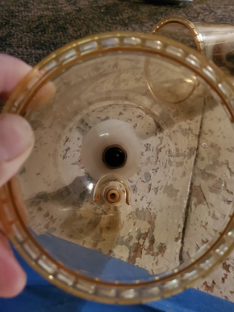

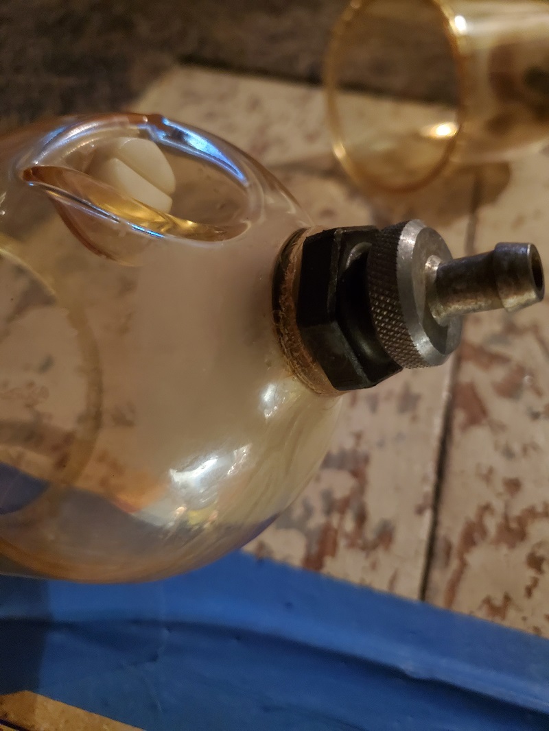

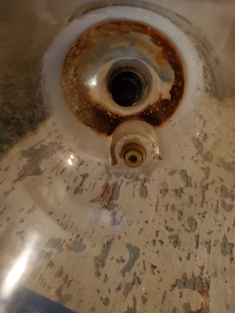

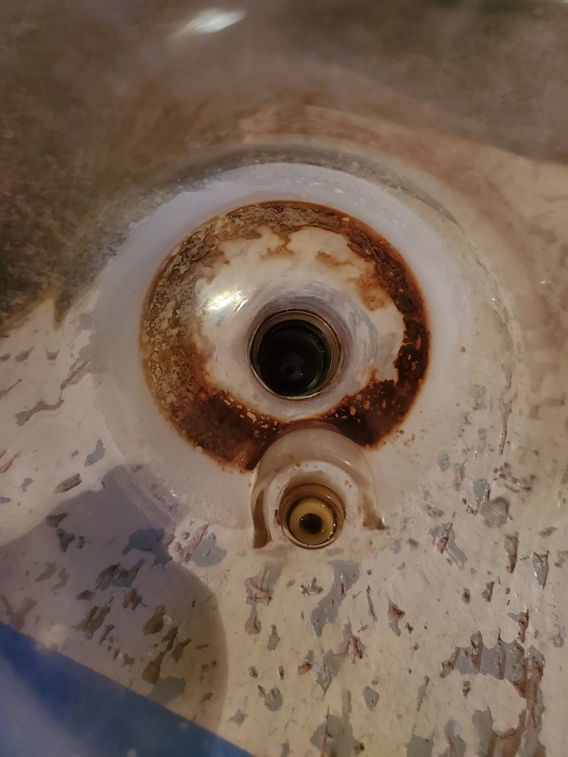

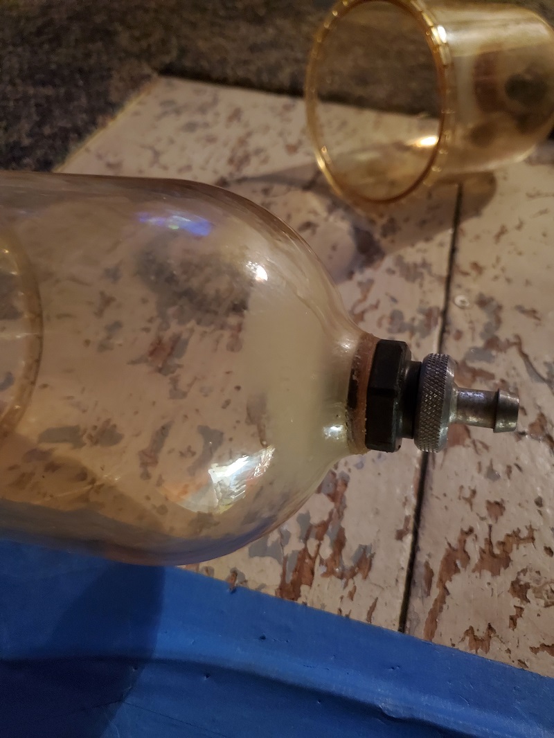

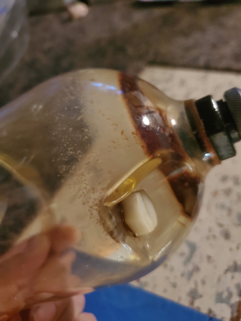

    Realizing a Racor check ball issue recently, I went to install the RK-11028B kit last night and finished tonight. In removing the filter bowls for the port engine that draws from the forward tank, all was great. Some sh*t but all cleaned up nicely and quickly put together and tested well.
    This evening I went for the stb engines Racors. These filters normally draw from the aft tank. The fuel tank that had all those snot problems and the only tank any treatment was added to. First, I discovered the check valve plastic washers were missing. After clearing the bowls of a matching blob of sh*t as the port filters (no snot), it appears a reaction to the plastic has happened where water would normally settle in the bowls bottom. All 4 bowls were new 5 years ago.
    I am convinced the fuel treatment dissolved the check ball washers and ate into the Racor plastic bowls.
    I shudder to think what else could of been damaged.
    Keep in mind, both Racors are usually open. They are at an angle and more at angle with bow up. The bowl with the red fuel dye melted into the plastic was the lower of the two bowls.

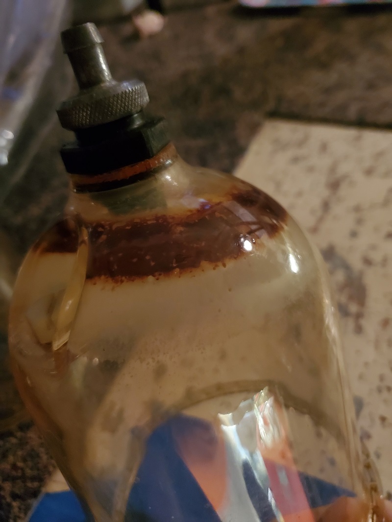

  17. Capt Ralph
    14,585
    You can see my sorry paint chipped deck thru the bowls well except where they were chemical burned by the fuel snake oil.
    Why I bring this up; A reinforcement of my comments on those other fuel additive threads, If it's not broke, don't ad any snake oils.
