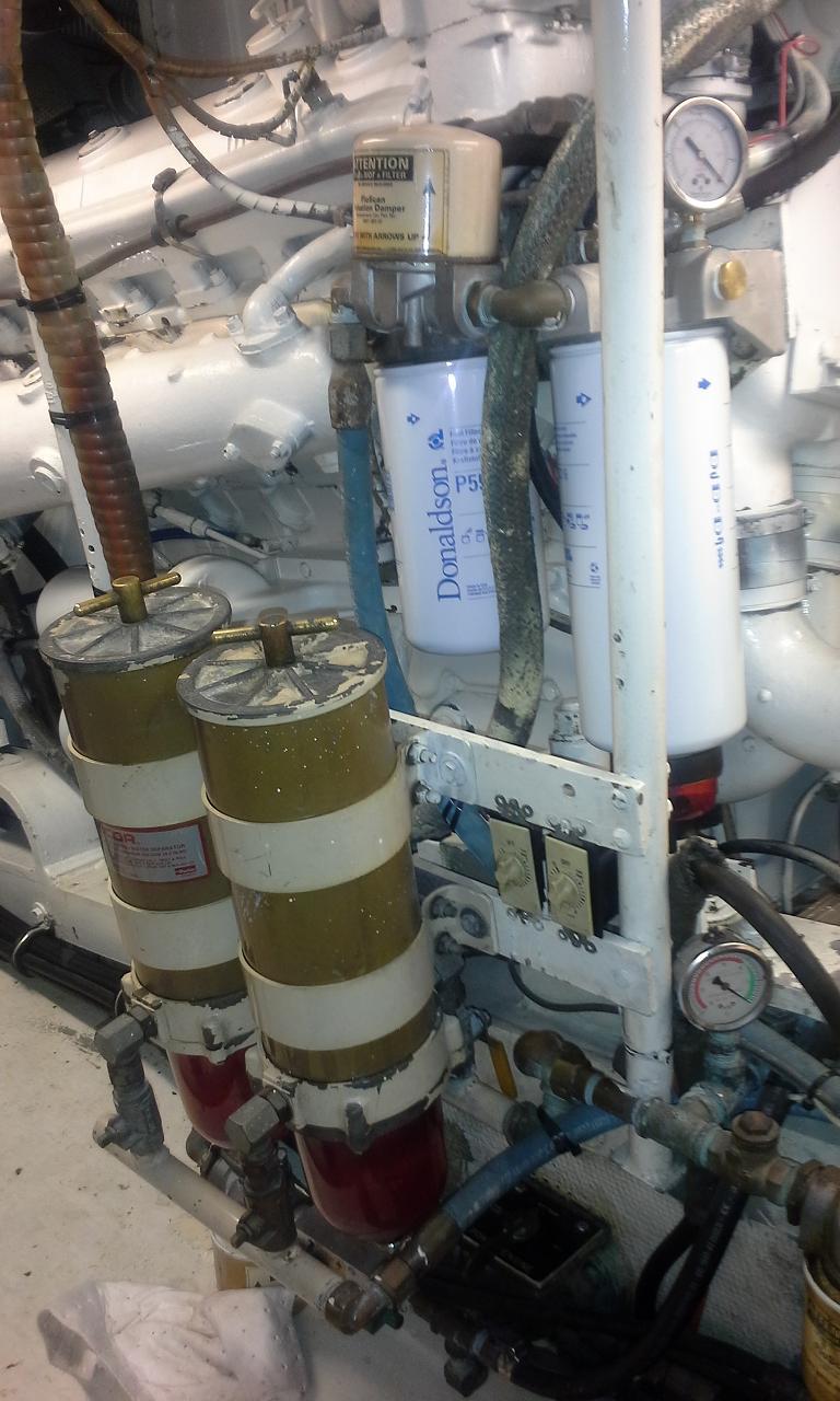

    The original GM primary fuel filter cartridge system was replaced with a Donaldson spin-on with plastic water bowel. Fuel system is now; Dual Racor mud filters 1000s @ 30mic, spin-on primary with water bowel @ 16mic, spin-on secondary/final somewhere between 5 & 10 mic. Trials last Thursday night found some water in the Racors, new secondary bowl had water also.

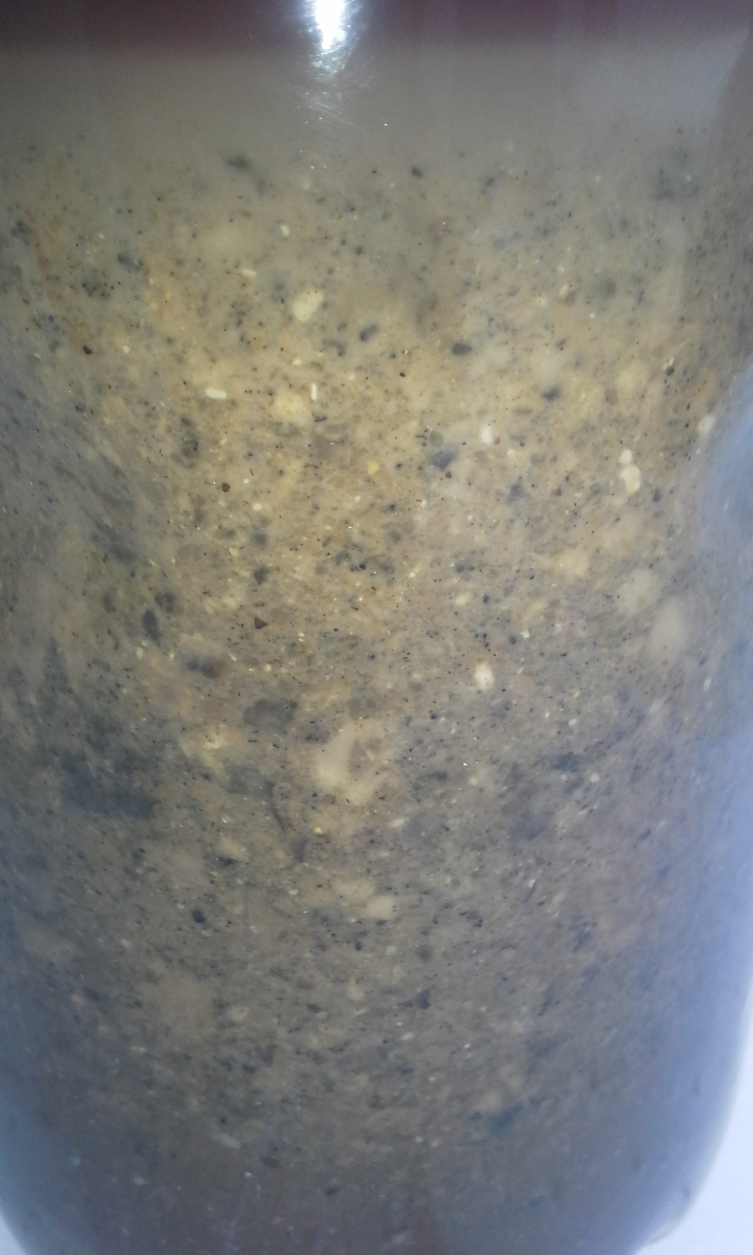

    I built my own fuel filter assembly and tried again to reach the water with a copper tube wand. I was able to reach around some of the corner openings in the baffle but all I got was dissolved snot and dirt (more dirt than the $400 fuel polish gut got 2 years ago).

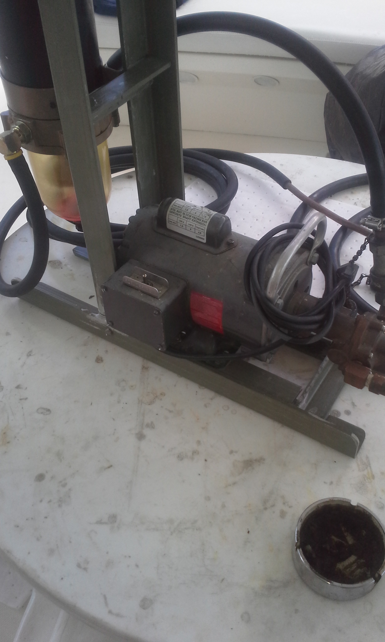

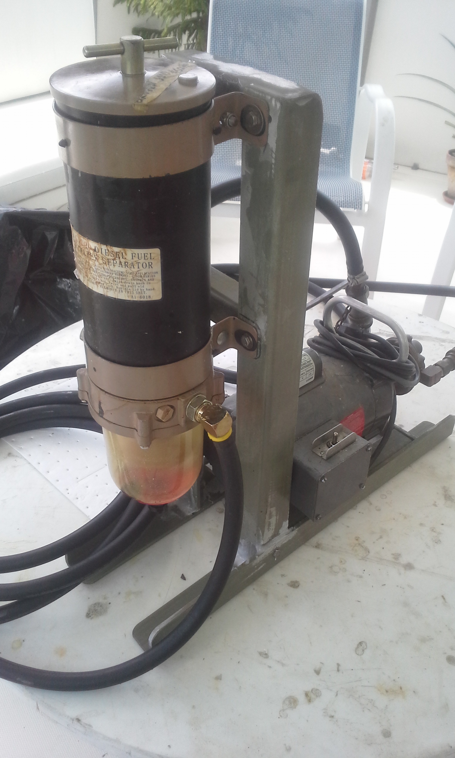

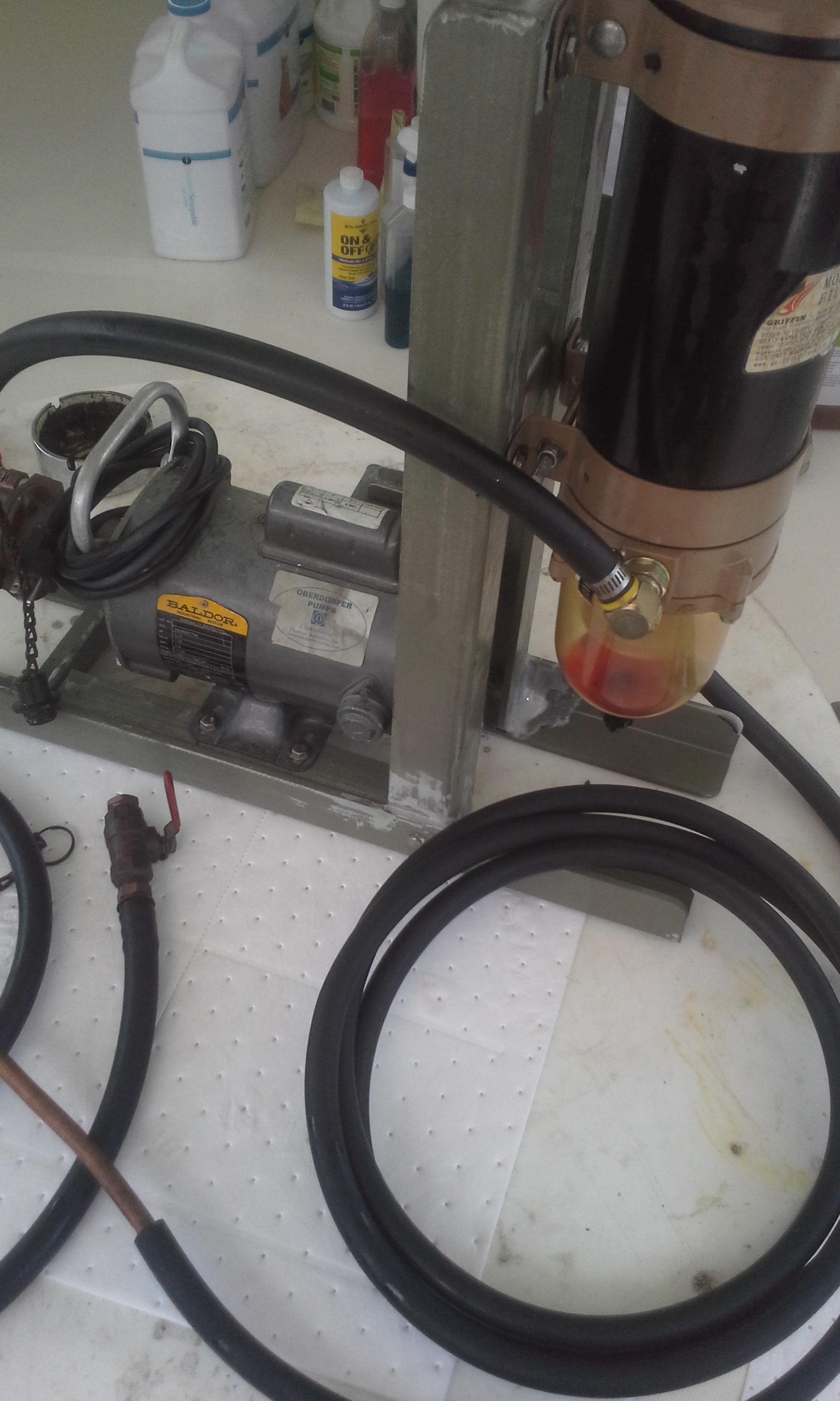

    20150525_122649.jpg 20150525_122700.jpg 20150525_122948.jpg 20150525_123001.jpg 20150525_122712.jpg
    For rent in the Jax area.

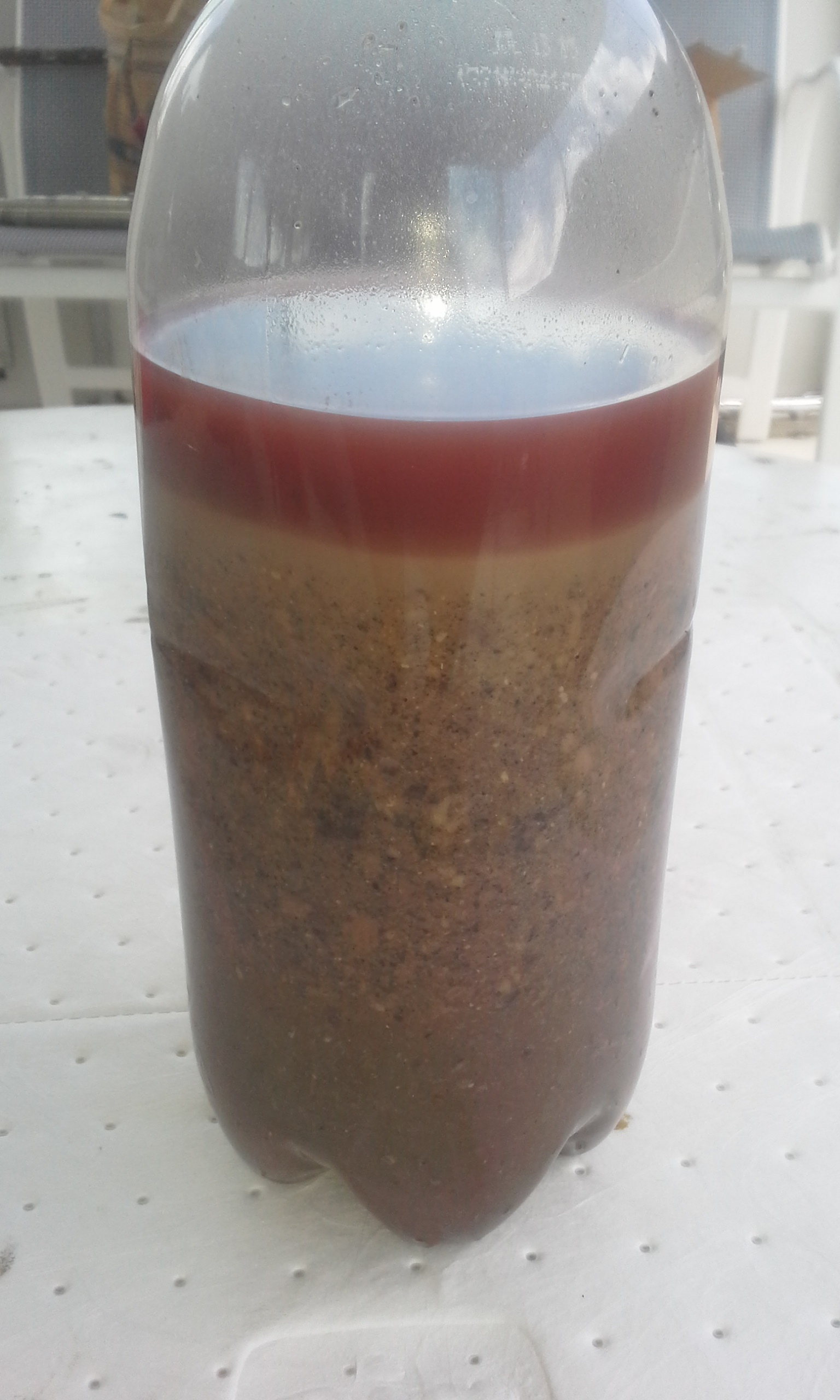

    More;

    Never knowing how much water was in the tank, I could just assume lots by the quickness the water was filling the Racor bowels.
    During lunch today, we did pick up the ships bow in the slings a lil beyond running angle, just picked up a couple of drops after an hour. Pretty depressed that my idea was not working, the bow was lifted a good bit more. 30 minutes later picked up just a fat pint & a half of water. Running the pumps, not a drop more while slowly dropping the bow back down.
    Near panic, that not that much water was picked up, we resolved to go back in the river and tag-team the dual Racor filters.
    Well,, never got another drop.
    Not knowing, it seems we already got most of the water out already.
