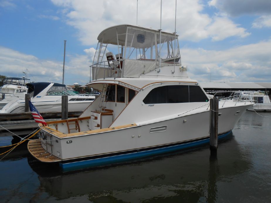

    I have been in the market for a 40ish sportfisher for several months, focusing on Bertram, Hatters, and Vikings. I have always LOVED the POST's, was docked next to a 42 for several years. I was extremely reluctant to include them in my search as it seemed everyone had rot. Well, that has changed. I came across an '82 42 that appears to have very little if any fishing time on it and after initial inspection looks like is deserving of a survey. She has 6-71's with a "reported" 1500 original hours. Would love to get some input from those that have personal experience with these beauties, share the good and the bad, where I should focus my attention during my next viewing and the survey.
    PS: Surveyor recommendations needed for the Annapolis Maryland area

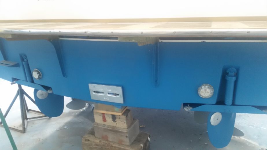

  4. Capt J
    14,435
    The 42' and 46' Posts have one hell of a scary ride in a following sea. I wouldn't even consider them personally. I'd try to go to a Cabo if you can.

  7. Capt J
    14,435
    Cabo's have no issues in following seas, the rudders on them are plenty big enough actually in all conditions. Heck the 40' express you can do a 360 at 30 knots in less than 3 boat lengths. You get exactly what you pay for. Used Cabo's are getting down in price as they get older such as the 45' Express. There's one for sale for $175k and the boat is a 1998. Several others can be had for the low $200s. They also don't "ROT" ANYWHERE!!!!!
    They're a much better sea boat than an old 42/46 Post as well as all of the other 80's hull designs. Then again I've run sportfish from most all of the builders and many different sizes from each builder. I run around 150 different yachts a year. So if anyone can compare how each SF ride, I can.
    That being said, perhaps you should take a look at the "pissant rudders" on Post 42 and 46's. Both of those boats are a downright handful in a following sea and after you've ridden down sea on the hull side, and feel like you're not coming back till it all of a sudden flops back over, responds to rudder, and makes a 45-60 degree turn, come back and talk to me. There's even a thread here about the "updated larger rudders" for them. The 50' Post on the other hand is a totally different animal, it's a pretty good sea boat, stable on the troll, and only a touch on the wet side and a very good buy for the money. I call a spade a spade. The Viking 45's were a pretty good boat. The old 41's and 48's I'd take over a post 42/46.

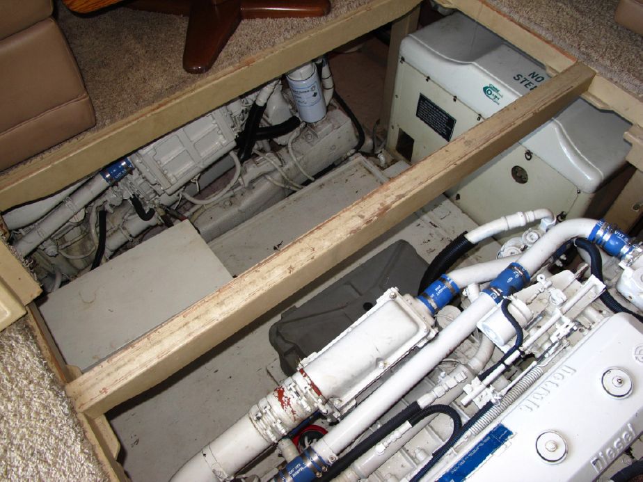

    - Engine are not electronic and I can do much of the maintenance and repairs myself. Mostly maintenance and few repairs.
    - reliable engine and easy to access primary parts as the engines are mirrored in the bilge.
    - I am a 6' , 250 lb guy that can get to the outboard side of both engines AND turn around ( this requires much grunting )

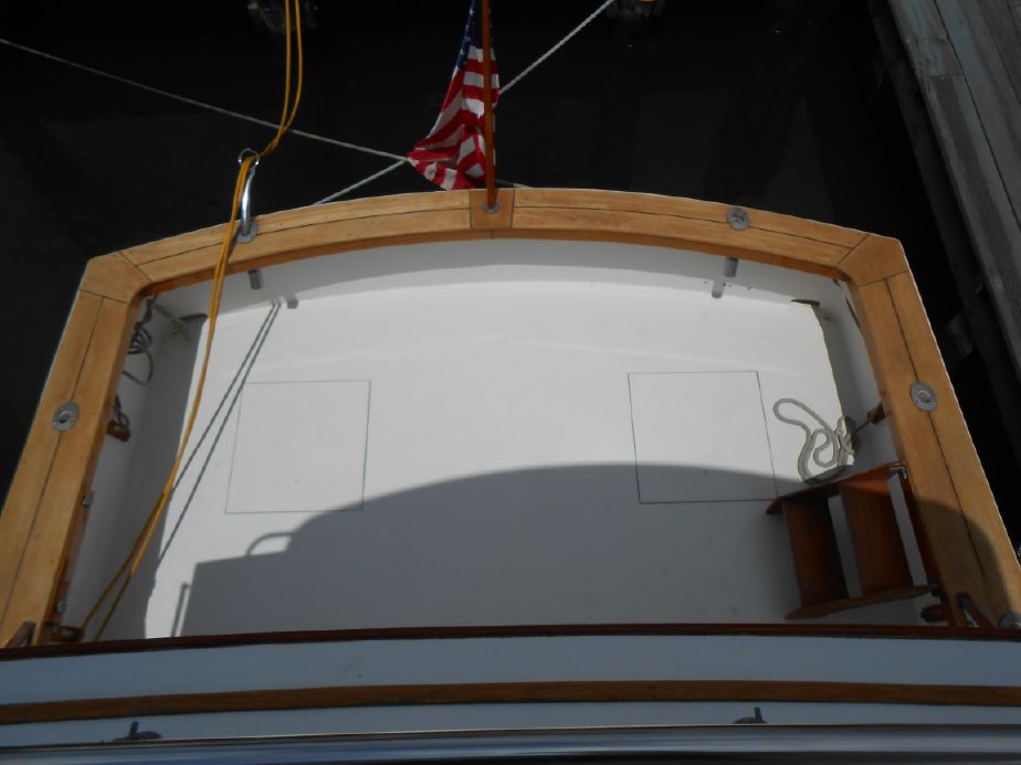

    - there is the potential for bad coring around all the wood trim on the house. Also around the stanchions.

    - I have seen a few in yards having the catwalks redone because f delamination. Not so much rot but separation issues.

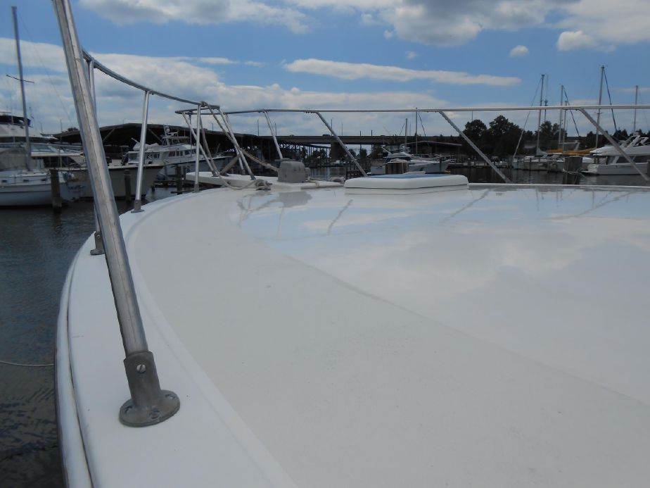

    Thank you Chesepeake46. I will continue to add what I know after my initial inspection
    The vessel owner maintains a marina in Kent Island, appears to have maintained the vessel nicely. I did note the foredeck has already had some repair around the pulpit, does not present as wet or soft. Inspection of bow rail and helm seat stanchions present solid, as did the aft bridge overhang. There were no other breeches in the foredeck allowing water intrusion so I don't suspect any issues there. No chair or leaning post in the cockpit so no means of intrusion there. I am a realistic vintage vessel buyer understanding there is likely some moisture somewhere, the vessel is 30 years old, and it lives in semi-salt environment

    I just came back from Bonaire 3 weeks ago, with a 6ft following sea, and yes, she wants to throw her stern sideways, but it all depends on your speed. If you maintain the right speed, it's not scary at all, and you get used to it. I used my brand new autopilot on both ways all the time, and we had a pretty comfortable ride, but I need to mention, we are used to these sea conditions and never have a flat sea at all!!
