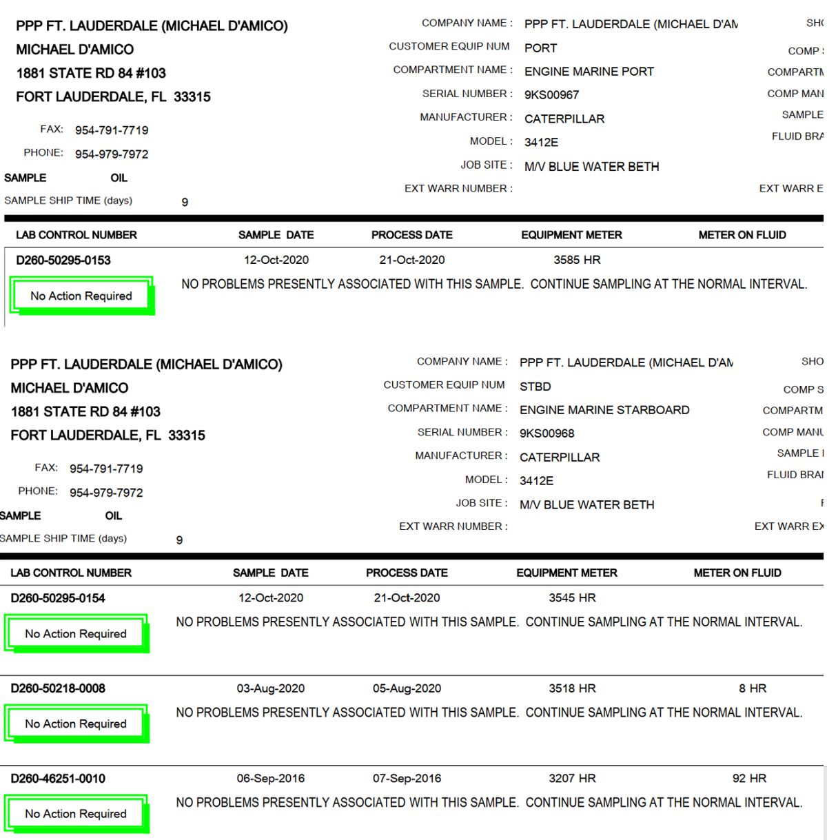

  13. TahoeJohn
    TahoeJohn Member
    Aug 8, 2020
    155
    Tahoe VIsta
    We (finally) received the oil analysis results. Both main engines are fine with oil; the only thing that was noted was high iron in the coolant with a flush on both sides recommended.
