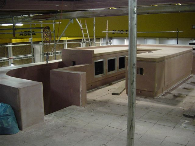

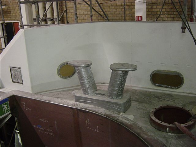

    Looking aft from the overhang of the covered skylounge aft-deck, this is the exterior starboard bar. Refreshments will follow in a few months...
    20,951
    Way up high and nearly bumping against the shed rafters, this is the starboard side of the sundeck...

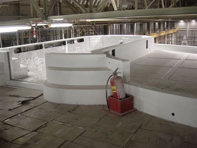

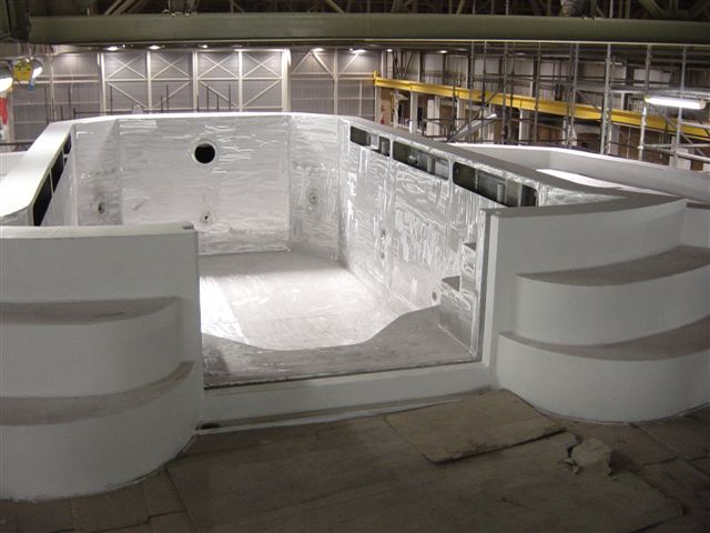

    Continuing forward on the sundeck, this is the pool with a sunlounge area flanking the starboard side...
  5. YachtForums
    20,951
    A closer look at the pool reveals splash wells and a cut-out for the pool light...

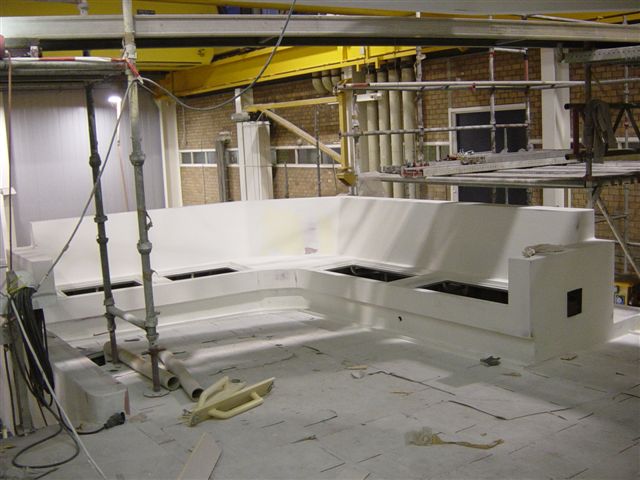

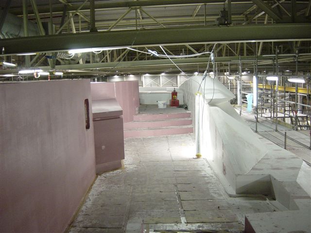

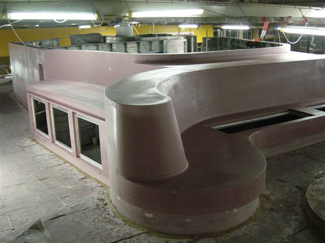

    Just aft of the pool and facing forward, a settee has been integrated into the foundation of Y701's main arch. Space is utilized to the fullest, with cabinets and storage wells integrated whenever possible.

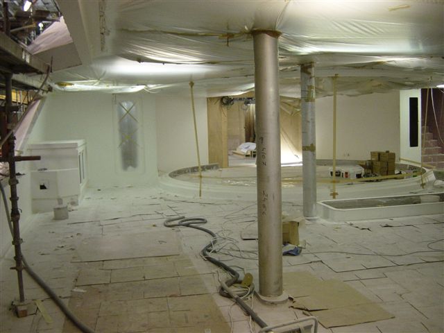

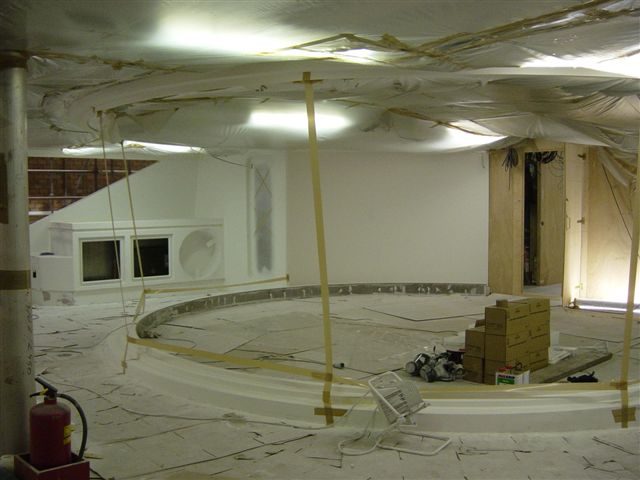

    Just forward on the upper aft-deck is the foundation of the dining area, which will feature circular glass sliders for formal dining when closed or al-fresco when open...

    A closer inspection shows masking and paint has already commenced in and around the dining area...

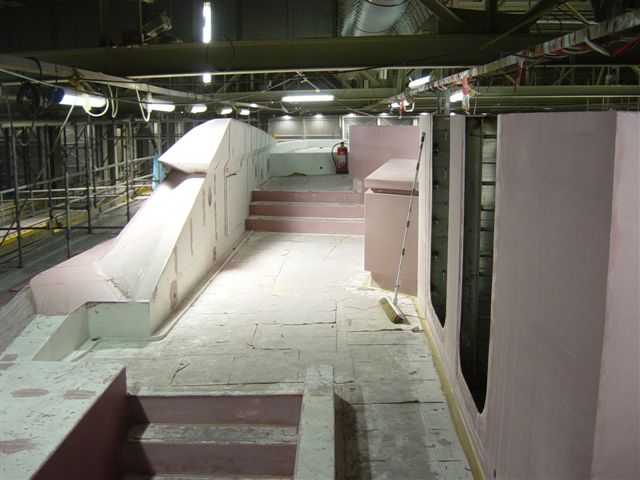

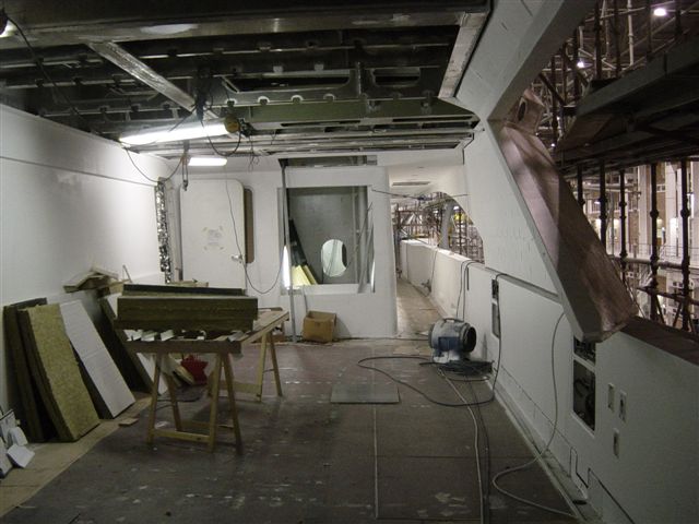

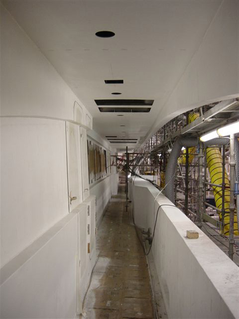

    Continuing forward, this is the starboard side walkway along the main deck. Notice the cardboard flooring EVERYWHERE, to protect the decks during construction. To grant future access, Oceanco has integrated panels throughout the ship, such as walkway cieling panels shown here....
  13. YachtForums
    20,951

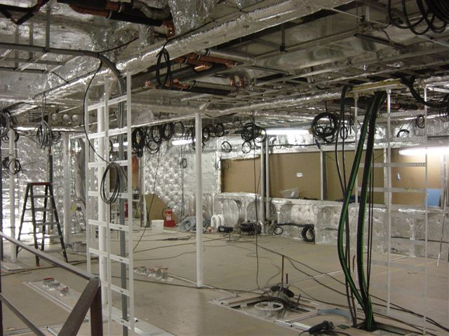

    Some details...
    In every wall, every floor and unseen nook & cranny's... there are miles of wiring and plumbing hiding behind decorative panels, marble flooring and overhead valences. Much of this is taken for granted by the uneducated, naked eye. Often a boat is judged on aesthetic appeal, when in fact, it should be appreciated for the artwork and engineering underlying the more visible items.

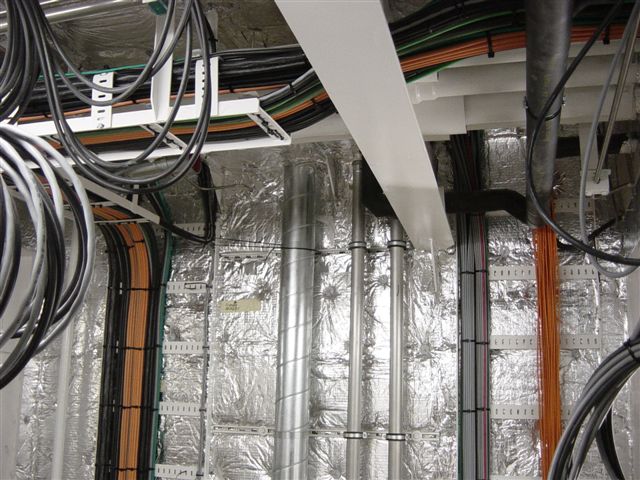

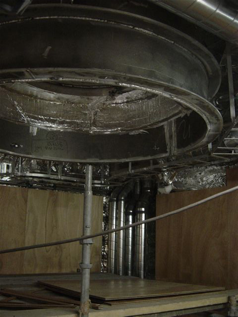

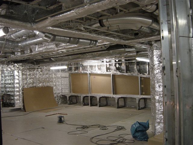

    The following pictures are in random order, but show many of the engineering internals. This picture reveals some of the heating, cooling and ventilation ducts...

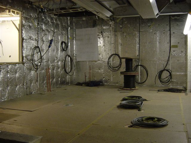

    20,951

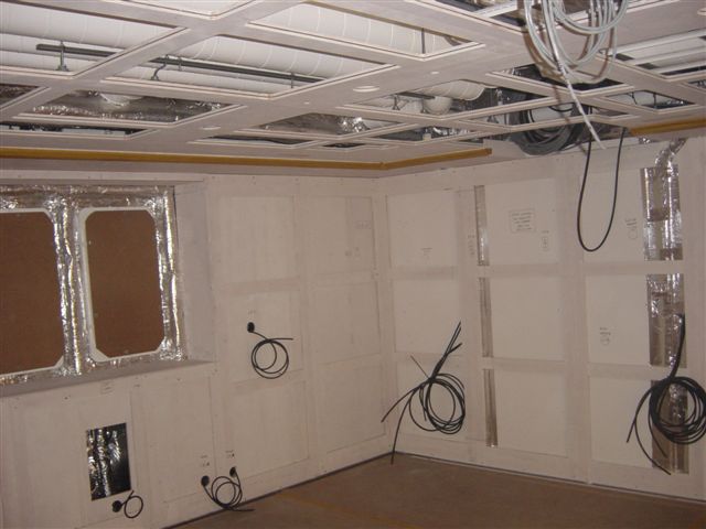

    It's difficult to predict the exact length of wiring that will be needed to reach its final destination as it passes thru and around structural components, thus rolls of wire hang as decorative ornaments during the construction phases.
  20. YachtForums

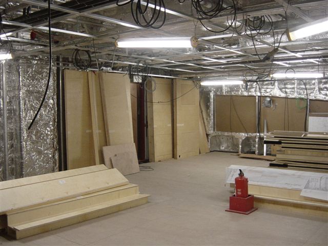

    20,951

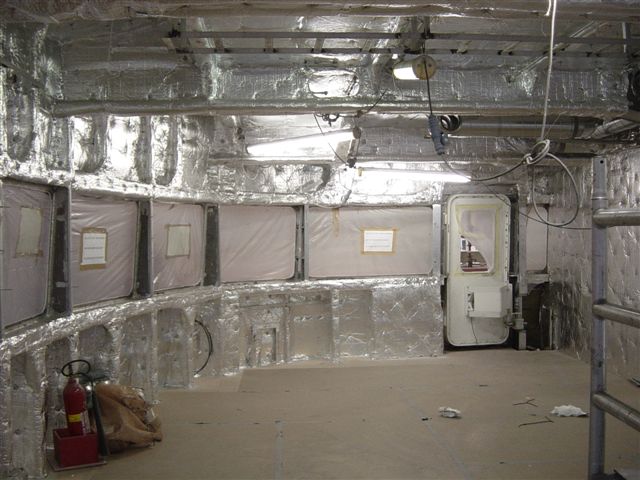

    Insulation for this room (believed to the observation lounge) is complete. It's hard to believe all the work that is involved... just to reach a stage where interior build-out can begin.
