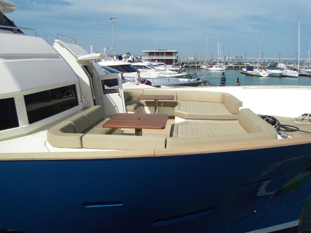

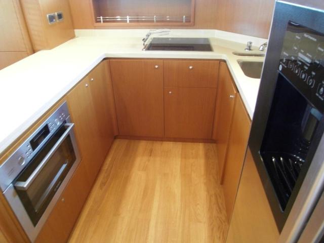

    Mochi 75 LR

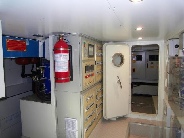

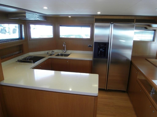

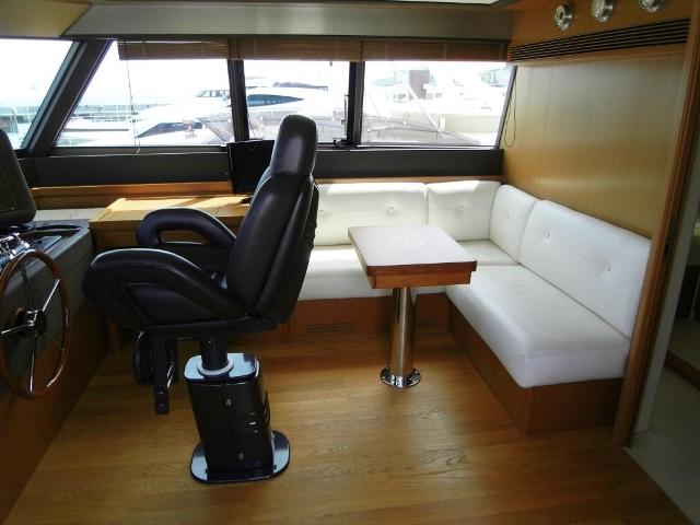

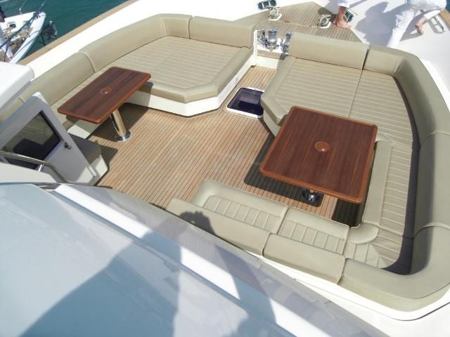

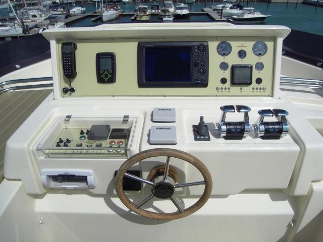

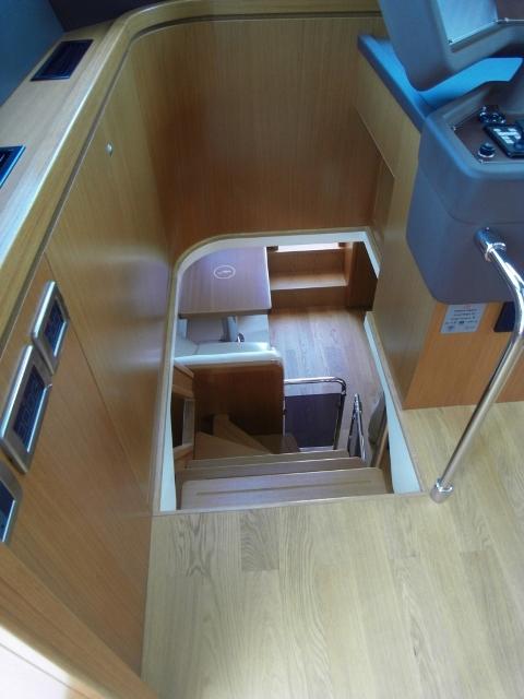

    My son and I did an extensive sea trial on the Mochi 75LR a few years ago. We were both fascinated by the hybrid power train and the predicted performance data.
    Once you get along with the unusual exterior design and entering the boat, you will find a beautifull designed high quality interior with exquisite materials and an interesting but practical interior layout. The interior was love on first site for us.
    We saw both the 3 cabin and 4 cabin layout with and without the optional captains cabin behind the wheelhouse. We found the 3 cabin layout as an owner operated boat without crew cabins for 4 adults and 2 kids, the most practicable one. The "crew cabin" and the captains cabin, we concidered, sorry to say, beneath human dignity, btw very common for Italian yachts of this size.
    I would have taken the removable forward sun bed area completely away and locate a strong hydraulic davit on the foredeck with the support pole below deck in front of the crash bulkhead. The foredeck could easily host two nice tender. The sun beds are useless during bluewater cruising anyhow, as this area is very wet, when the 75LR hits the waves. There is enough sun bathing area on the aft upper deck and the flybridge.
    I especially did like the open galley with the adjacent dinette and the salon dining table.
    Below some pictures from our visit

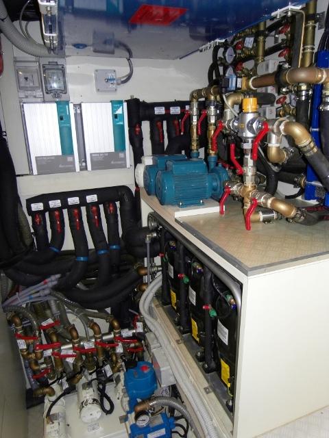

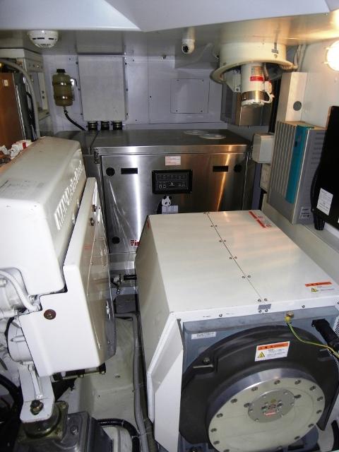

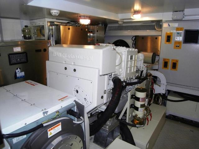

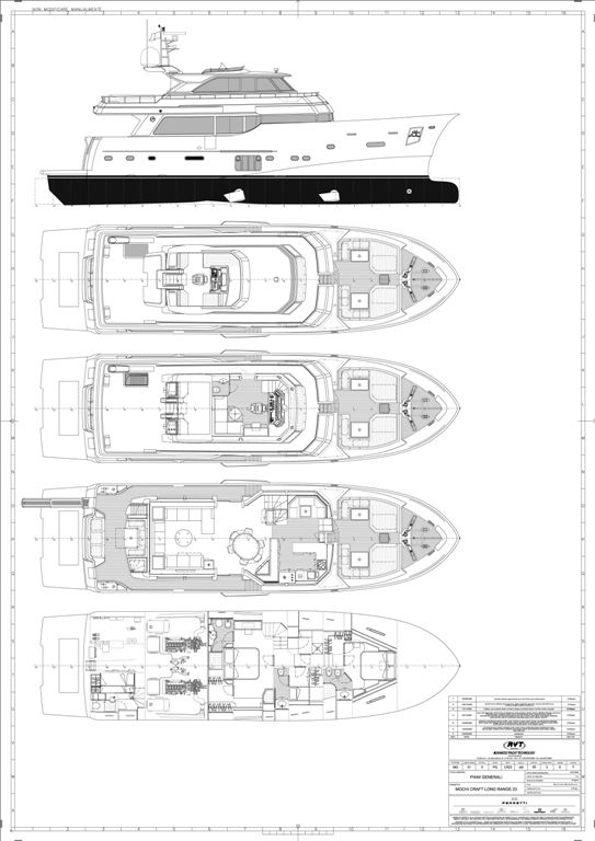

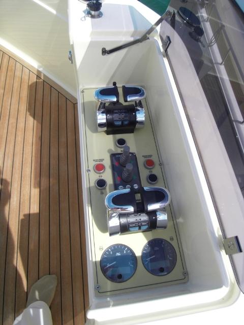

    From the technical point of view, the 75LR is a very interesting but complex design. The hull wants to combine the full displacement hull world with the planning hull world. As with all compromises, you will not get 100 % of both worlds.
    As you can see in the drawing, the original setup was with 4 (!!!!) stabilizers and two ARC gyros. Most likely not without reason. I do not remember whether the stabis were used for pitch control also. When the stabis started working hard during cruise, the fuel economy went down remarkably. When in semi planning mode, you could virtually see the fuel counter moving :D. In order to achieve a good range, you had to stay below 10 Kts.
    The hybrid power train was fascinating. It worked perfectly in all modes. Because of the limited (very expensive) battery capacity, the full E-mode was only usable for leaving and entering the harbour. But the trolling mode with the E-motors powered by the generators was nice and quiet.
    The hybrid system developed and provided by ZF is a very complex and somehow delicate equipment. It needs a good mechanic and perfect maintenance. The average weekend boater might be overtasked with this system. The ARC gyros are noisy, especially when the boat is on the hook. One big Seakeeper gyro would have done much better. But as far as I know, Ferretti is contractual bounded to the ARC system.
    The 75 LR is not a passagemaker or circumnavigator. It is a beautifull coastal cruiser for warm climates with the ability to support 6 to 8 people offshore for 10 to 14 days but with its 7800 Liters of fuel unable to do that under permanent cruise. A very nice vacation tool and probably great for charter if you can find a crew which is willing to live in this "rabbit stables".
    It is not possible to compare the 75LR with a Nordhavn 68 or even a 76. It would be comparing apples with oranges. A Nordhavn is heavy iron in comparison with a Mochi 75LR.
    Honestly, I would have bought the boat without hesitation but my son and his wife could not adopt the radical external design and the marginal planning performance.
    Below some more technical pictures. If any member wants to see more details, I can post GB of pictures if wanted.

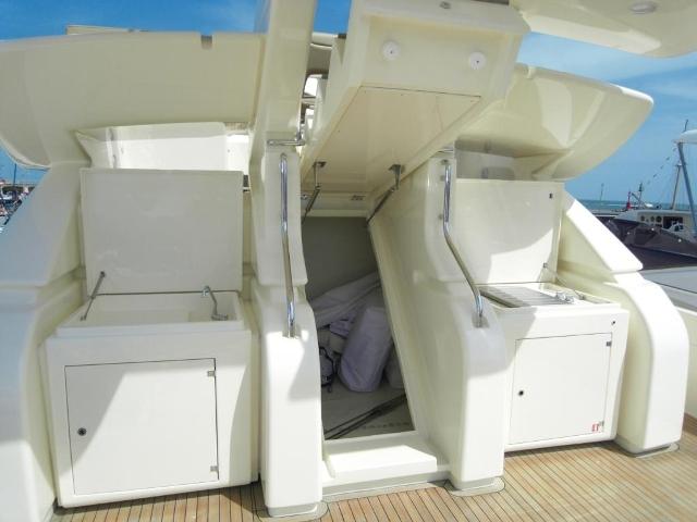

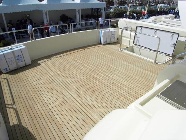

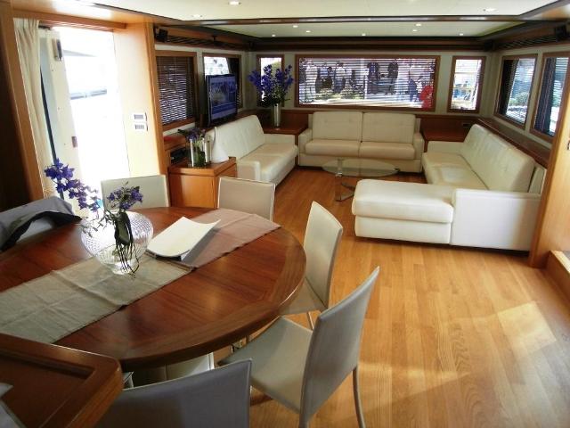

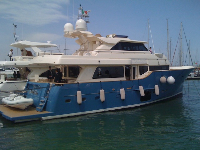

    Some pictures inside and outside.

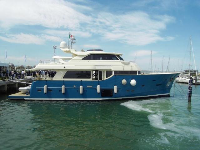

    Last set

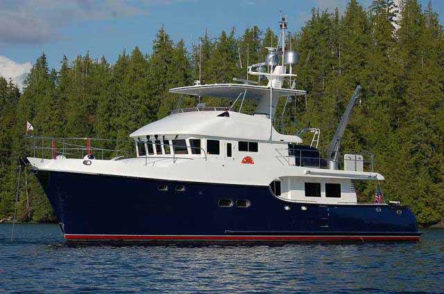

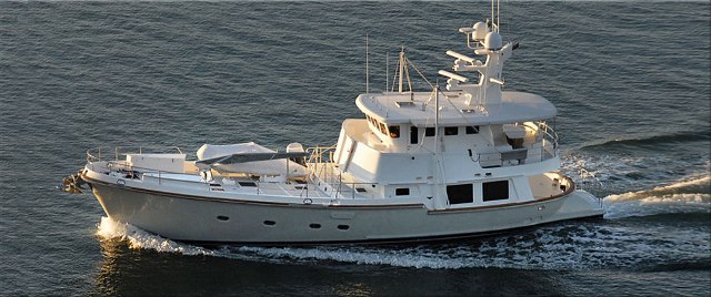

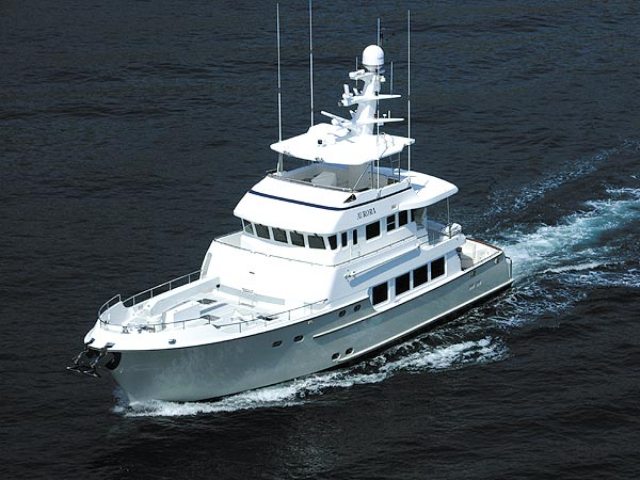

    They cannot be compared. The Mochi 75 LR and a Nordhavn of comparable length play in a different league. the NH 68 and the NH76 are true pasagemakers and far more sturdy boats with much more volume / weight and not really owner operated boats anymore. The biggest Nordhavn operated by an owner couple would be a NH 52 or a NH 60 max. For crossing any kind of bigger area of salty water with a boat of that size, I would rather take a Nordhavn than a Mochi. For idling around in the Med or the Caribbean Sea, the Mochi 75 LR could be my choice.
    Below a beautiful NH 68 and a NH 76, some real boats. But I must admit, compared to the average Italian plastic fantastic, the Mochi 75 LR carries her head pretty high.

    This is the NH 62 I am relating to.
    I believe an experienced couple with a lot of ocean miles experience would be quite comfortable taking this boat across an ocean. As with all voyages, it would take careful planning, and a 3rd or 4th crewman would be more comfortable, but still not compulsory.
