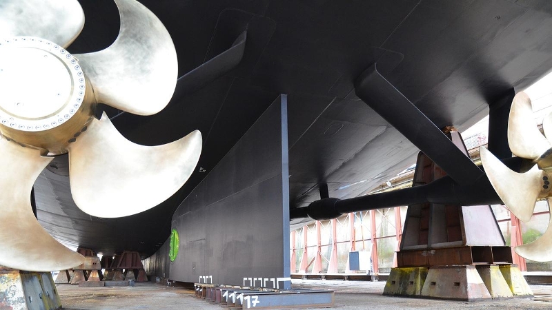

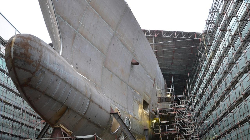

    Here You are, Sailing yacht during her build in the yard in Kiel. That green part on the keel is the underwater observation lounge. Some free pictures from the local newspapers.
    This monster does not sail very well and not very often. By the way, the complete sailing gear, including the masts, its steering and the sails were excluded from the contract. The yard refused any responsibility for the whole gear above deck. Wise decision!
    I personally watched Sailing Yacht A off the shore of Mallorca last year. It takes several hours from the sails completely stored in the booms to be fully raised and ready to sail. When fully geared up, it takes a lot of wind to push her forward. But with enough wind to get her going without engine power, they have to decrease the sailing area already for safety reasons and material protection. Also her masts and booms are movable within limits, it is by far not a dyna rigg and her underwater hull is not optimized for sailing.
    When she was going under sail, we could circle around her with my sailboat (without engine) with ease and she was always using her engines for additional propulsion (You could tell by her wake and her signal on the radar mast). We never saw her tacking, she only sailed downwind and as soon as she was off sight from shore, the sails went down again.
    Albeit having a sail area with enough cloth to cover a good sized circus tent, any historic cargo sailing ship can outperform her, both on and off the wind. She cant make any height. And with perfect wind on beam, she becomes a transverse runner.
    As said before, this ship has been built to be shown off, extravagance was the main goal, not sailing performance. As far as this goal is concerned, mission accomplished.
    You should watch the poor crew cleaning that hull, a complete nightmare. They have to be proficient mountain climbers and absolutly free of giddiness when hanging outside.

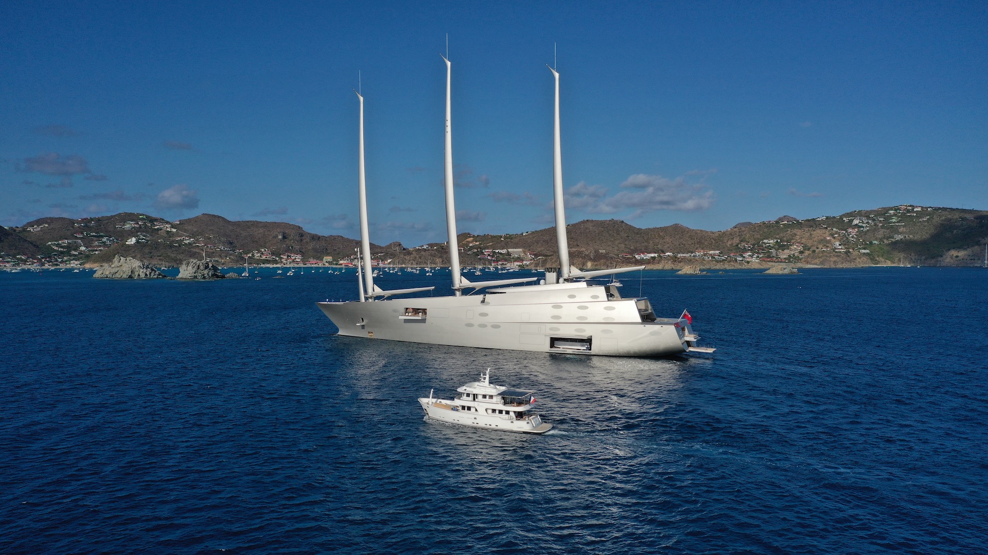

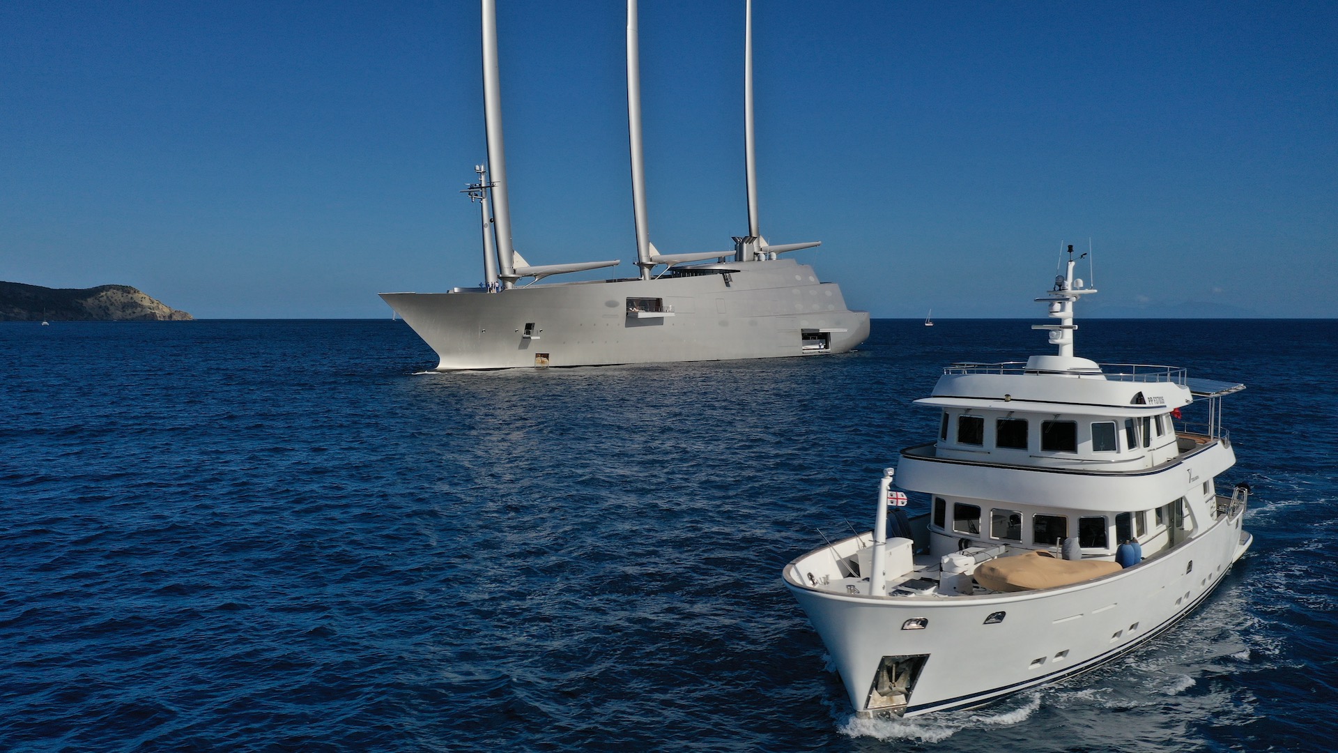

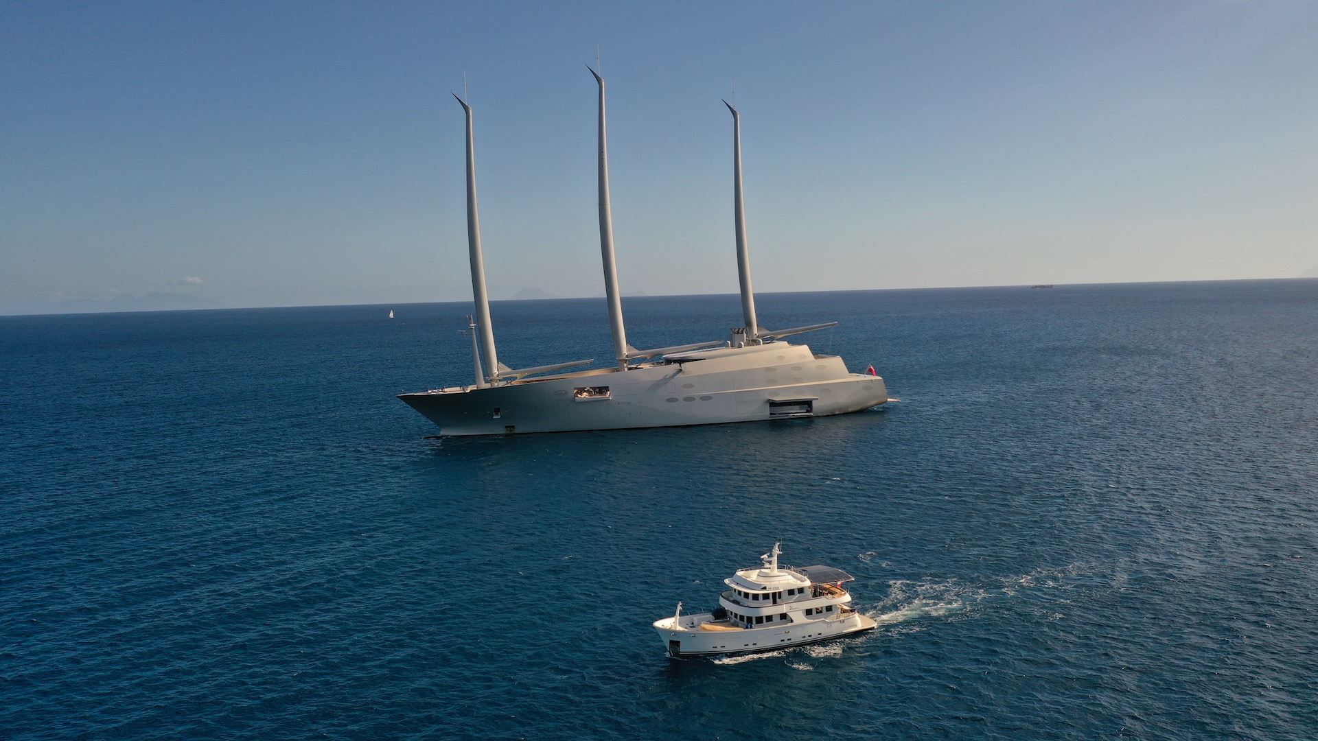

    Yesterday in St Barth going back on harbor, we didn't resist to make a 360° around S/Y A and drone shot
    This is huge vessel
