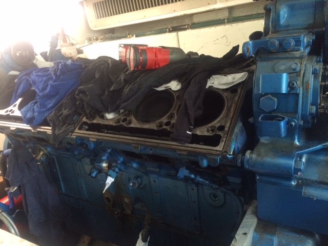

    I had been seriously exploring repowering at the end of the season. Now it is not to be. At start of last trip, got up to cruising speed and within a few minutes Stbd engine shot to 100% load but RPM's were dropping. Shut her down immediatley and went below. Found coolant sprayed all over fwd bulkhead and overhead from being puked out the top of the recovery bottle. Got back to the dock and started troubleshooting. Coolant system would hold 10 psi when pressurized from expansion tank cap. However, starting engine even when cold and immediately start seeing gas bubbles coming out the overflow tube and system would build over 12 psi within 1 minute. We figured a cracked head, maybe head gasket (o-ring) or injector jacket. Isolated issue to outbd side and figured we could quickly do a couple of heads and get back on the water. Pulled turbo to make room and found turbo vanes on exhaust side chipped from what appears to be compression ring pieces going through. Although the issue of exhaust getting into coolant side is not related to turbo issue clearly I had additional problems.

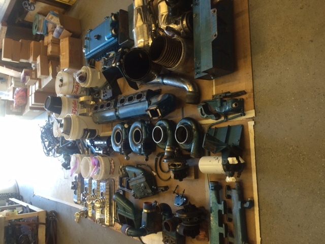

    So after a few days to get past my initial ire and do some soul seraching I decided to scrap the repower idea and do a complete in frame overhaul of my starboard DD 12v92TA. This engine has never been completely overhauled and was pushing nearly 4,000 hrs. My port engine has less than 600 hrs so hopefully after doing the Stbd side I should be good for awhile. Yes, I know these engines are not known for their longevity but I take really good care of them, I don't push them hard and even if I can get 2,500 hrs out of them I'll be good for another 5+ years, maybe more. Further, I can get the engine rebuilt in about 3 weeks and still save the last 1/3 of this season. And lastly I can rebuild this engine for far less then what a set of new engines were quoted at and I don't have to cut the boat apart to do the swap.

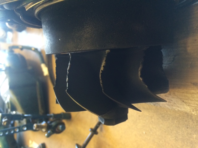

    I'm still dissapointed though as I was looking forward to getting new iron and picking up a little speed. Oh well, I still love the boat and the Detriot's generally run well (other than issue above obviously) and push the boat and a respectable cruise in the mid-20 knot range. Pictures of the torn down block and parts on the shop floor as well as damaged turbo vanes IMG_1693.JPG :

    Rebuilding this engine definitly puts off repower for foreseeable future. Rebuild will end up in the $75k + range. This includes replacing both blowers, both turbos, all heads, injectors, pistons,rods, liners, complete new raw water pump, new fresh water pump, oil coolers, etc. I also had to replace one exhaust manifold which the part was like $8k.

    Nope, she just gave all she had over 21 years. I only fish Salmon and Halibut so no chasing or backing down like you refer to :) #2 cylinder rings started coming apart. That sent little ring chips thru the turbos. We never spent the time to check heads or liners for crack as it didn't matter any more.
