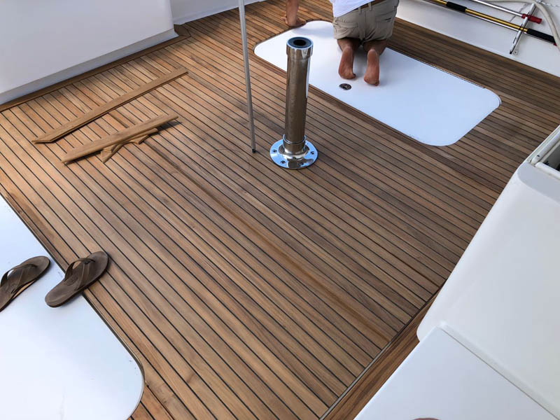

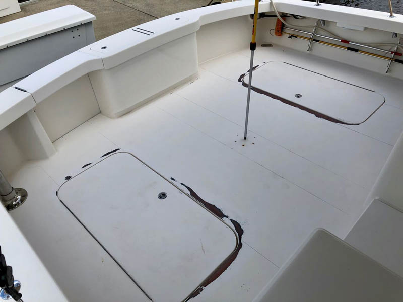

    Decided to pull the trigger on a new teak cockpit and cover boards on my 53. Will post updates as we progress.

    The guy I use is based in NC and does a lot of independent work for the custom Carolina builders. He buys lumber and rips, routers and planes it, and builds panels and caulks the joints and planes the panels in full 1/2" thick boards in his shop from patterns he makes on the boat. There are 5 panels on this one. He actually lays it out on the floor of his shop before taking to the boat. Its then glued down using West Systems Epoxy. Its clamped, temporarily screwed and weighted down until it sets overnight.
    Then the joints at the panels and edge border are caulked and then finely re-sanded in place. Its an art, and he does great work. The cost for this job including the step, cockpit floor and new heavier 316 stainless hinges for the fish box and step cooler is about 14K. Covering boards will be another 9K.
    The problem with the "stopping by" is its not a quick process. About 6 weeks for this job from start to finish, and he does not have a yard, so you have to have a spot to do the work, and he's backed up all the time.

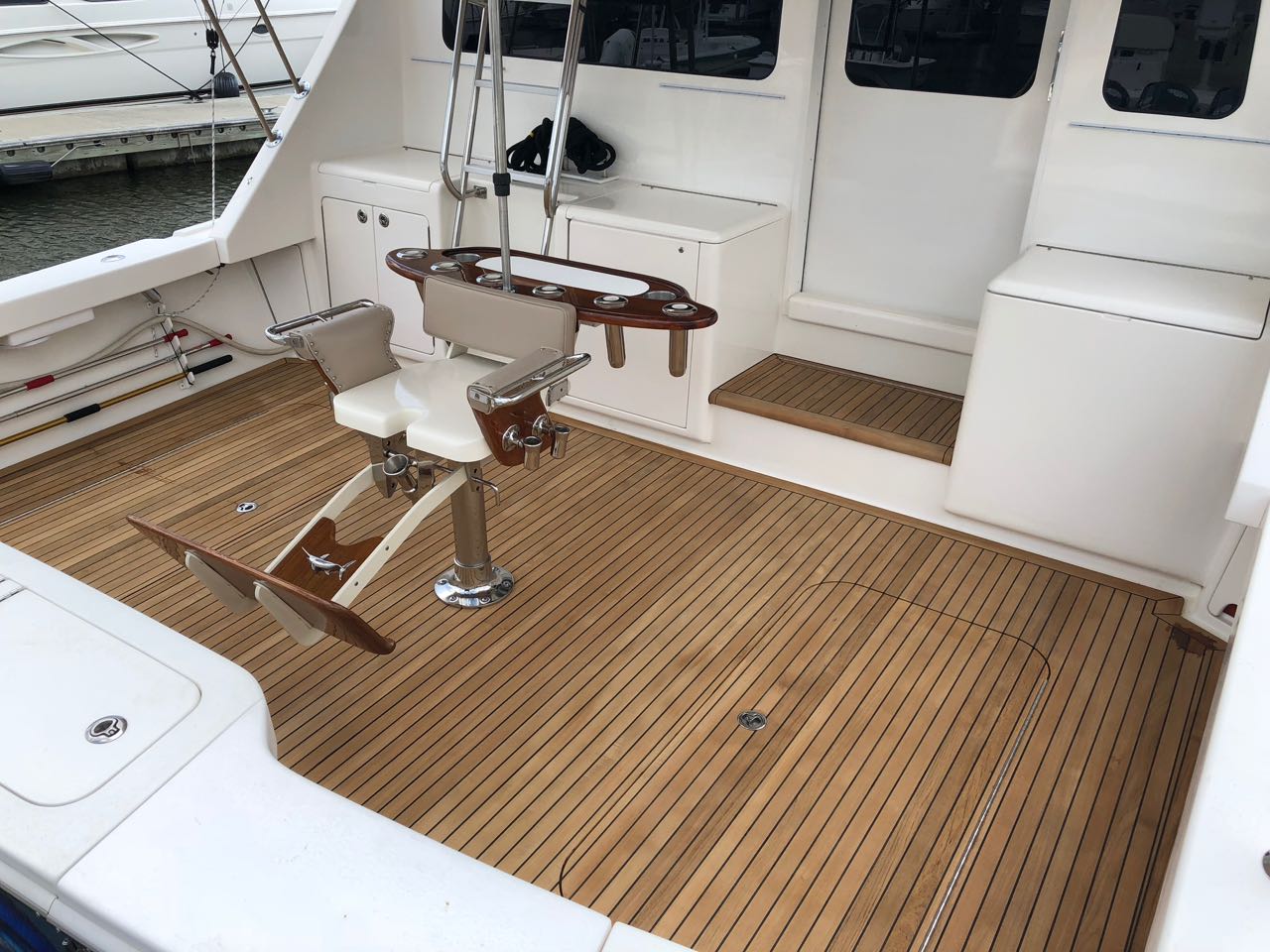

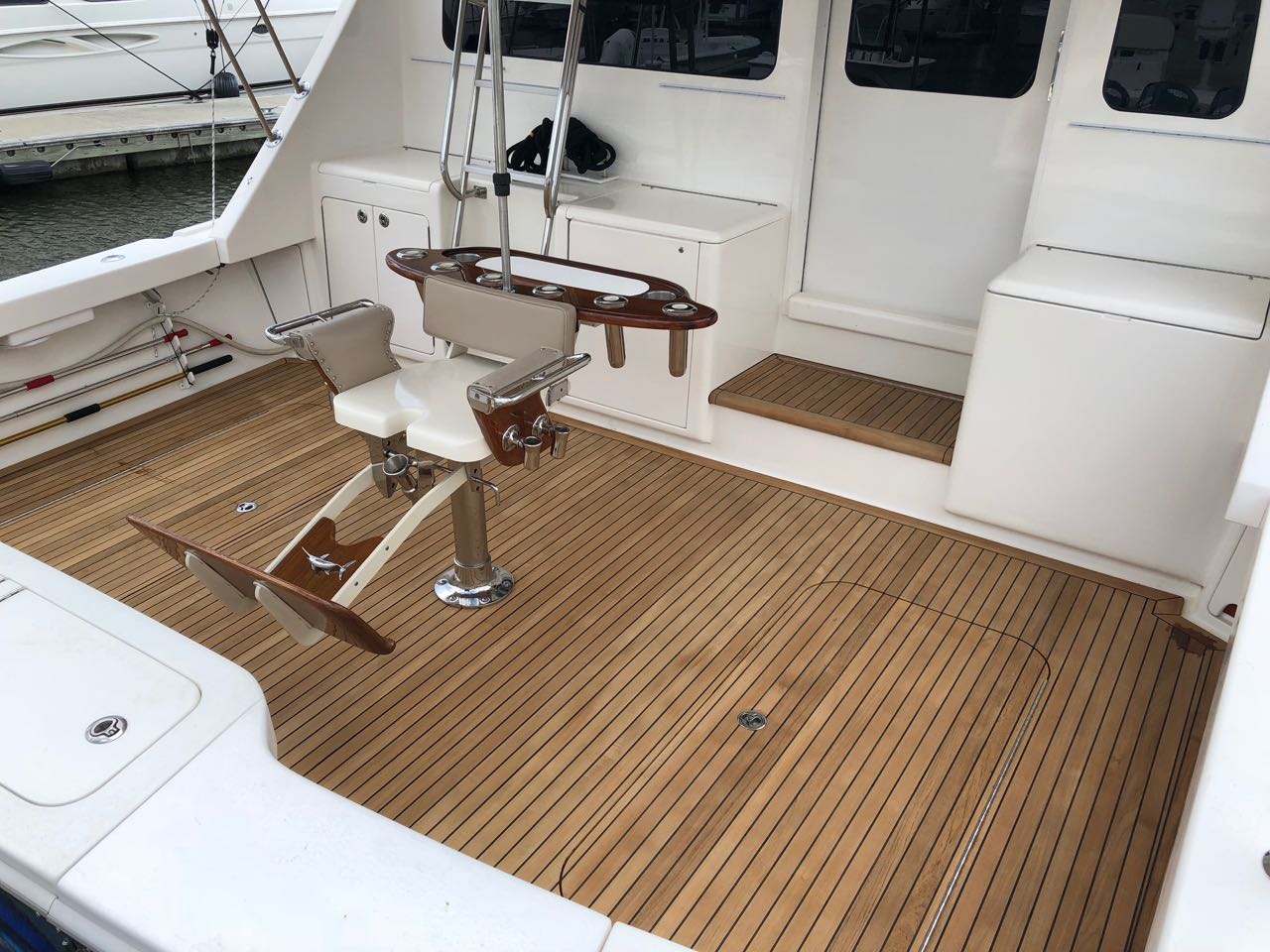

    IMG_0726 (1).jpg Deck is finished. Turned out great. Now waiting on lumber for covering boards.

    Amazing job! Looks great.

    Great looking cockpit! Looking forward to seeing the covering boards. It will add a great look to your Post!

    But a quick question from a layman (and maybe just a bit laze one at that): I've had teak on several of my smaller boats and hated when I had to refinish them. But that was many, many, many years ago. Is this coated with a finish that either eliminates the maintenance or extends its look for years?

    Generally teak decks are simply cleaned every month or two with water and a product (some people even use cascade or ammonia) and a light scrubbing

    But doesn't the teak then loos its luster - the rich look and fad?

    There is no finish, just the natural oils in the teak. Capt J is correct. The best product to use that I have found is powdered oxyclean or cascade.
    Clean it once a month or so with a pad and it comes right back.
    I am told never use these new acid systems as it eats off layers of teak and greatly shorthens the life. Oxyclean removes the surface dirt and does not eat away the lumber.
    Then once a year do a overall light sanding. It should last at least 10 to 12 years.
