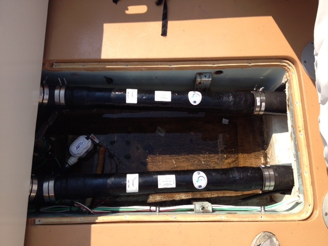

    Kids back in school full ime and I actually snuck away today install the mufflers I mentioned a few weeks back. These are the Vernatone (Cendek) ski style mufflers - very easy to install. Purchased a 3 1/2 PVC pipe test cap - that plumbers use to test their lines, and used that to block the exhaust pipe at the stern so I could work without hauling out.
    I would say that they reduce the sound by ~30%, I was hoping for a little better than that. I guess there is no quelling the beast as those 4" pipes really roar as you throttle up.
