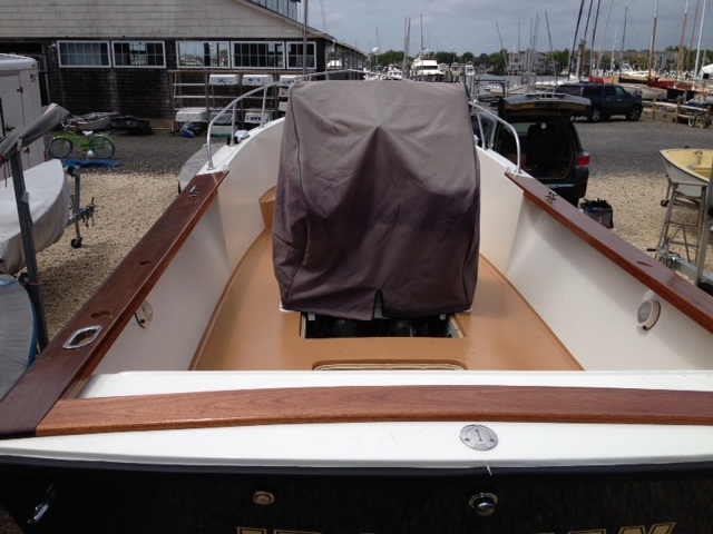

    This is the topside/deck

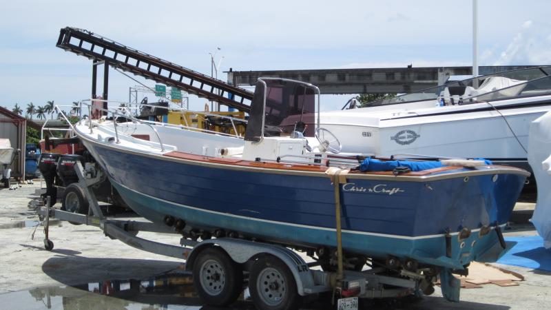

    My insanity has arrived!!!
    Congrats on your great looking rig, Ironman Charlie!!! It looks like we might give birth to "twins"...
    Noon today my new toy rolled into Fort Lauderdale... and so far on an hour's quick inspection I'm pleased. It looks like cockpit sole and hatch repairs done by the prior owner were done correctly, and I have a minimal amount of "undoing" to do before making forward progress. I've not yet fired it up, but based on the survey that says it "runs fine" I am thinking I might just keep the low-time Chrysler 318/200 HP motor with 1:1 Velvet Drive that's in it and worry about getting a 350 repower in my next life. Does anybody have a good guess what prop size should run on this thing? The current prop is a "13 x 11 full cup" which, according to prior owner, was installed to allow slow, slow fresh-water trolling.
    I also note the stainless tube windscreen frame doesn't look quite right... about a foot up from the console top it has a through-bolted slip joint and the bottom tubes either side of the console have open cut ends facing forward. Anybody have some clues as to the "OEM" design in this area? I'm also still scrounging for original dash panel layout details if anybody has one or a detailed pics of one...

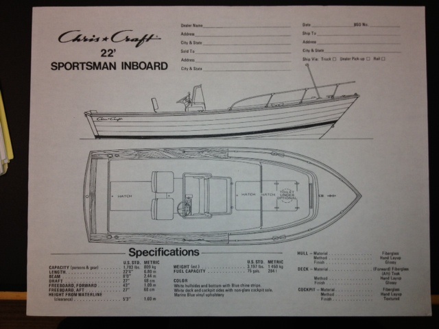

    I was thinking about our projects, and remembered that I found this on line a while back. I have the actual PDF if you are interested.

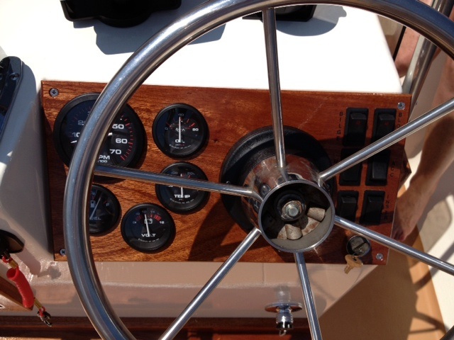

    Michael - I replicated the gauge panel that came with my console last year - only added a fuel gauge. I always assumed that it was original, but I could be wrong about that. I will sends pic after I am over there tomorrow.

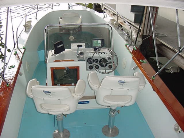

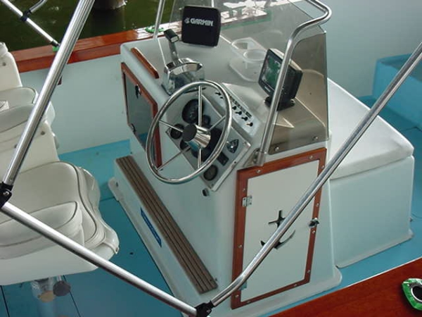

    I believe that my windshield was original. Here are a few pics from my 1977 model.

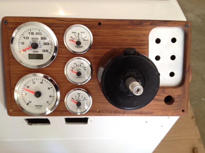

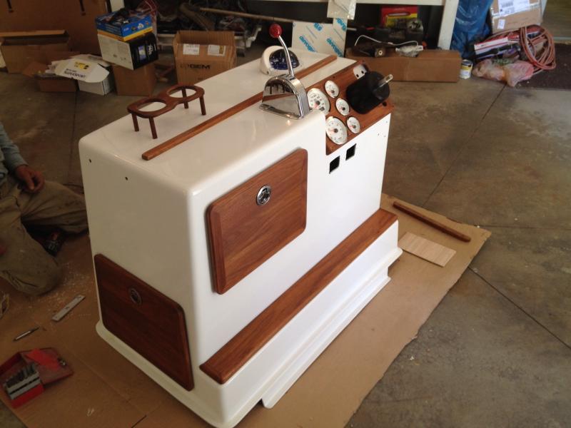

    The pics just posted are indicative of the original windscreen frame and look identical to the one I have. Also, our instrument cluster is new but made to the exact specs of the OEM configuration. The attached pic is from during the restoration. Also, we remade all the hatches and doors but tried to mimic the OEM look and function.

    SeaEric - good to meet you... and thanks for the frame (and other) pictures. I appears your console has been nicely modified with the addition of a faired-in switch panel and equal size-shape doors either side (unlike the original design I have).

    The power steering unit was on the boat when I acquired it so we stayed with that system. Also, we attempted to recreate the OEM hatches and doors albeit with solid teak, and maintained original functionality.

    Gauge panel
    A little hard to see... I did tach, oil, volts,temp and fuel on one side. The rocker switches are bilge, blower, accessories, navigation lights, instrument lights and anchor lights
