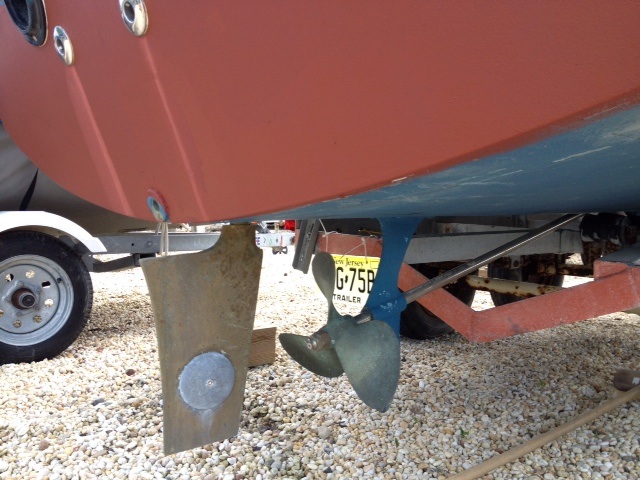

    I am definately running at the factory specs. I will check on the prop when I am there tomorrow. I am fairly certain that I have the original prop on there. A new prop is in my future, but the back office is starting to complain about the budget, so it may be a while.

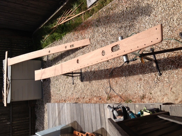

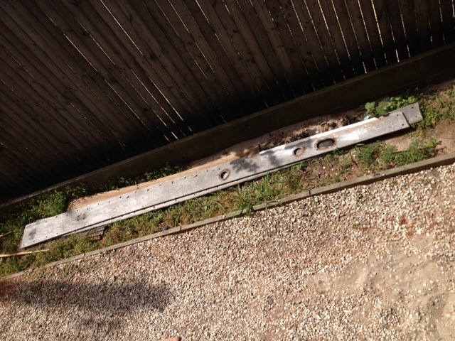

    I also have these if anyone is interested.
    They were banged up pretty good in the storm, but I filled in the damage with filler and used them as a template for a router set up with a spiral bit and bearing to copy the pattern. Actually worked out pretty good

    Ironman, Where did you get the new teak that wide, the gunwales on mine are in bad shape. What did the new teak set you back? I have been thinking replacing it with mahogany instead, about 1/2 the price.

    I will get the clearance and post it. We are running the following: CC307 (stroked to 354ci and 325hp) paragon p31r RH rotation on a 1" aquamet 22 shaft spinning a 14x11 supercup prop. Performance so far is great. Cruise is 35 mph @ 3600 rpm.

    Again, not a motor expert. I am running a new 357 mercruiser with a paragon transmission, a 1" shaft through a water injected stuffing box - i have the exact specs on these in my office. The prop is a 13x13 bronze (LH) prop, looks like there is ~3 inches of clearance between the hull and the prop blades

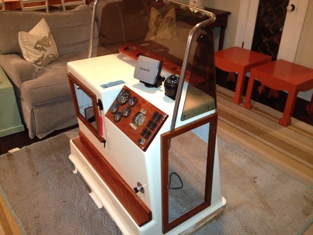

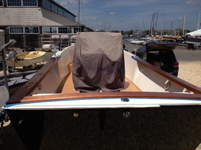

    This was completed last week and installed this weekend. I am down to a punch line to launch and will try and snap some pics when I am there this afternoon.

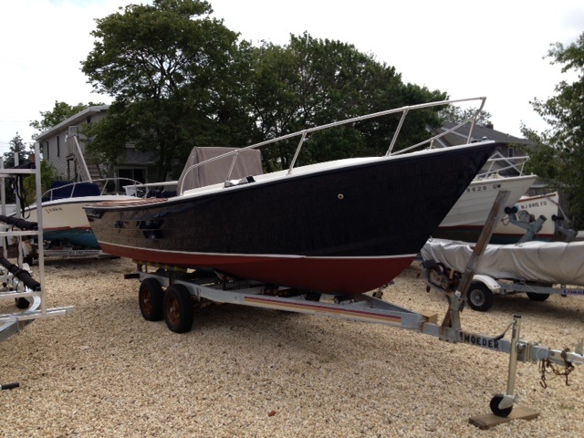

    Almost there........

    Its ready shaping up, console look great and the gunwales with the new teak!
    If you missed my last ?, where did you get the teak 9 1/2 " wide and what did it cost you. I have to replace mine also, been thinking of using mahogany instead. alittle cheaper.

    I may not know much about transmissions, but I do know a lot about lumber and millwork (and boat painting - lol)
    That is Philipine mahogany. I could not tell the different between it and teak - and as you say, quite a bit more affordable. Those three pieces (1"x10" by 12') ran me about $225 from a local supplier

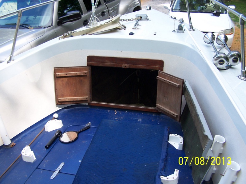

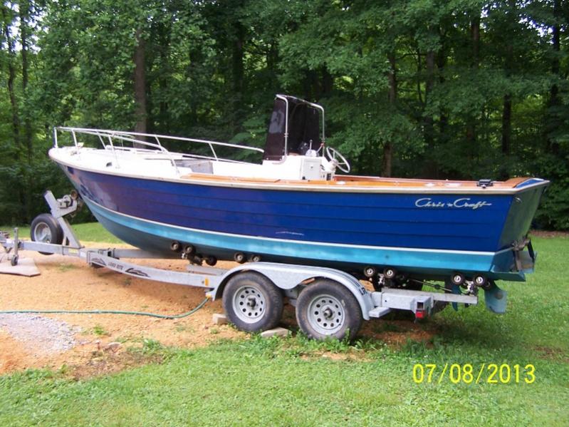

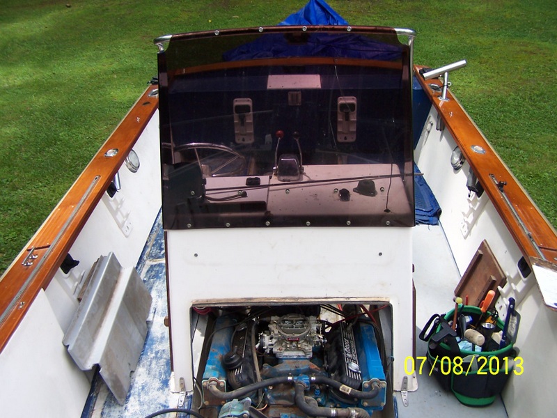

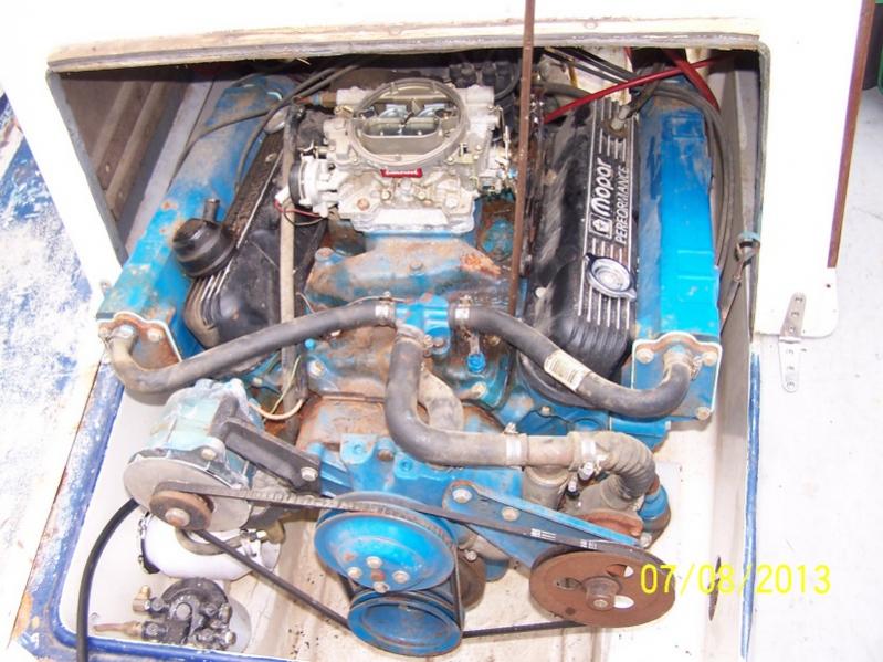

    Greetings, all... have just "joined the club" with acquisition of a 1975 22' "Dory" I intend to restore that will be delivered to me Monday here in South FL (fingers crossed). I have greatly enjoyed looking at the pictures in this forum and reading the tech notes, and I know once I get this rig and start detailing the restoration plan I'll likely generate quite a few questions of my own. The boat is presently outfitted with a Chrysler 318 (210 HP) which runs well (according to the surveyor I had look at the boat for me), but like many here I am thinking of replacing it with a 350. With that, here are a couple of pictures of the boat I hope to see in a couple of days!

    Dorys will last forever
    Welcome aboard CC.....
    Looks in good shape compared to what I had to start with! God do I hate sanding fiberglass. ( If god wanted boats made of fiberglass, he would have created fiberglass trees) Good luck with your restoration, everyone here is ready to help.

    Great pics - looks like you have some after market stuff on there - trim tabs, horns, rudder and anchor winch?
    Like John said a few posts back, it is pretty amazing that there are four boats (by my count) all in restoration at the same time.
    I believe you are aptly named "insanity" as that's what it takes to get one of these done - lol

    Gents - big weekend for me. Spent the day on Sat closing out a punch list of items to complete prior to launch. Micheal - you see we have similar taste in paint color. This is all interlux: flag blue hull, oyster white topside and sundown buff deck. These colors are pretty typical of Barnegat Bay.
