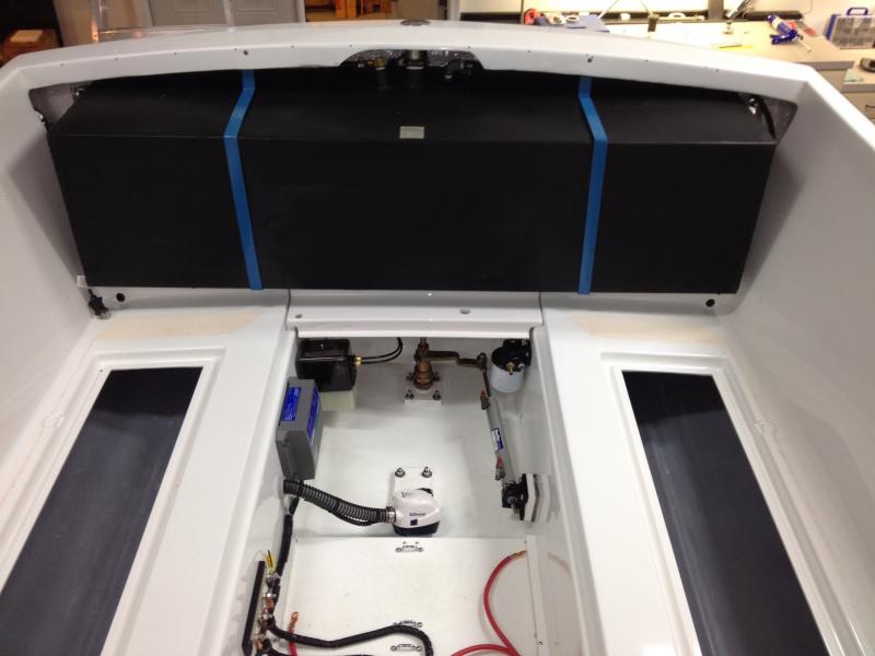

    The hatches are approximately 48"x14" with moulded in drain channels and recessed areas for the hinges. These are completely open underneath as we removed all foam from the boat. Also, brushing is not recommended with the MS600 system.

    Thanks for the kind words Ed. I have a million photos of the restoration and issues we engineered around so if you have any questions don't hesitate to run them by me I would be happy to help if I can.
    As a note to the last photo, we ended up re routing the exhaust outboard of the center compartment to free up room in there for two batteries and all the other goodies you see.

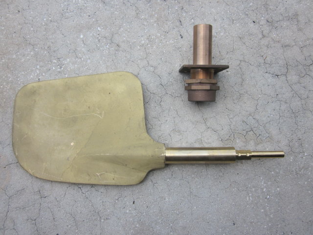

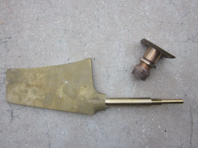

    One note, I am not a motor head, but I do remember my repower guys having trouble finding a bell housing that had the proper mounting configuration for the new Mercruiser engine and was short enough to fit in the engine compartment. Between the bell housing, the sheer plate and the new engine mounting position, I ended up needing a new prop shaft.
    My rudder was frozen in its port, so I ended up replacing the whole thing, it was a 1 1/4 shaft - I have the vendor information if you are interested. I installed the stock rudder, not sure i would do that again as it does slide a bit when turning sharply at high speed. I will post a pic in the AM - somewhere on my computer I have pics of the two rudder options, I will try and find those.

  7. Ironman
    Ironman Member
    May 19, 2013
    57
    New Jersey
    Rudder Options
    This is the one I have.....
  8. Ironman
    Ironman Member
    May 19, 2013
    57
    New Jersey
    This is the one I would get.....
