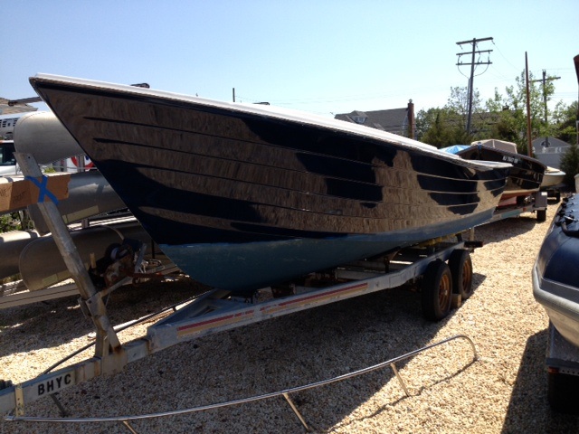

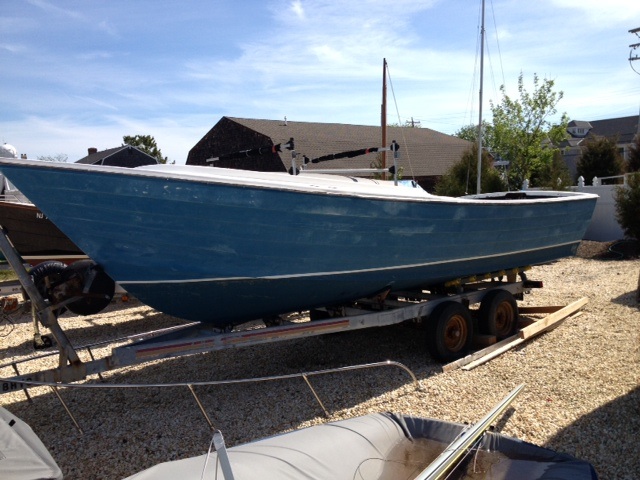

  3. Ironman
    Ironman Member
    May 19, 2013
    57
    New Jersey
    Before......

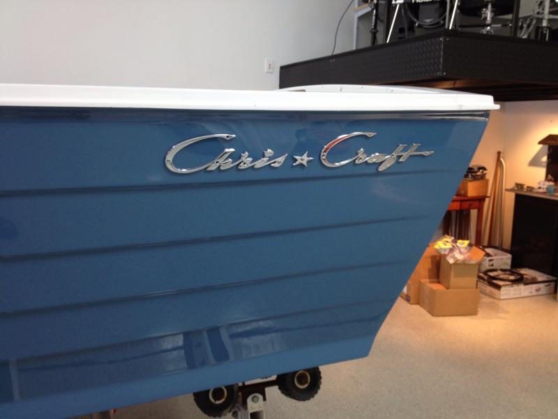

  4. Ironman
    Ironman Member
    May 19, 2013
    57
    New Jersey
    After.......

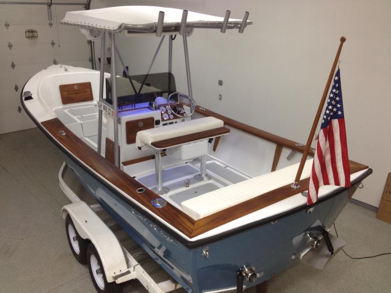

  7. Alanglois
    Alanglois Member
    Dec 1, 2004
    60
    Mentor Harbor Yachting Club
    Hello guys I was following the thread and wanted to chime in. I recently finished one of these vessels top to bottom -liner out and everything. The project almost ruined me! Anyway it was all worth it. Glad to see more of these finding brave souls to save them.
    Al

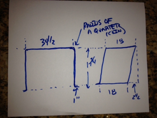

  9. Ironman
    Ironman Member
    May 19, 2013
    57
    New Jersey
    Engine box dimensions......

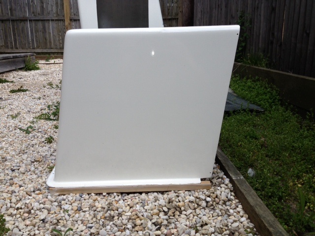

  10. Ironman
    Ironman Member
    May 19, 2013
    57
    New Jersey
    Side view.....

  12. Alanglois
    Alanglois Member
    Dec 1, 2004
    60
    Thanks Ed,
    Lets put it this way - I could have picked a better starting point than I did! We ended up lifting the liner out and engineering a lateral stringer/rib system into the boat and eliminated all wood and foam. The main stringers now run through 85% of the hull and are epoxy slurry filled FRP beams bonded to the hull. Also we tied in 3/8" stainless steel plates that bolted into the stringers for the tower and leaning post to fasten to.
    Long story short, it took about 3 years start to finish. Our project is a 1975 edition. We rebuilt the original engine (and slightly enhanced it ;) to the tune of 325hp) She runs like a champ!
    Al

    engine box
    Ironman.....
    Thanks for the drawings and measurements. That will work, I'm going to pre-assemble it using 3/4 foam sheets as core than glass. Using the foam makes it pretty easy to get the radius corners.

  15. Alanglois
    Alanglois Member
    Dec 1, 2004
    60
    Ed,
    We used the new Imron MS600 primer/paint system and I am thrilled. Not many guys have used it so I'm not sure I can recommend it from a labor standpoint but the finish is exceptional.

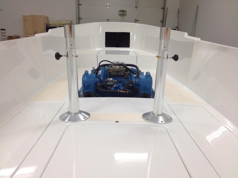

  16. Alanglois
    Alanglois Member
    Dec 1, 2004
    60
    And another.
  17. Trapshot
    Trapshot Member
    Apr 29, 2013
    52
    PA
    imron
    Al...
    Is the emron brushable or spray. finish does look fantasic!!!!
    Have to look into it
    Ed
