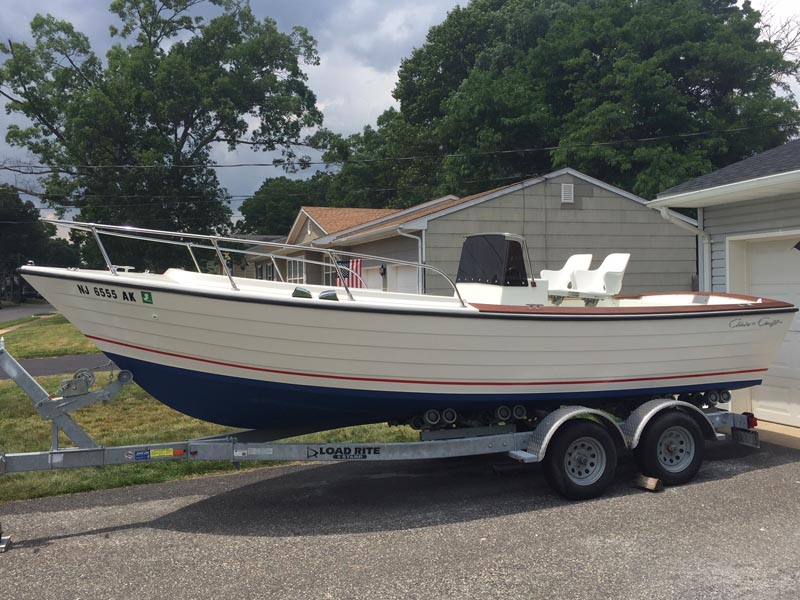

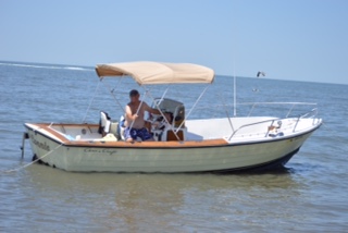

    I went back and saw I first chimed in on this thread over 5 years ago. I bought this Chris 8 years ago and am happy to say I am finally finished! Rebuilt from bottom up. Removed/replaced all soaked foam below decks, replaced engine beds, brand new 350 and gear, repainted hull and topsides, hand made covering boards, tongue and groove wood doors and dash, replaced every hose, wire, light, nut and bolt. What a journey!! Time to enjoy! View attachment 81929

    1A423487-1B23-49B7-8F53-43CDA77CD610.jpeg Good luck with her, looks beautiful. Where are you located? I’m in Cape May

    Thanks Capt Bob! I am in Brick, NJ

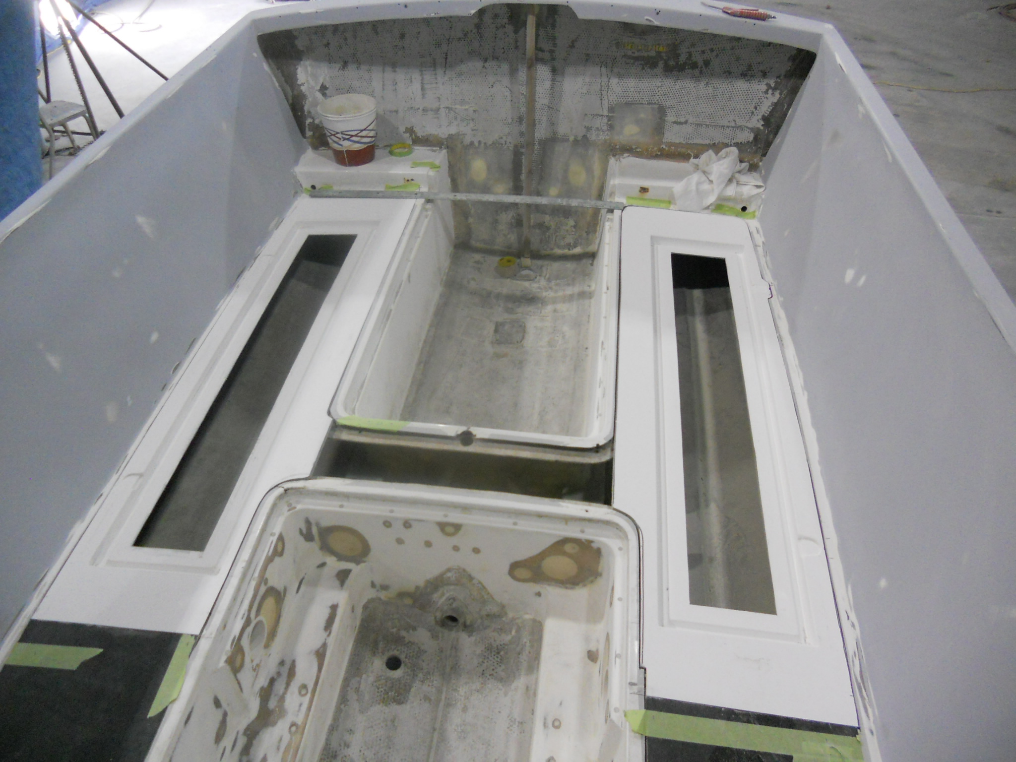

    Greetings everyone from the Chesapeake Bay. I am now the new owner of one of these 1975 classic 22' tournament fishermen. Found one in Mass. after searching for about a year and had it shipped to MD last week. Started cutting out the floors and removing foam last weekend. She will also need new engine stringers which I expected.
    My early calculations are that I will end up removing close to 1000 pounds of waterlogged foam and rotten floor coring. Plan to replace with Coosa board. I have spent a lot of time already learning from what all you guys have posted and will appreciate any and all help you are willing to share as I begin this journey. You guys have done some amazing work bringing these boats back to life and I am excited to get started saving another one.

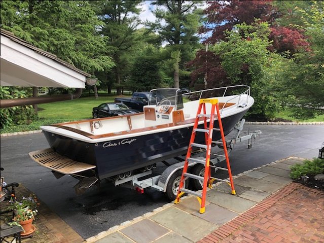

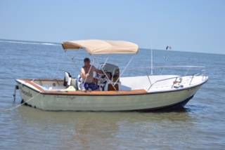

    Here's my 79 Chris Craft Cutlass, my first boat ever and I blew the engine 1/2 way thru the season wha , I love this boat so a rebuild starts soon.[​IMG]

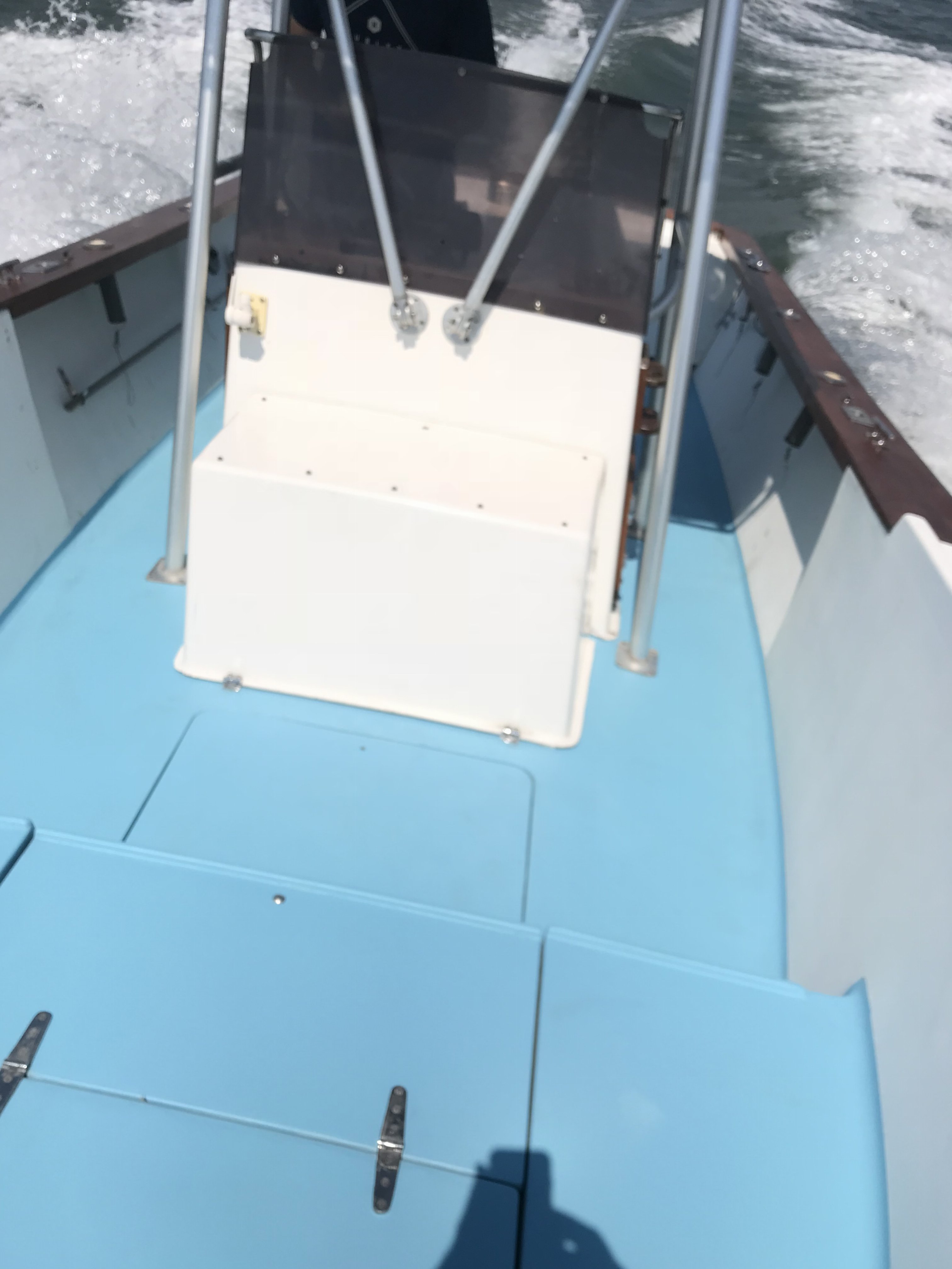

    I finished my decks this spring I had no foam under the deck did some years not have foam??

    1975or77 I’ve been working on it a while I found the hull on Long Island a couple years ago
    Replaced fuel tank, steering, power and decks they are great little boats

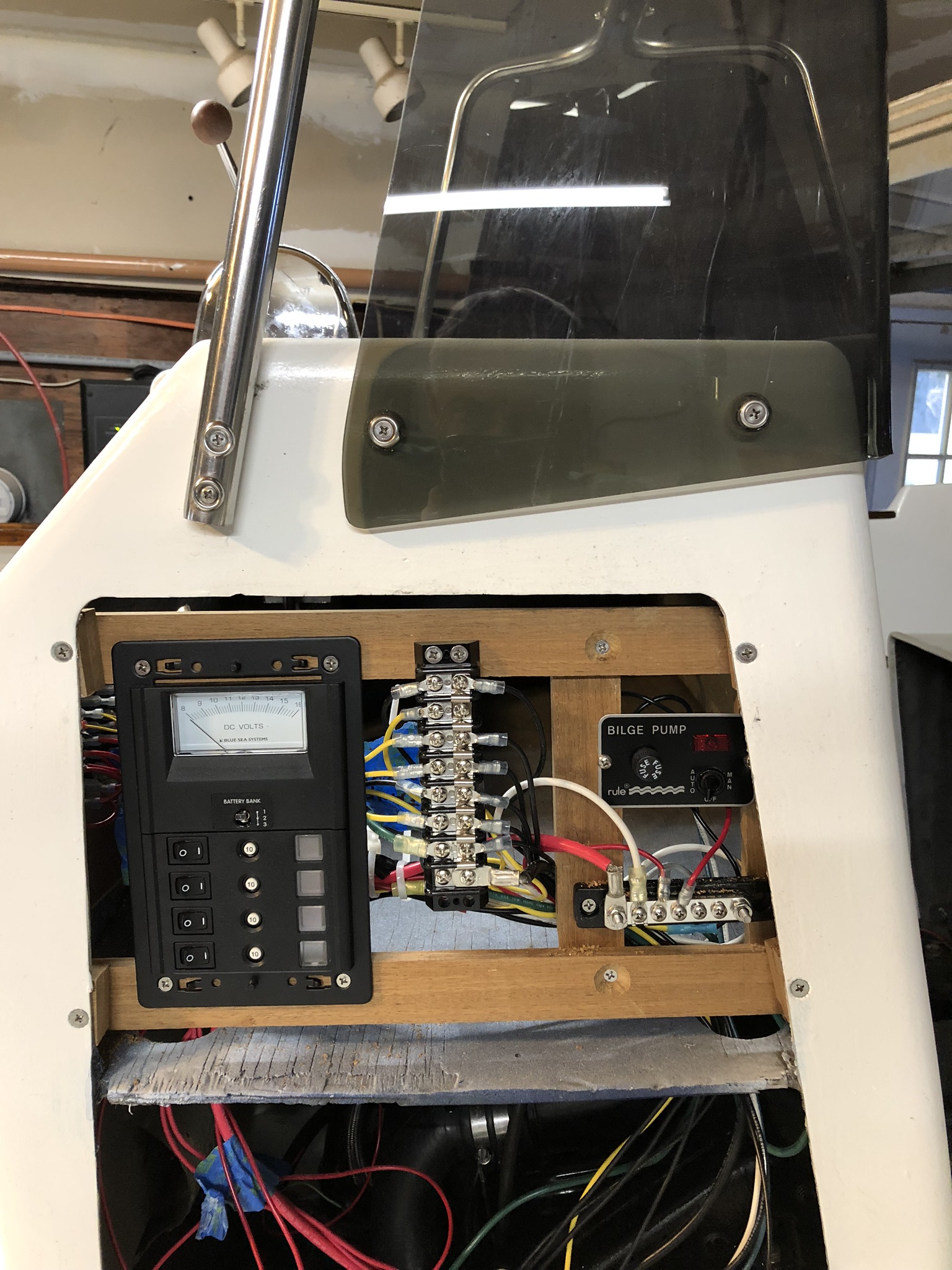

    Well, my 22 is coming together nicely. Just finished the wiring. Have half the exhaust done, and just sent the prop out. Pic is the breaker, pos and neg bus.. I put them on teak slats for good ventilation. Notice newly bent windshield! 093E10E8-E07D-450F-B8C0-A857455CFA0D.jpeg

    Nice and simple.

    Nice work. the original wiring access in the console wasn’t a very user friendly spot. I keep putting it off

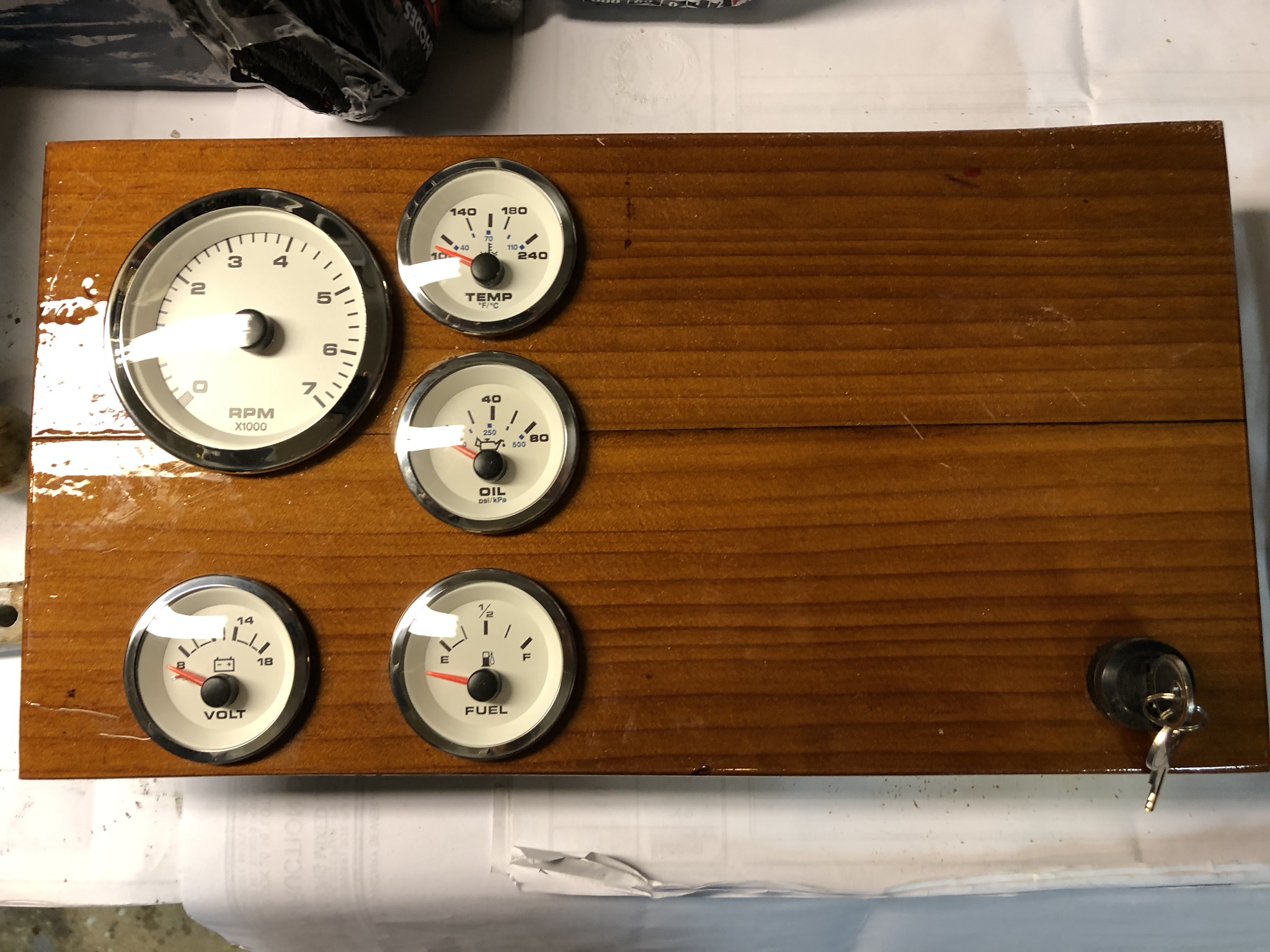

    Al Langlois here, sorry I have taken this long to get back to you but I have finally located the archival photos from our restoration. Not sure if you still need any insight or if you are past where you were but if you want to give me a call we can talk and you can give me details of what images might be of assistance.
  17. Alanglois
    Alanglois Member
    Dec 1, 2004
    60
    Mentor Harbor Yachting Club

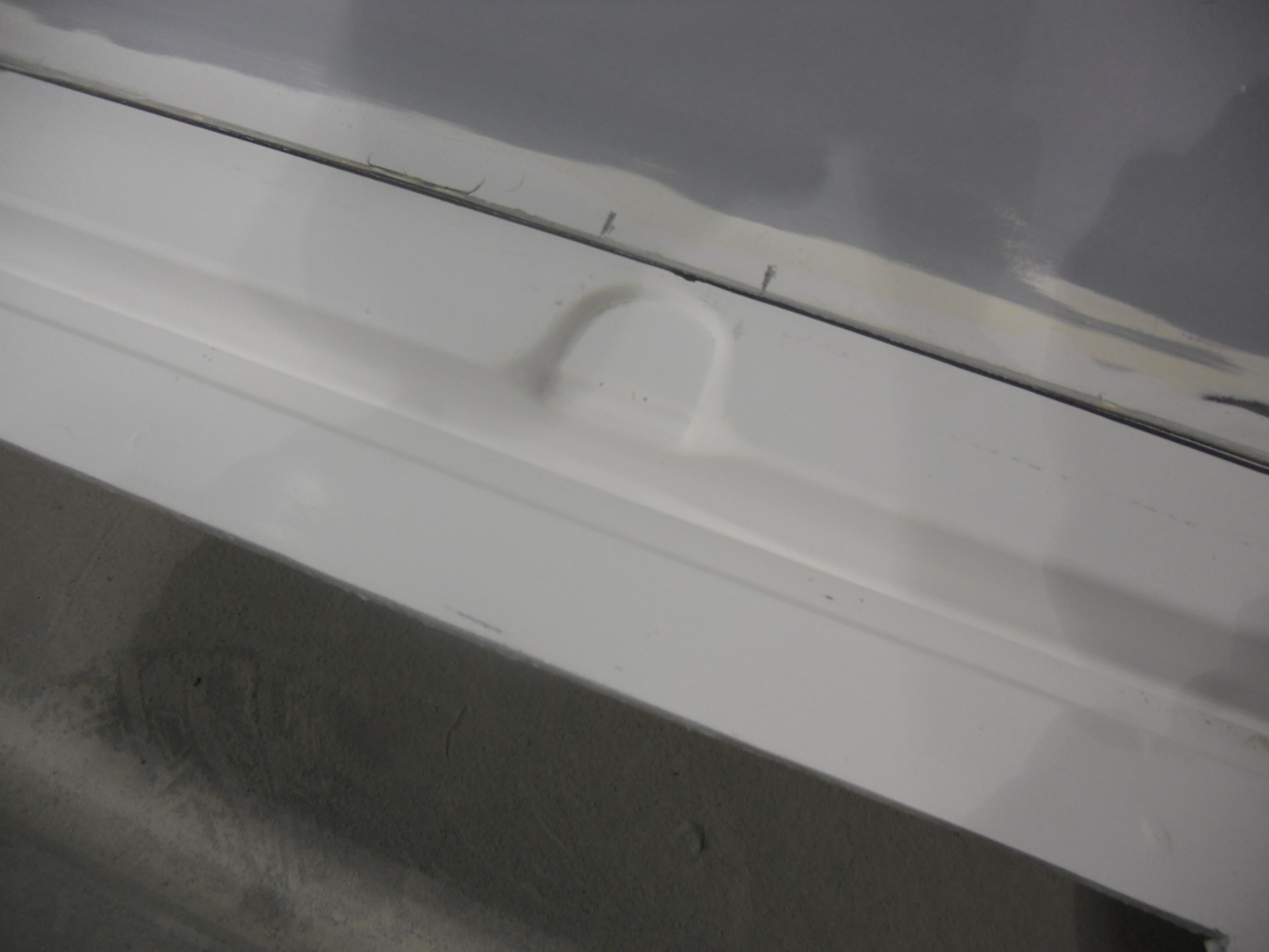

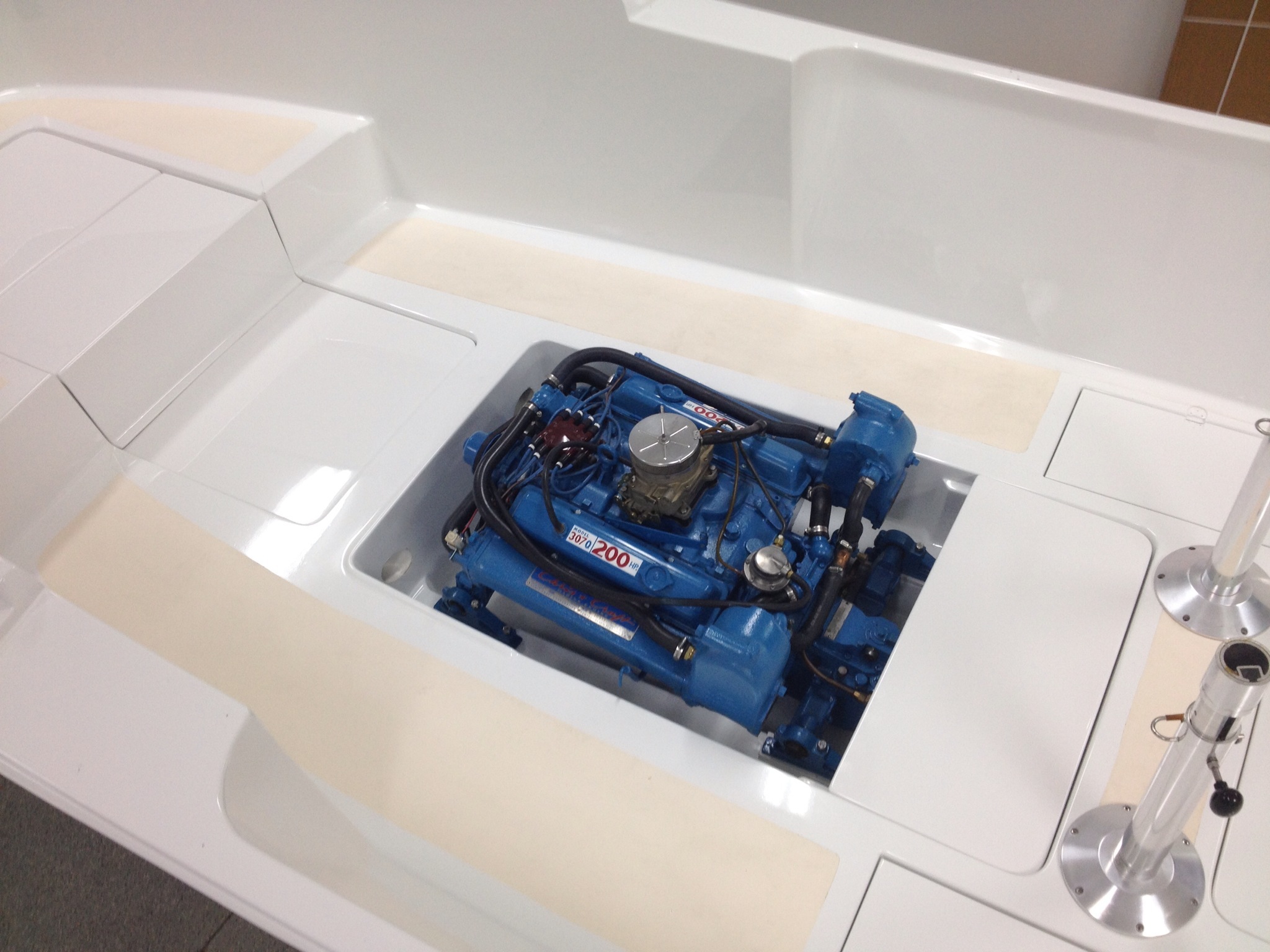

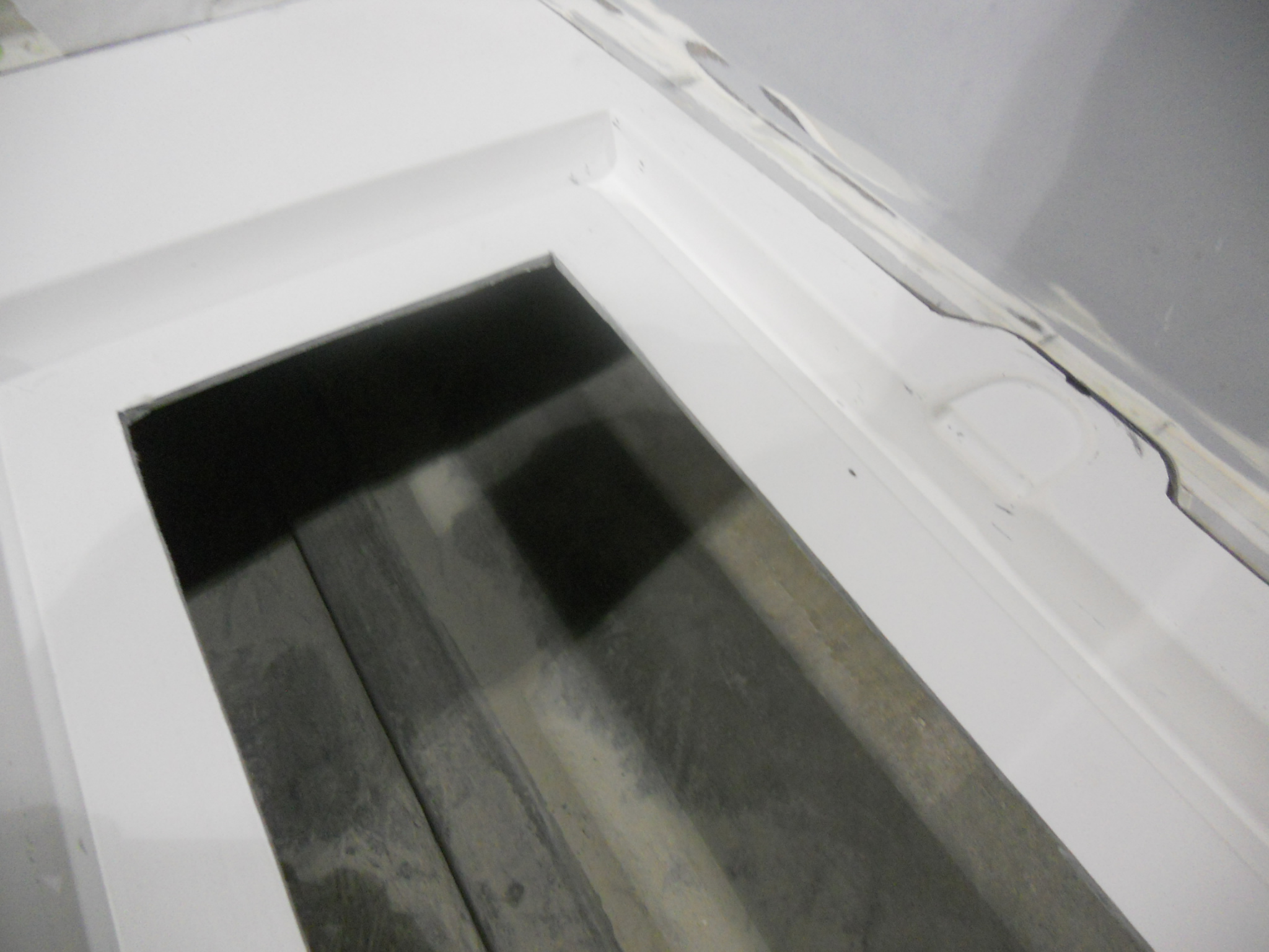

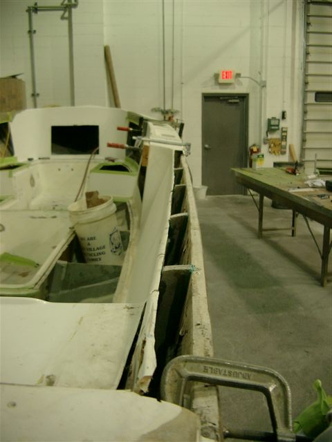

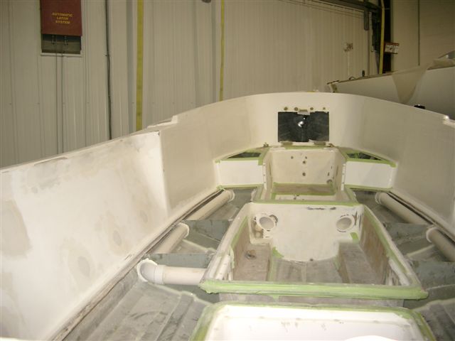

    Ok, So I am going to post some images here on the request of Brooke Dyer - His inquiries are regarding our reinforcement of the liner to hull structure upon removal of the foam, our installation of two floor hatches outboard of the aft central hatch which in OEM form housed the exhaust system (mufflers) and our treatment of backing plates for the helm seats and in our case the tower and the aft lifting point. You can see from the last two pics in the sequence that we placed new rib structure every 18" between the hull and the liner and added structural supports under the floor. We rebuilt our original 307Q completely as I wanted the boat to have an original motor, however we did substantial mods to the motor on the inside which resulted in a dyno run of 325.1 HP @ 4781 rpm. With the current 14x11 prop I can run 4200 rpm and I get about 34knots at WOT. The boat weighs in at 4650 lbs with 37.5 gallons of fuel (1/2 tank) one person (195lbs) and 75lbs of gear. I am changing the prop this winter to get my rpm up where it probably should be at WOT which is around 4500-4600. we are going with a 13x10 supercup prop. I'll report back on the change in performance. I have to go smaller with the prop as I was getting cavitation at high rpm with the 14" blades under 2in from the bottom of the hull.
    Bear with me on all these photos..... and it seems that many of the images are too large to upload here so Brooke will be getting those in a separate email.
    Al DSCN0658.JPG DSCN0658.JPG DSCN0660.JPG DSCN0661.JPG Liner Hull Support.JPG IMGP6175.JPG
