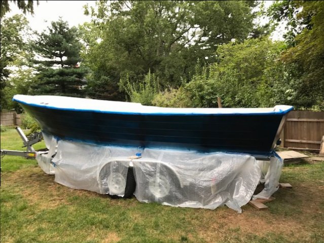

  14. David Hoder
    David Hoder New Member
    Mar 23, 2016
    22
    Fair haven, nj
    The Chris craft is looking good. Flag blue. Running into colder weather though!!

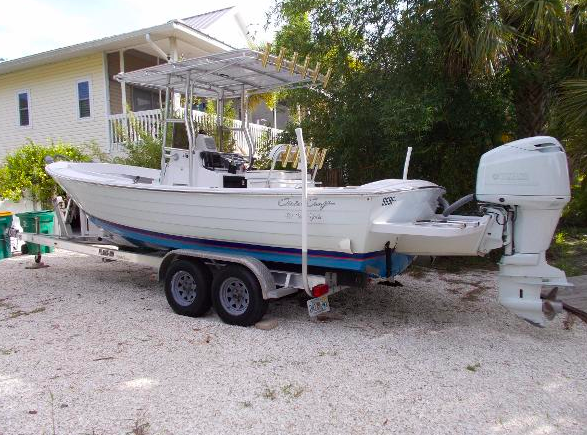

    Great thread! Future Chris Craft Cutlass owner here. Looking for a good high volume site to gain info on Chris Craft Cutlass, any suggestions?
  20. jamesfrancis
    jamesfrancis New Member
    Jun 11, 2014
    6
