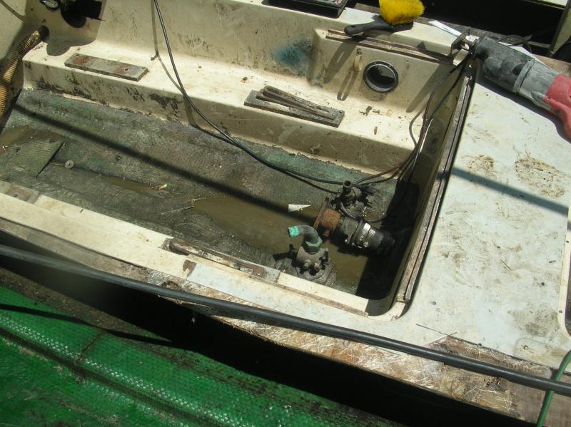

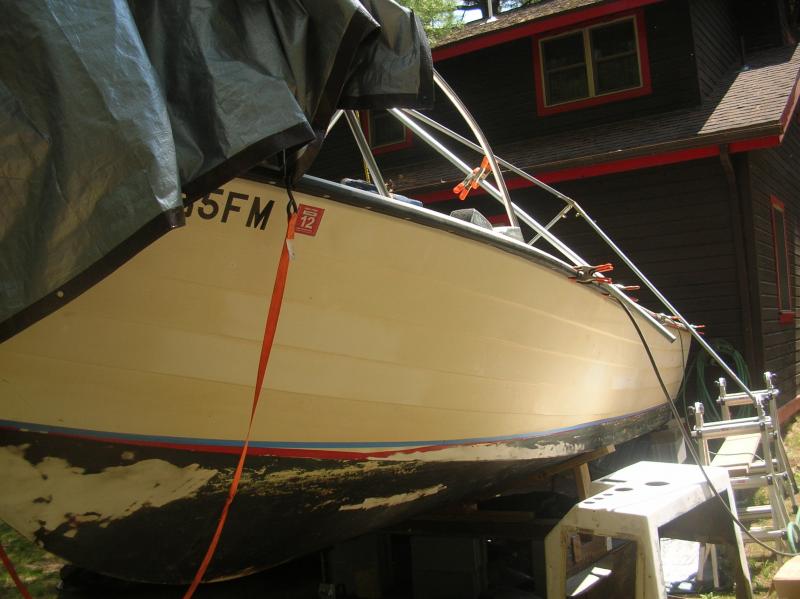

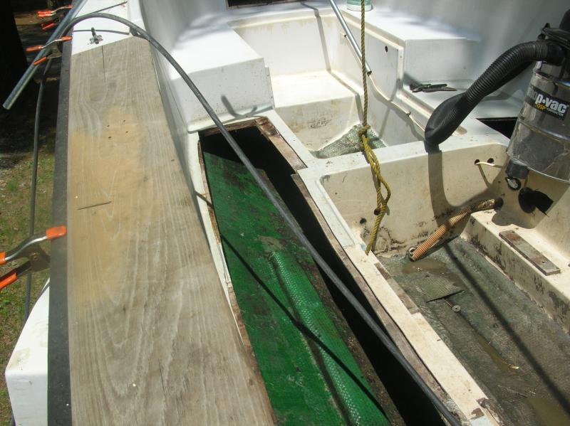

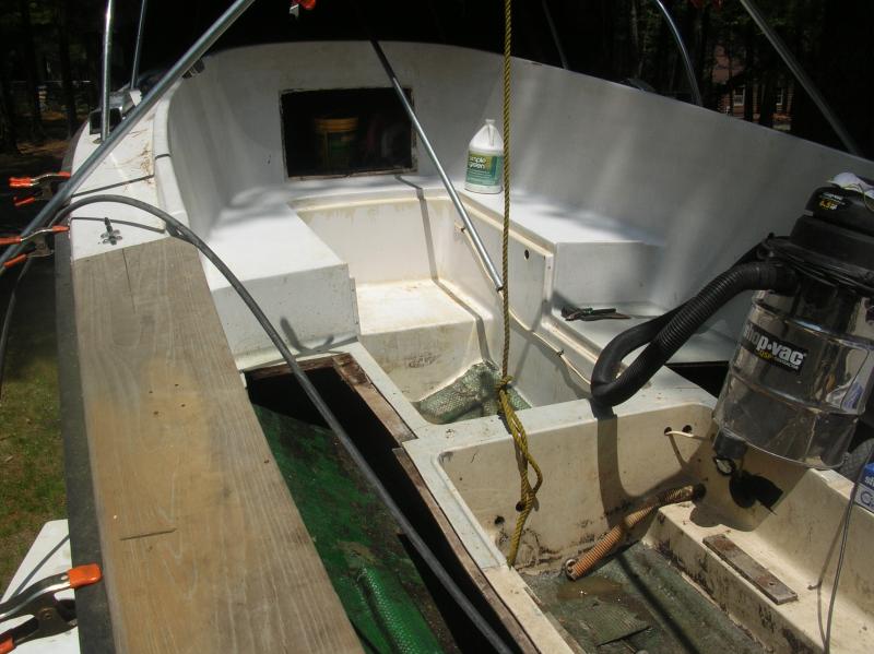

    Couple of pics
    This is the worst job, been 3 days degreasing and power washing. Hope to start rebuilding floors this week

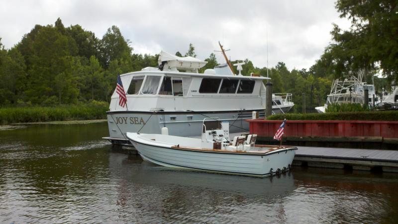

    22' Chris Craft Dory
    Still a work in progress, but getting there.......

    Hey DDw
    Looks fantastic, I see you did a white bottom what paint did you use, my wife wants your color scheme, clean and real sharp.
    Its great to see the efforts in restoring these classic hulls

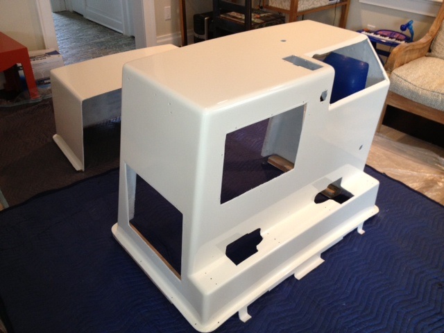

    Finally some signs of progress, after glassing and filling for the past few weeks....
    The console and engine cowling (and gas tank cover - not shown) are complete. After some minor glass repairs around the flange, this is two coats of Interlux Epoxy Prime Kote followed by three coats of Perfection - rolled and tipped. I was skeptical of the R&T application, but if your substrate is properly prepared - sanded flat, then the finish looks as good as spray - with proper technique (learned on the job) and the right thinning (again learned on the job) of coarse - the stuff is pretty amazing.
    I will post another pic when the hardware and windscreen have been replaced (the gauge panel is also new)

    chris craft
    The console and engine box look great!!!! At least your at the painting stages, I have a long way to go, Have to build a new motor box and a lot of repairs to console. So you like the Perfection epoxy, I'm still up in the air whether to use it or Awlgrip. I'm leaning towards the 545 primer since you can use it below water line.
