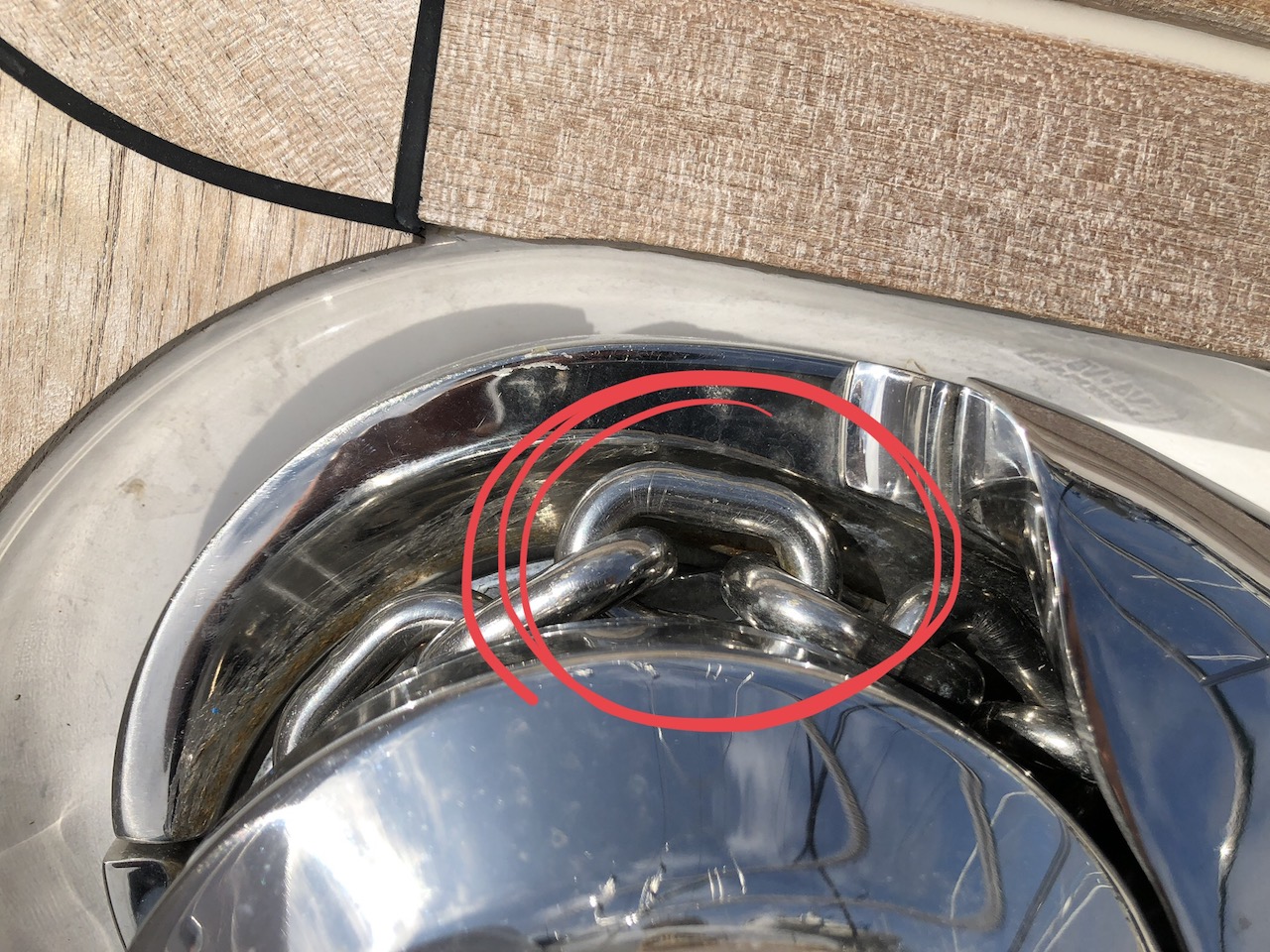

    Listing below most of the issues that we have encountered so far:

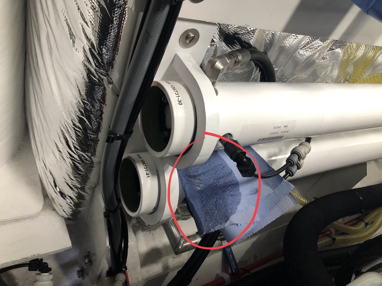

    2. Watermaker not working / Leaking after repair due to faulty membrane.

    8. Sea water flooding in Lazarette due to unplumbed watermaker brine pipe

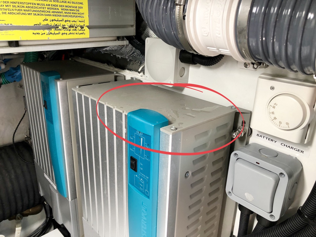

    11. Water leak from cockpit to engine room, water drip to inverters/chargers top section
    12. Failed Mastervolt combi inverter
    13. Inverter/Chargers derating/shutting down due to overheating/poor air circulation in Lazarette

    15. Damage caused by stainless steel chain mismatching windlass gipsie drum. Chain piling up and getting stuck in chain locker during anchor drop and recovery. Chain locker not draining. Chain counters on both stations not working. Wireless chain controller not working.

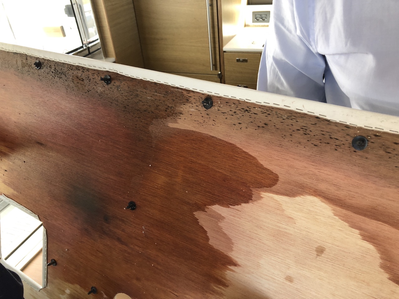

    1. Damaged ceiling falling down in Guest cabin

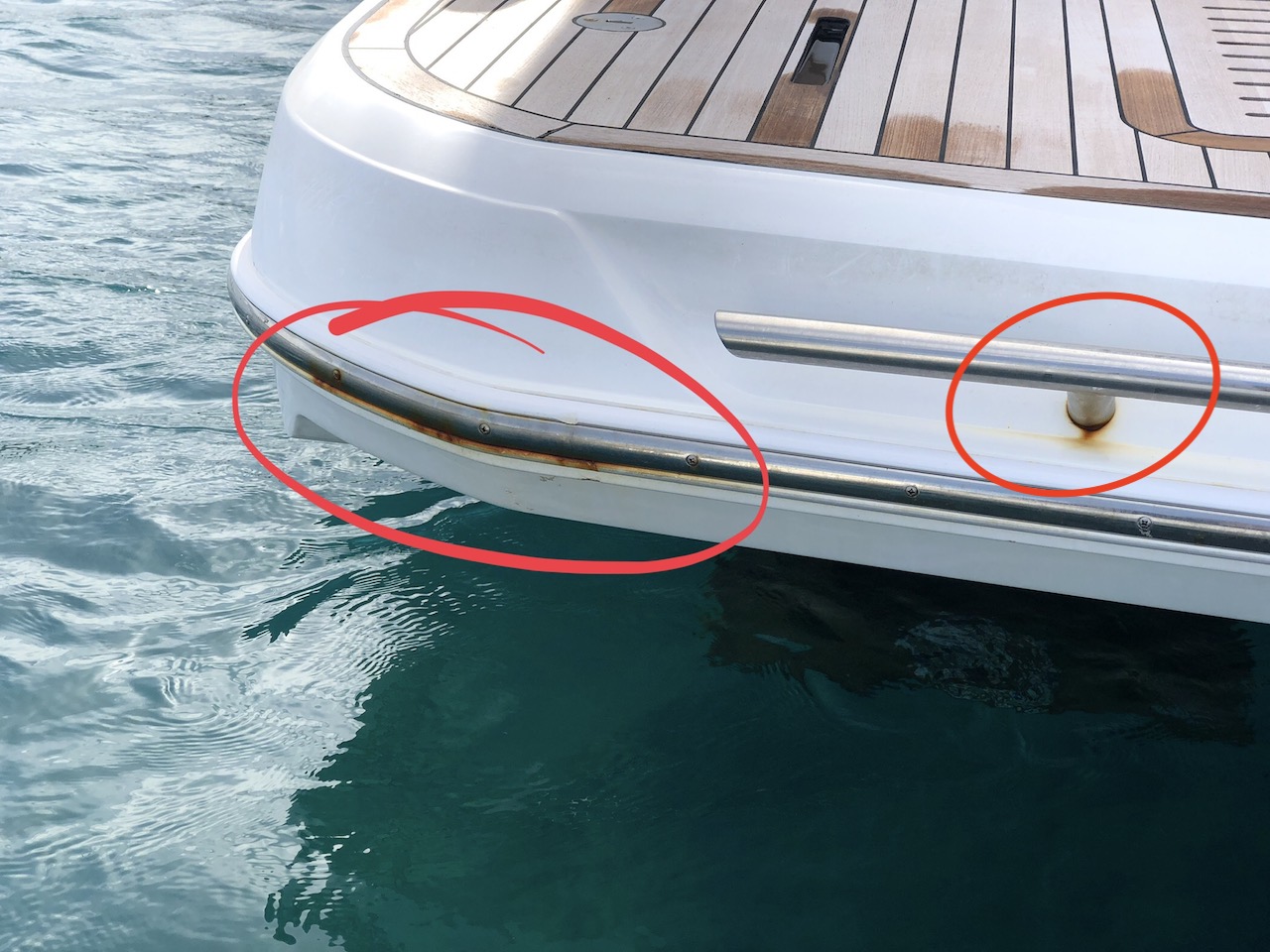

    22. Corroded screws/parts in 14 spots

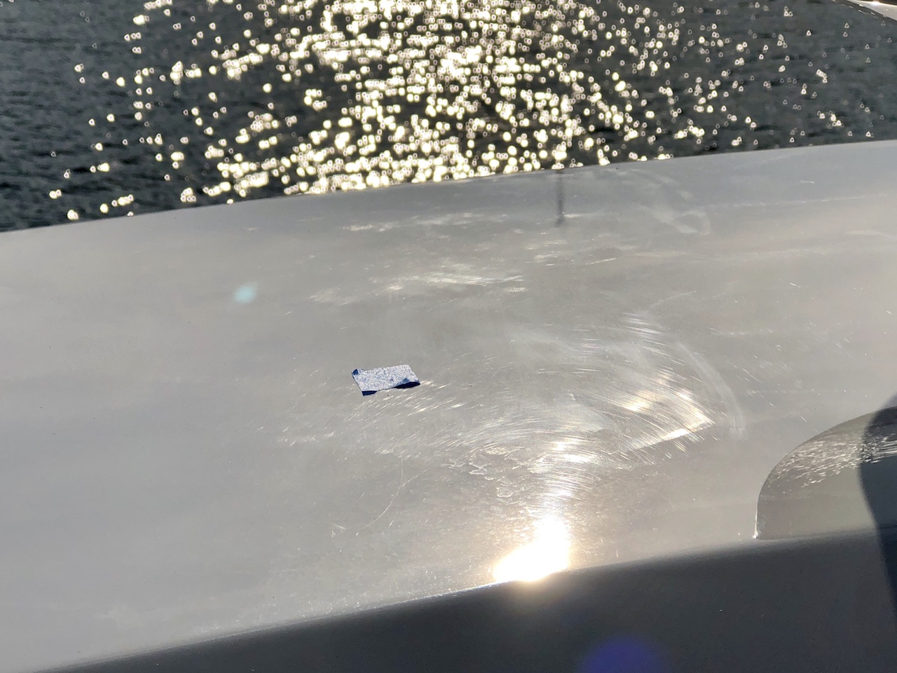

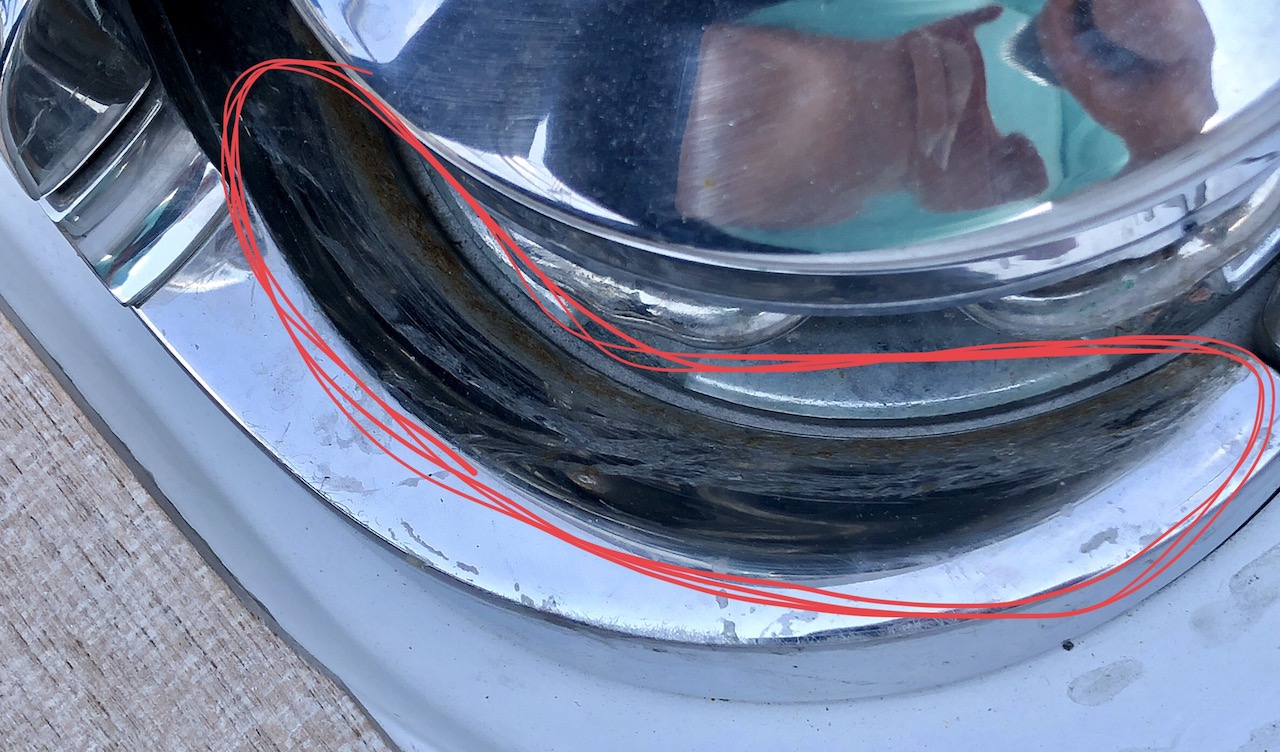

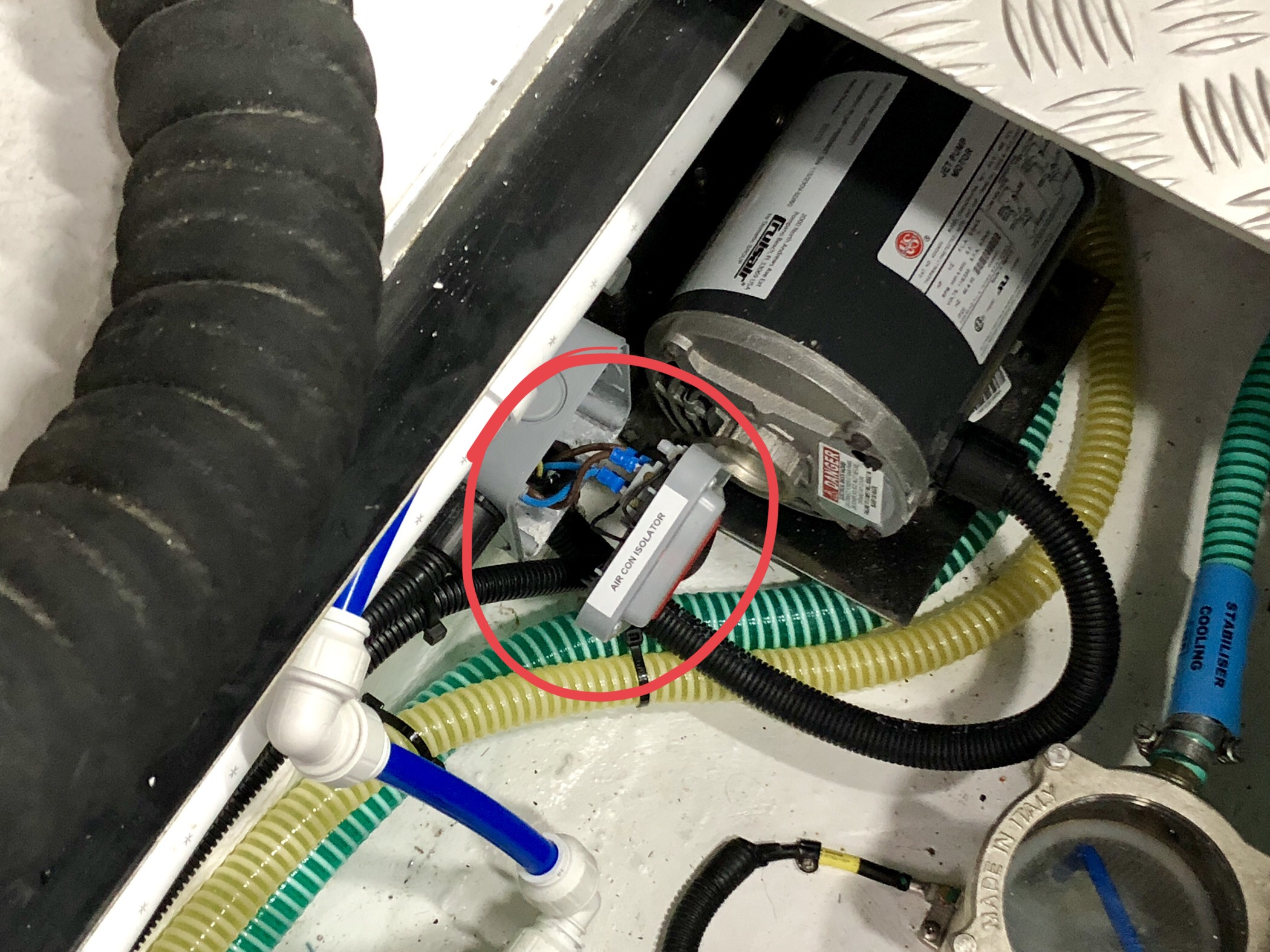

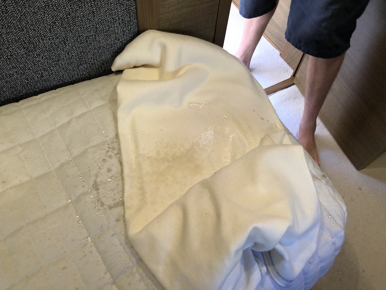

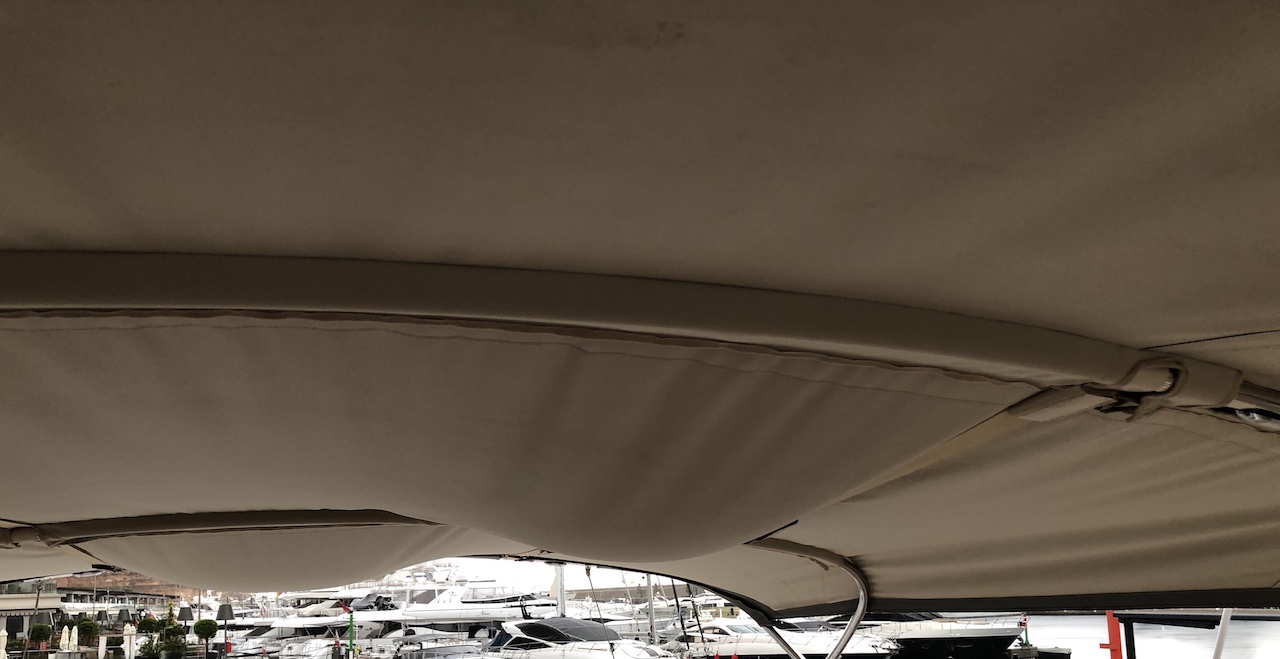

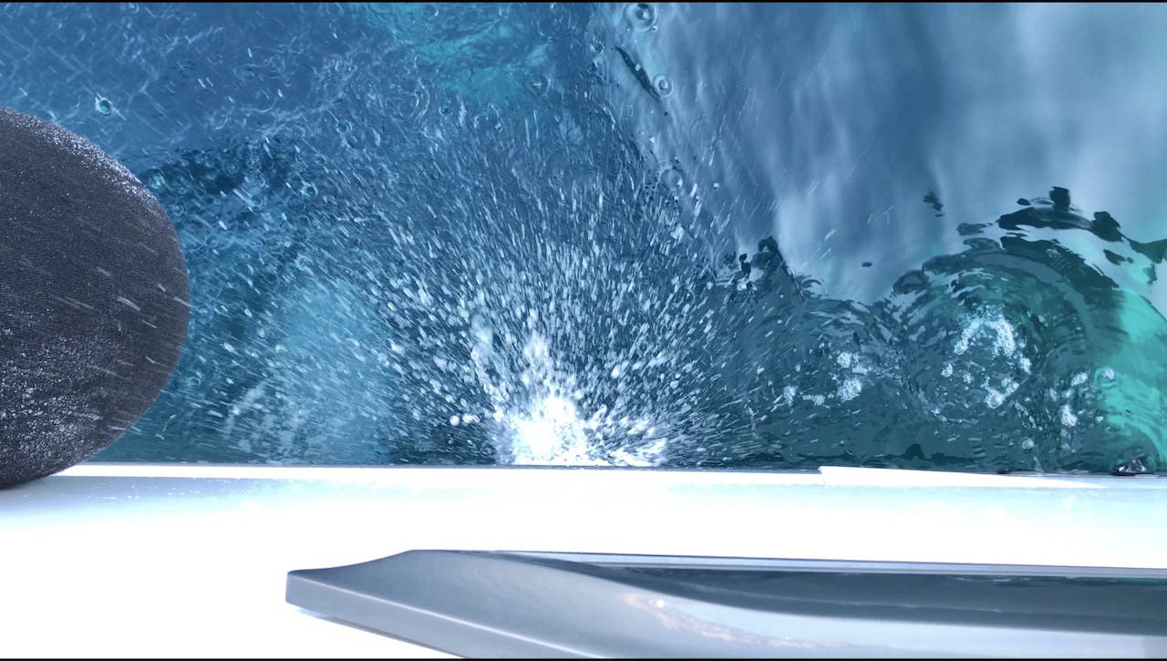

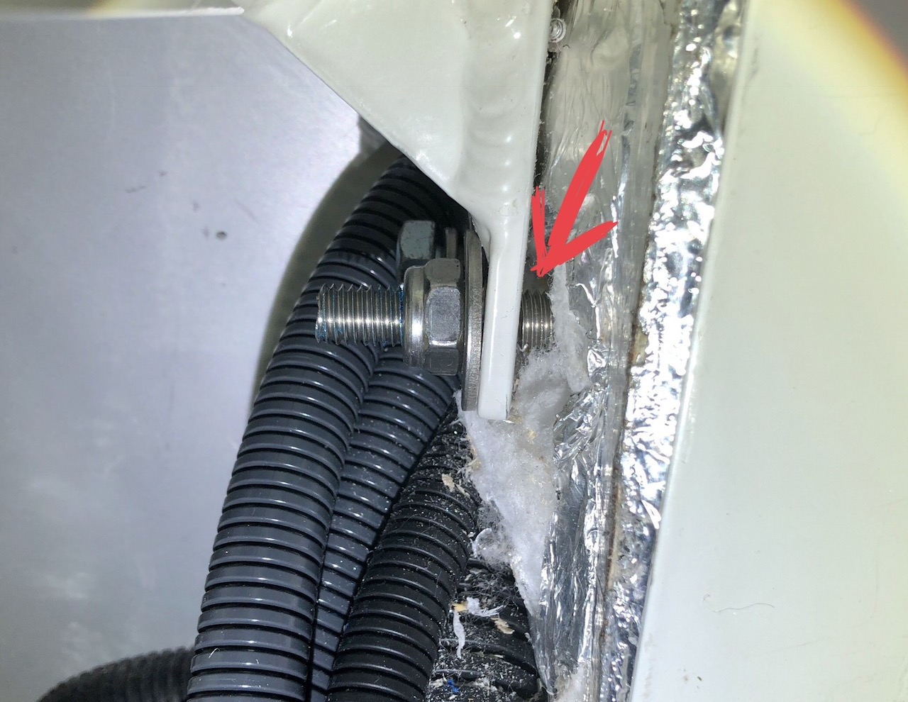

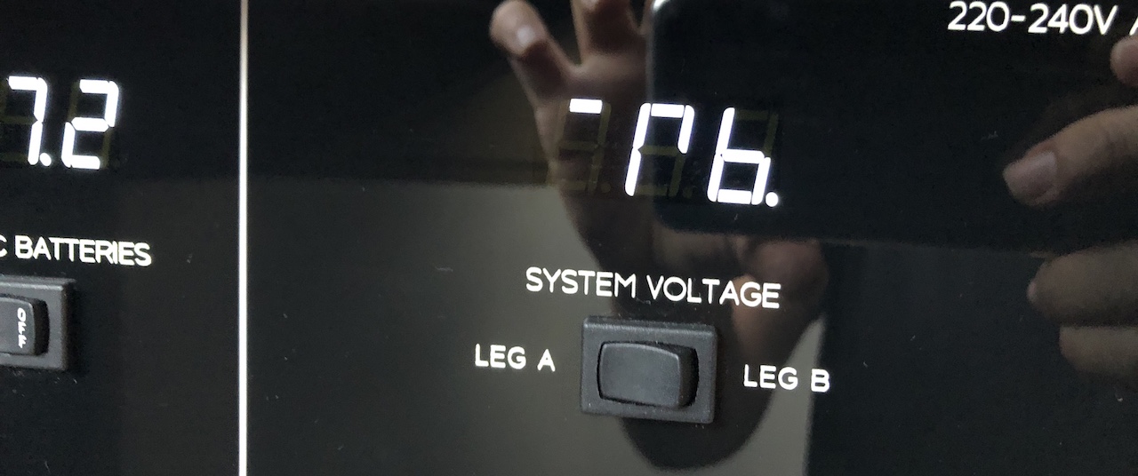

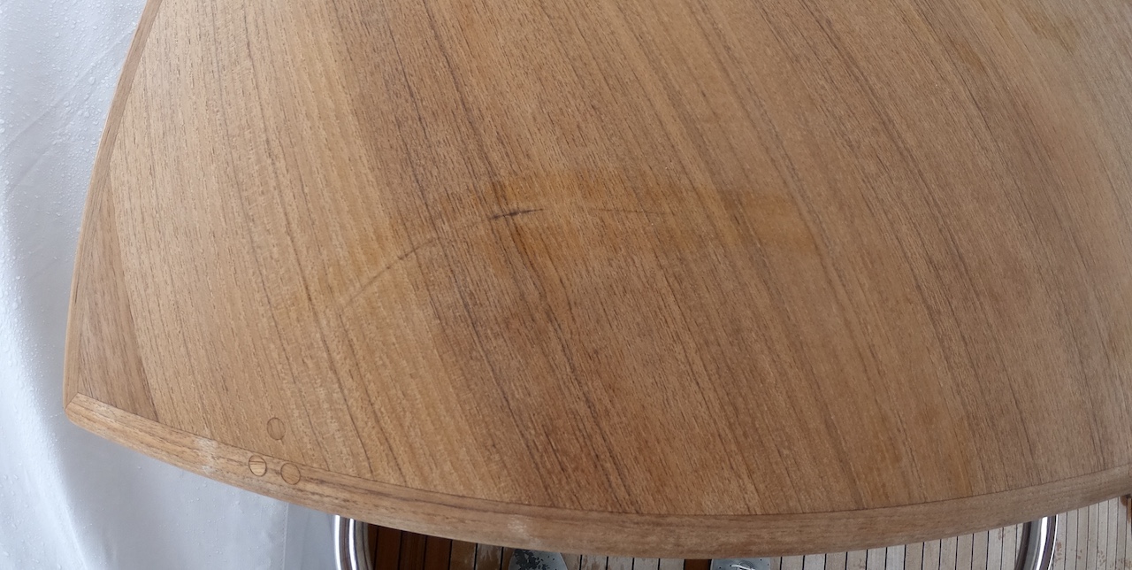

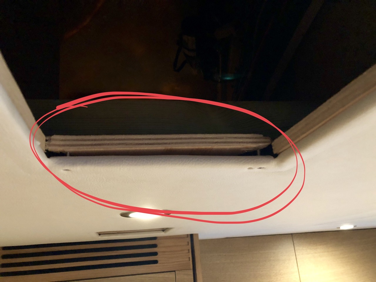

    Here are some pictures (Part 1)
    Admin Edit: As these pictures are oversize, you will need to click and open each pic to see the full extent of the issues.

    Part 2 IMG_1860.jpg IMG_1826.jpg IMG_1531.jpg IMG_1768.jpg IMG_1548.jpg IMG_1860.jpg IMG_1826.jpg IMG_1531.jpg IMG_1768.jpg IMG_1548.jpg
  11. Mikolebi
    Mikolebi New Member
    Jun 13, 2018
    13
    London

  14. Capt Ralph
    13,860
    That's a NEW boat?
    Time for the attorney's. Your supposed to be investing in a NEW ship.
    The damage from these issues will return in your future near and far.
    Mold and water stains are forever.
    The rust from that cleat will always return. Chances are, even a new cleat from the same vendor will rust also.
    In the last pic, is that dried salt in the open electric box?

    In just a few snapshots there are more issues than you may be are aware of. For instance, the corrugated hose on the Stabilizer Cooling side of the raw water strainer looks suspect. I would get a top notch Surveyor asap (if you haven't already) and go over the boat with a very fine eye for defects. Repeat - I would do this right away! I would go over every system in detail. I would also ask for proof/copies of the boats EU certification, has it been completed?
    Sorry, I meant CE Certification: https://www.nmma.org/certification/ce-certification
    Standard stuff for European builders, but with this lack of attention to detail, makes me wonder what else?
