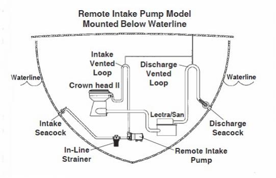

    There is no holding tank, due to the Raritan Crown head system, that works without holding tank (as far as I know).
  7. Capt Ralph
    13,880
    Your using the MSD1 Lectra-san system. Some boats still have a holding tank after the treatment station. A Y valve diverts to the tank or overboard.
    If the equipment works and in a discharge zone, life is good.
    However, Neighbors in a clear water marina or in a canal, still don't want to see it, even if it is treated.

    The older boats have ( had ) the 'Lectra-san units and were legal when they were manufactured.
    It is treatred twice in the system before getting the heave ho.
    Most are still legal as rcaps stated as long as you are not in a " no Discharge" zone.
    If you want to learn more then google lectrasan and check out the various units still for sale today.
    Also they are really good manufacturer to deal with if you need to return your lectrasan or toilet for repairs. They are also very helpful over the phone with troubleshooting.
