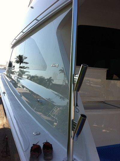

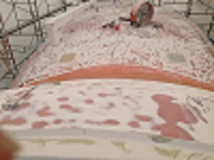

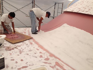

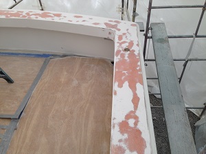

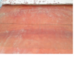

    Awl Fair and Awl Fair LW are epoxy based compounds that don't change properties for expansion, compression, thermal and tensile strength from minus 5 degrees to 68 degrees F. If the gel coat crazing is deep & severe enough that it extends down to the glass substrate than it really doesn't matter if your using a grinder with 40 grit or a 6 inch D.A. with 80 grit/ one method is a bit quicker than the other .
    The contractor that performed the work on the Viking took the gel coat down to bare glass where needed in large areas like the forward brow and then smaller areas from the rub rail up. They machine sanded all of the effected surfaces down to a few mils from going all the way to bare glass. The attached photos show the process. wherever you see the reddish color than that's bare glass. Any bare glass areas were coated with Hull Gard and then 545 sanded and then Awl Fair was applied and machine / long boarded smooth..
