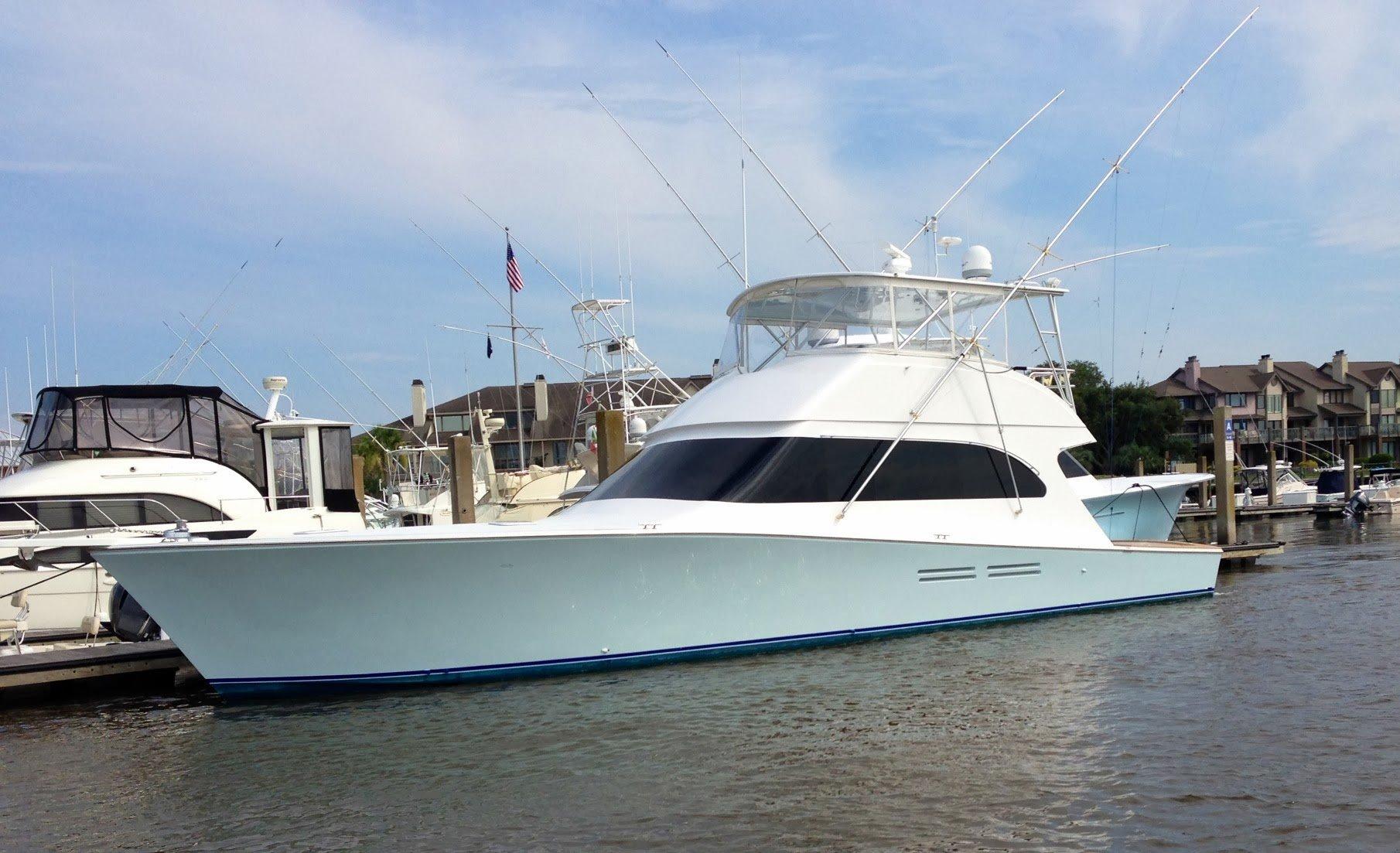

    So I am lining up a yard to redo my 2003 56.
    Having more and more cracks surface (CCP gelcote) and I am not seeing the shine come out of the gelcote without really going at it with compound and or wet sanding.
    I found this picture of a 2002 that was painted Ice Blue and Snow White.
    I really like the look. Having the mask done as well. Leaving the bow rail though.
    I'm torn between Ice Blue, and light blue( Ethereal Blue in Alexseal world)
    Painter wants to use Awlcraft 2000, I am leaning towards Alexseal.
    I know the Awlcraft 2000 is easier for the painter to apply, but the Alexseal is much harder and can be repaired unlike regular Awlgrip.
    What do you think?

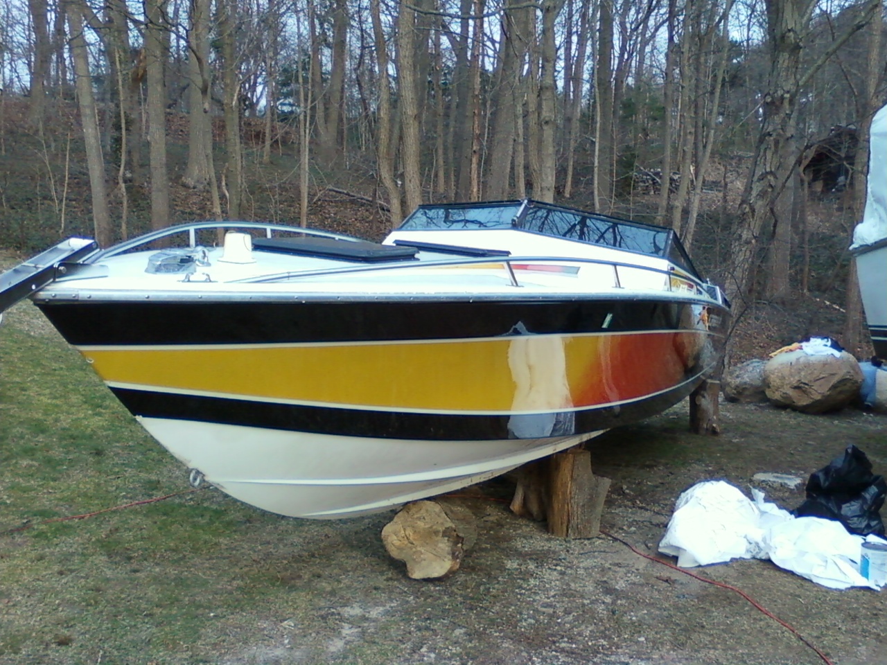

    I would still use marine grade Imron, it is easy to blend for any spot repairs. I wouldn't consider Awlgrip. Below is a picture of my Scarab that I painted in Imron about 1991, it still looks that good today. That pic I did take in 2010
