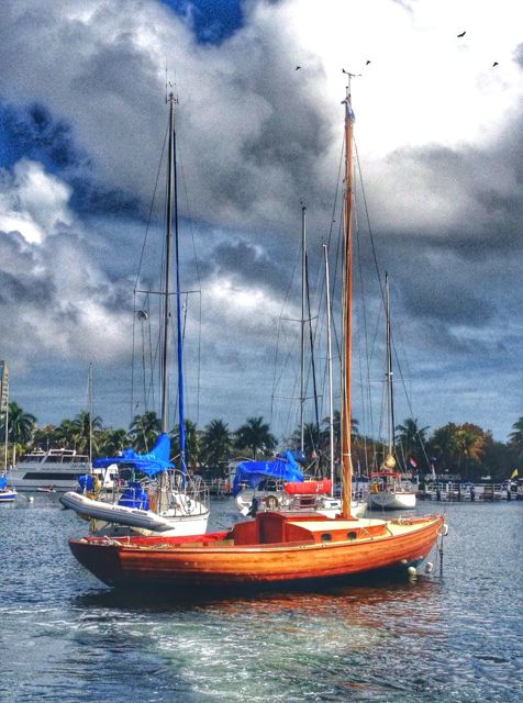

  3. Pascal

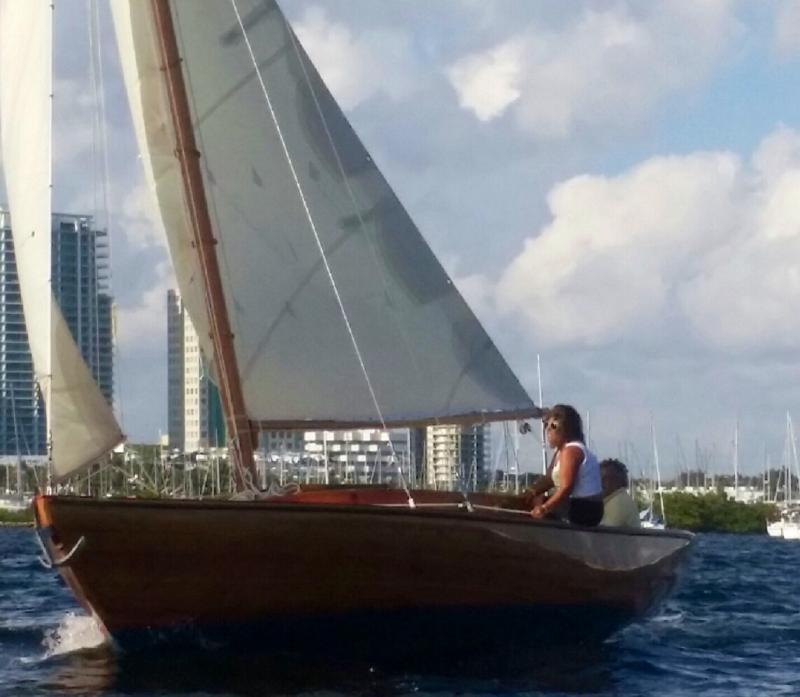

    Here are a few pictures taken today on the first sail!

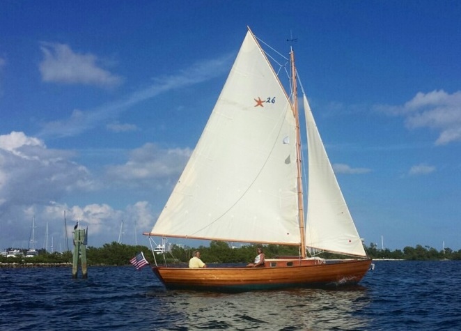

    Another shot

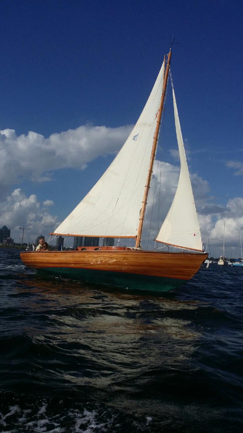

    Another one
