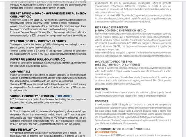

  19. Fiammetta42
    Fiammetta42 Member
    Sep 28, 2017
    130
    Liguria Italy ( boat )
    My boat was built for a Capri hotel owner to taxi guest about .So no AC .
    Great I thought a blank canvas .Previous boat a Sun squeaker has trad Domtech / cruise air kit self contained in each space .We hated them because of the racket .Yes been in visiting marinas in the Med where the shore power on the jetty used to trip or the conventional ac AC just couldn’t cope with meagre incoming supply .
    Sunseeker Fr sold the S/Skr .When I got the Itama back from Naples to Cannes I asked Sunseeker “ know any AC guys “ Answer that came back was an Italian ( with IT plated van ) working the south of France ripping out the factory fit stuff and retro fitting Frigomar .
    Bigger charter 80 s and 90 s etc have the same issues just scaled up .
    Super silent you can sleep .
    No start up spikes so no inadvertently shore power cut outs .
    Very low power requirement.
    Plenty of on line size calculators hovered around 27-29000 BTU for the boat a 14 M sports .
    They fitted a massive 42BTU chiller under a bunk in the rear cabin , it’s silent .Usual chillers in other spaces .
    To give you some idea we only have a 3.5 kv geny and it’s an all electric induction 3 place hob + a 80 Ah charger .
    I can run all three , that’s a 42K btu AC system as well as the other stuff on a geny that weighs 90 kg and is the original 2002 Mase .
    U tubes your friend plenty of vid on the tiny loads and min ramp up .
    As said the brushless D.C. motor has variable speed .No binary on off AC spikes .
  20. Fiammetta42
    Fiammetta42 Member
    Sep 28, 2017
    130
    From the Frigomar web site .
    It’s all correct in my experience.
