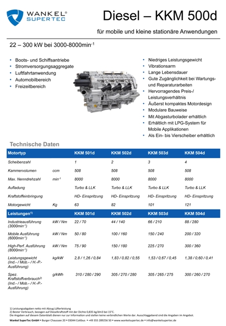

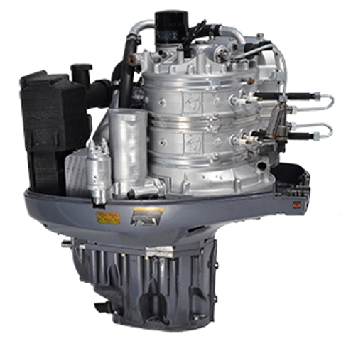

    Btw. Here is my Wankel Diesel outboard engine. Multi fuel (Diesel, petrol, Kerosin) vertically mounted, small and light. Tell me where to send the money :D !!!
    I will get in contact with them.

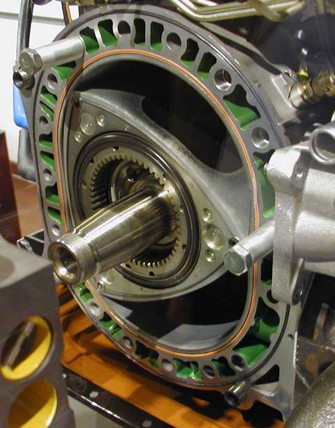

    The specific fuel consumption of a wankel engine is somewhat higher than with piston engines. With diesel engines, the difference is not that big. But the elimination of petrol stores on yachts and ships is worth it. The other advantage is the total absence of vibration at higher RPM and the very small size of the engine. Perfect for a outboard engine. My glider petrol Wankel engine gets quieter at increasing RPM and at full power (8000 RPM) it sounds like an electric motor.
    The key figure on long lasting Wankel engines is the internal air cooling of the triangular rotating piston. The engine itself is watercooled. The early Wankel engines had many problems with the piston seals (the equivalent of piston rings) in the corners of this triangular piston, because the oval combustion chamber (Epitrochoid) has a constant changing shape.
