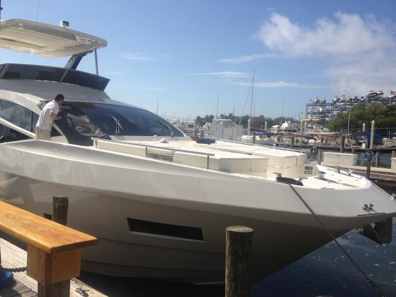

    This is a brand new Astondoa 72 fly. Aesthetics asides (not a bad looking boat overall) the design is just plain stupid. At first i thought the bow rail had not been installed yet but then realized there was not supposed to be a bow rail! So, how do you safely tend to the lines or handle any anchor related issue?
    Notice how the bow line rubs on the gelcoat when attached to a low dock... Of may be you need to use those small cleats, must be called bow whiskers, but you d have to lay down on the foredeck to reach them.
    Same amidship where the guy is standing, no rail, nothing to grab on. Just knee high coaming
    And, no rub rail anywhere! May be fine in the med but here in America where 80% of marinas have wooden pilings, you need 3 deck hands just to protect the gelcoat. Then if you look closely, you see that there is a caulk line at the hull/deck joint right where it will rub on a piling
    Brilliant... I d love to see that boat (and the maintenance bills) three year from now!
    And having the stereo controls sitting in the sun and spray is guaranteed to keep the local stereo guy busy...

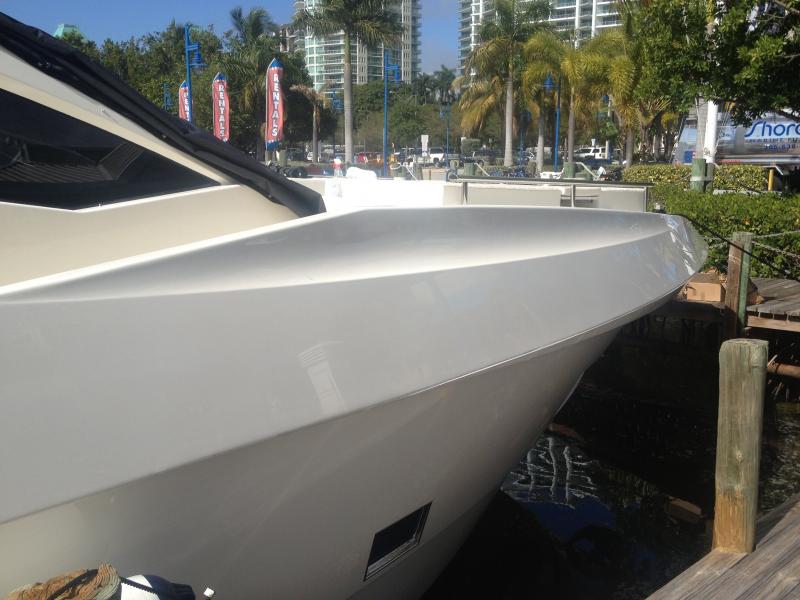

  2. Pascal
    8,860
    Here is a close up of the hull/deck joint...

    Is it possible that there is supposed to be some sort of rub rail/guard installed over the seam where the two pieces join, but that it was left off due to it being hull #1 or some colossal error in judgement on the part of the build team?
  5. Yacht News
    30,185
    The cleats on the bow tip is what has me. Anytime you have to lean that far over for something as utilitarian as a cleat that you sure will be using everytime you dock and not be potentially safe doing it, it's not in the best interest of the crew.

    It appears the bow line is supposed to go thru the smaller "bow cleats" and up to the bollards where the line is secured now in the pic ... see the protection rails in front of the "bow cleats" and then another protection rail on the way to the bollards? The line as it is secured to the bollard now is not correct IMHO. Those are not "bow cleats" or "bow whiskers" but instead keep the line where it's supposed to be so it does not rub the gel-coat.
  12. Pascal
    8,860
    The forward cleats are more like chocks, guides for the lines which is fine but in order to the lines thru it you have the get up on that raised area, get on your knees and reach over with nothing to grab on!
    So happens when you have to stop the boat while your crew is up there? Happened to me a few days ago... coming in, my GF was setting up the lines while some idiot In a 30 CC cut us off forcing me to stop the boat. She grabbed on the railing, no problem. Had there been no railing she might have ended up in the drink

    And it you look closely, the stereo controls are right there at the bow, in the sun and spray... I wonder how long they will last :)
    But I bet it has nice drink holders and flatscreens thruout.
