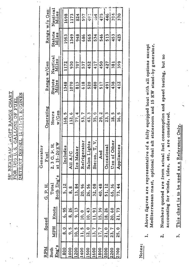

  14. Capt Ralph
    14,578
    Were a good bit heavier than your 55. But this may be a helpful guide.

    How much does your Bertram weigh? I would have guessed the Hatt would be heavier; shaving a little off my 56MY, I'd guess the Hatt 55SF at around 70-72,ooo with fuel and water and not much else. Your speed/RPM numbers are close to mine, (650hp 8v92ti) but just tad higher.
  17. Capt Ralph
    14,578
    The specs are;
    65000 base dry, 87500 loaded & wet. Were also 18 wide.
    Deep V and floating, draws 5.5 feet.
    Were live-a-boards with clothes, tools, spares and 3 kats. Also bridge hard top, second gen-set and lots more batteries.
    Been on for over 12 years now. lots of stuff (junk).
    It takes a while to make the last couple of knots, but that sheet is not to far off.
    We have only seen 2300 a couple of times, usually near bingo. We can turn 2200, 2225 sometimes 2250 in reasonable time.
    Were LSD and only push these old DDs when the inlets are bad and once a day (long runs) to blow some slobber out.
    Yes, your 650 hp - 92s, should turn the same numbers under load. You should be moving faster at the top.
