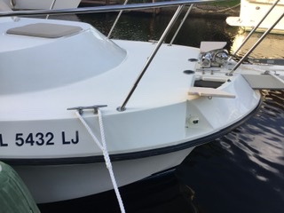

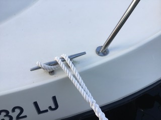

    Many different ways of skinny a cat:
    This is the easiest.
    A3D9A995-4A7B-4339-BC1C-A17B00B5A8E7.jpeg F5F16B6B-4F2C-4499-92C1-80A4D2484116.jpeg
    Then you change it to avoid chafe and avoid jumping line
