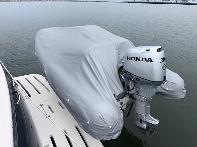

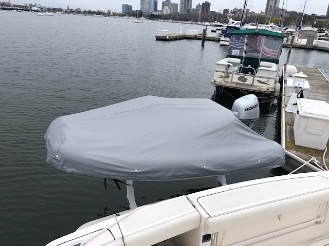

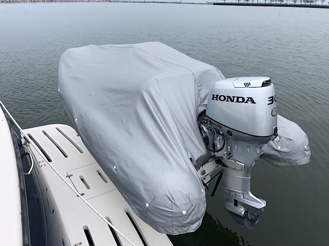

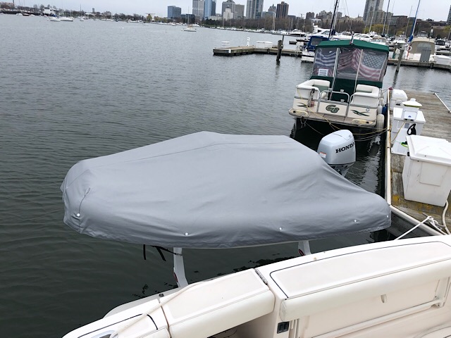

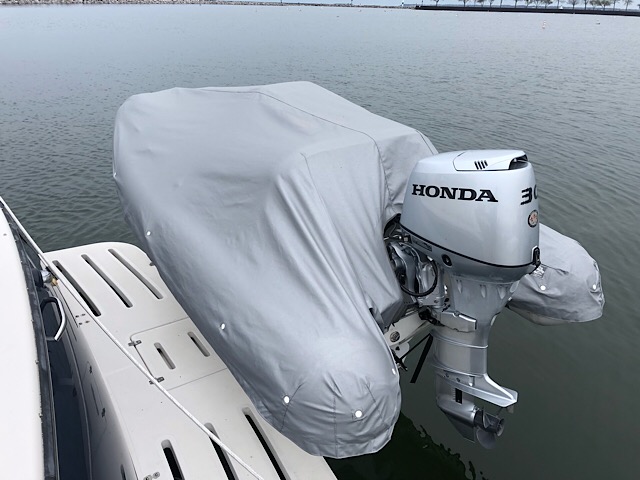

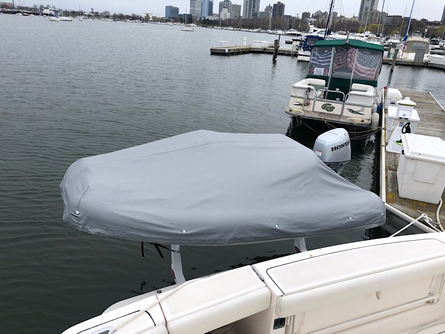

    I stopped at the boat for a quick second when I flew in on Saturday. Pics of dinghy cover below. I was pleased that we didn't need to install posts etc to shed water. It is secured with compression straps/hooks that fasten to the dingy rub rail and 2 snaps on the transom. It has stood up fine to windy days etc however I don't generally run with it on as the one time I did (25kt winds on the beam, 29kt boat speed) it was getting some air under it and made me nervous. If I were to do it again, I would likely either add a few removable straps that further secure it and/or remove some of the excess material around the edges to make it less susceptible to wind. I may also have the canvas guy that made it sew in a "half moon" zipper that would give me access without having to remove the entire cover.
