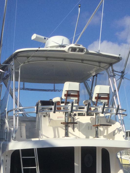

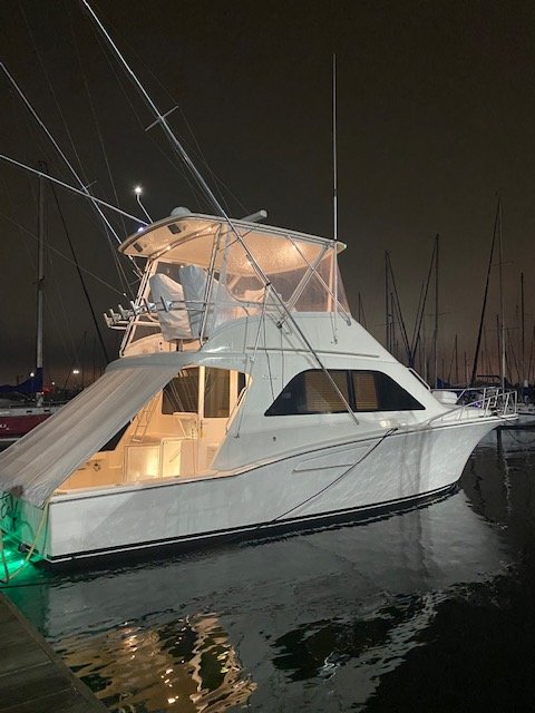

    was wondering where to find a replacement White Navigation Light (LED? or normal filament bulb) above the spreader lights? I'm 1400 miles away from boat so.. unable to go check personally.
  2. Capt Ralph
    12,736
    That looks like a Festoon lamp. 12 or 24Vdc. Replacement lamps do come in LED.
    There are 2 maybe 3 different lengths. You will know for sure when the yard (risk their neck) grabs the bulb.

    it looks like a "normal" Perko anchor light with a festoon bulb but the spreader/nav light looks like a ??? and that is the one (nav light) that is inop.. i believe that tower from pipe welders in fll?
  4. Capt Ralph
    12,736
    Is the ole pole just an anchor light?I noticed the built in lights. Figured the slot was a vent. I couldn't figure a nice built in light with an ole stick over it all.
    Where is your steaming light? In that stick or builtin the top?
    Someone will know for sure with the old lamp in their hand.
  5. Capt J
    14,434
    The masthead/anchor light looks normal Perko.
    The stern light directly above the spreader lights is a special piece. Looks like you have a 35' or 40' Cabo. Check with Pipewelders in Fort Lauderdale to see who they sourced the light from as it looks to be one of their hardtops.

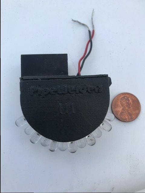

    sent an email.. awaiting reply. possible any other options? upload_2020-1-19_7-50-12.jpeg upload_2020-1-19_7-50-12.jpeg

    It would be interesting to see the guts to that, but it's probably potted with epoxy or silicone. I can think of at least four ways to make that, if it had to be done. None are cost-effective:(
    Has that completely failed? If Pipewelders doesn't have it, any longer, you might be able to use one of THESE or something like it. Flexible with self adhesive, and maybe be able to stack two or more in there for more light.

    good news for those that need a replacement for Pipewelders LED navigation lights:
    Red Port side: 1485826
    Green Stbd side: 1485825
    White Stern light: 1485827
    $85 dollars ea.
