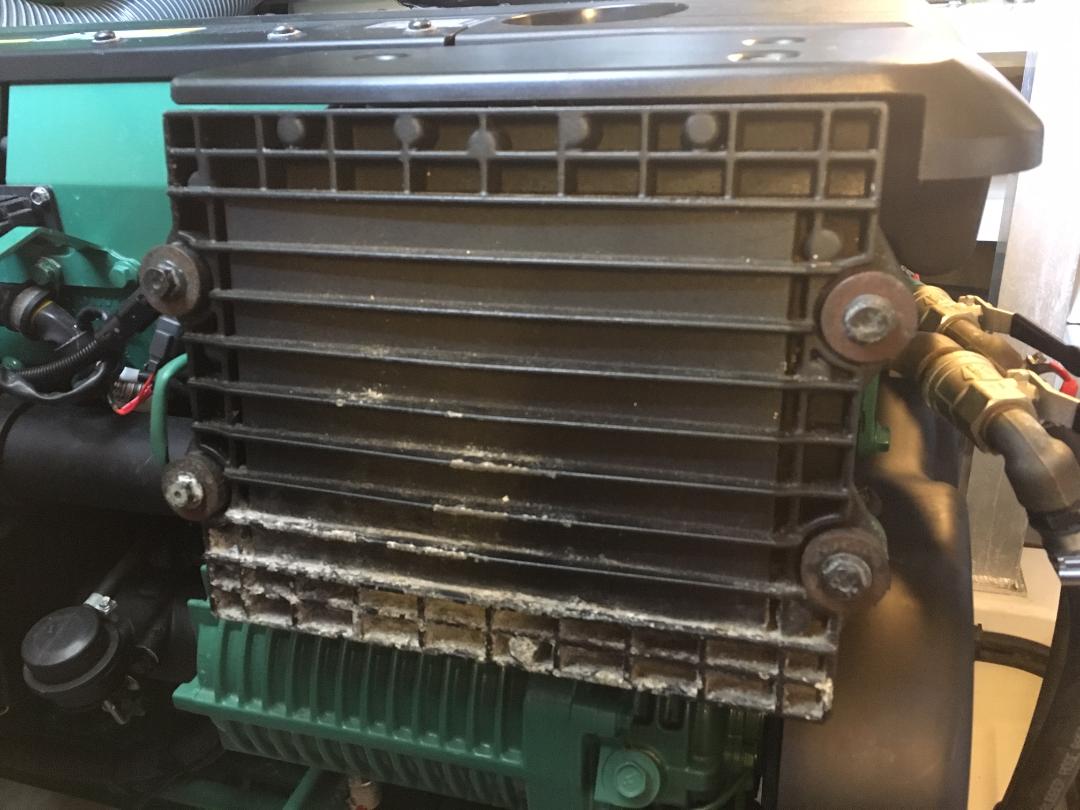

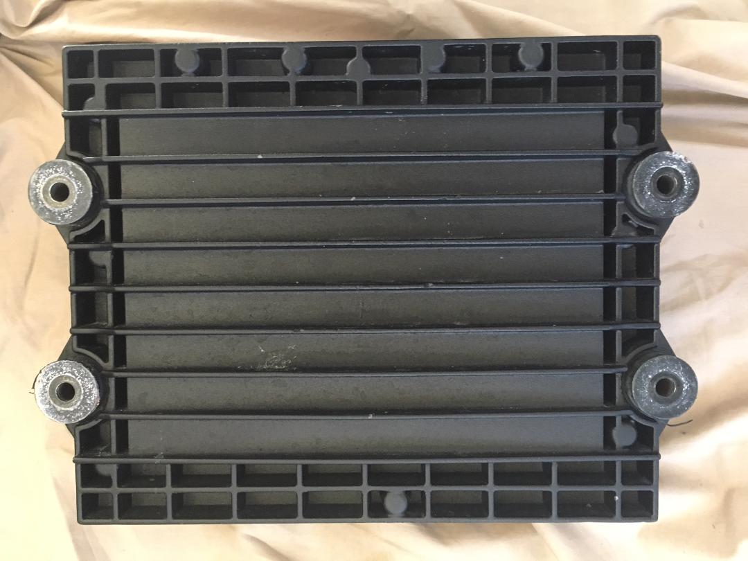

    And lastly does these pictures even look like a new ECM? We were told the ECM the tech replaced my original ECM with is new. Plate is corroded and looks to have been submerged. We are being told by the company the tech installed a new ECM but instead of putting on my old Plate (that actually looks new compared to the plate that is on the new ECM) he just put this old corroded plate on it.
    10)why would someone install an old submerged rusted/corroded plate on a new out of the box ECM? Why wouldn't they just put my plate that is newer on the new ECM?
    11) how does an ECM come when it's new? Does it come in a closed box without or with an installed plate?

    The computer has A LOT of visible corrosion on the outside of the case. I cannot believe that the inside wasn't negatively effected. Batteries can create A LOT of CPU issues with modern diesels...….I know on a MAN common rail boat I manage that goes through batteries every 2.5 years when a battery bank is going bad because the computer starts spitting out a communication EDC failure alarm on start up. Always change all batteries at the same time in modern electronic diesel boats. I would speak to the owner of the dealership and go from there. 4 different techs is a bit crazy......2 yes......4 wow.
    That's the replacement ECM. FM or in common text WTF??

    Supposedly what you see that is rusted and corroded is a plate that attaches and protects the ECM. the ECM is under it and connects to the pins and engine and electrical that you can't see. They are saying they installed a new ECM but the plate they used was an old one. I just can't understand why anyone would do that to a new ECM especially when I had a pretty good plate in better condition that was removed so that the new ECM could be installed. info
    doesn't line up.
