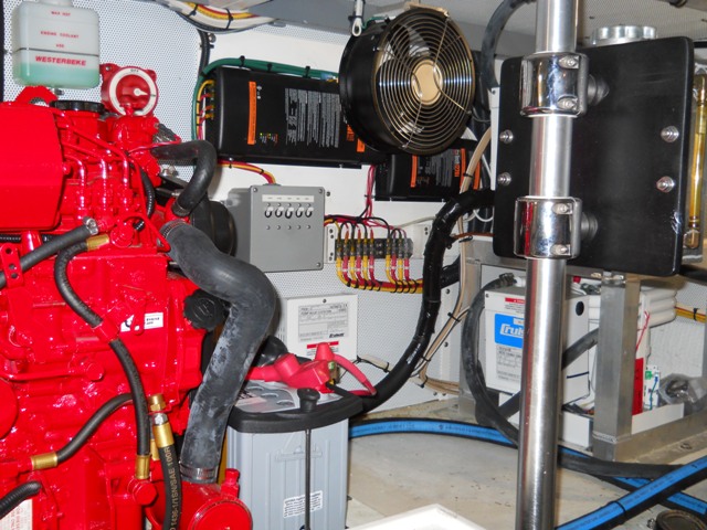

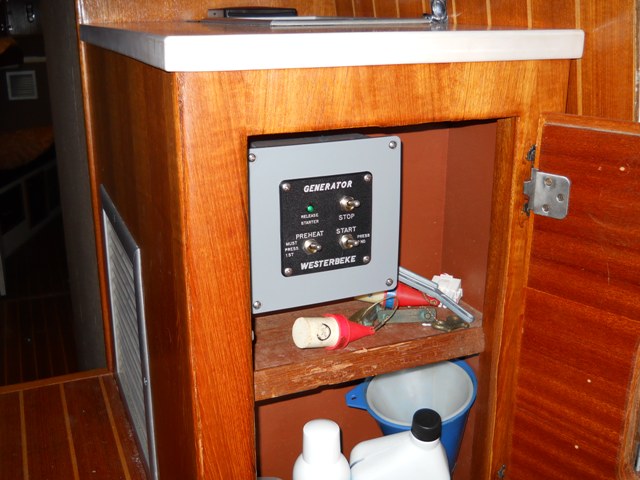

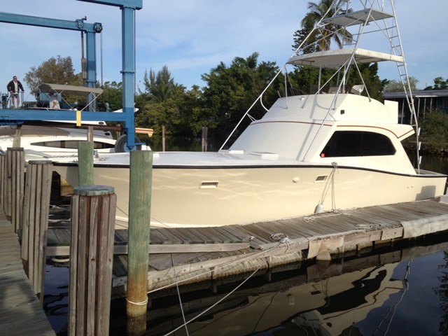

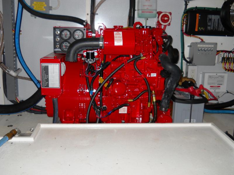

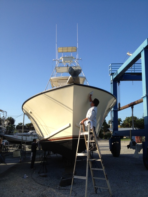

    OK - here's some photos of updates since last posting any pictures.

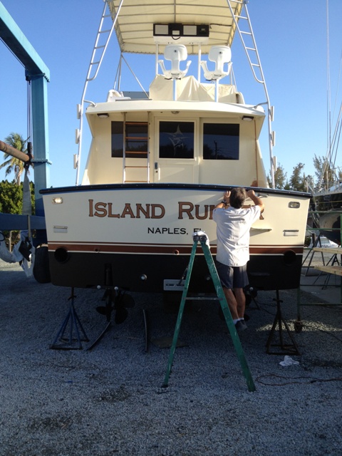

    Last haulout back in the spring of this year (2012) I finally installed a new genset and also replaced the old wood rubrail with the one shown.

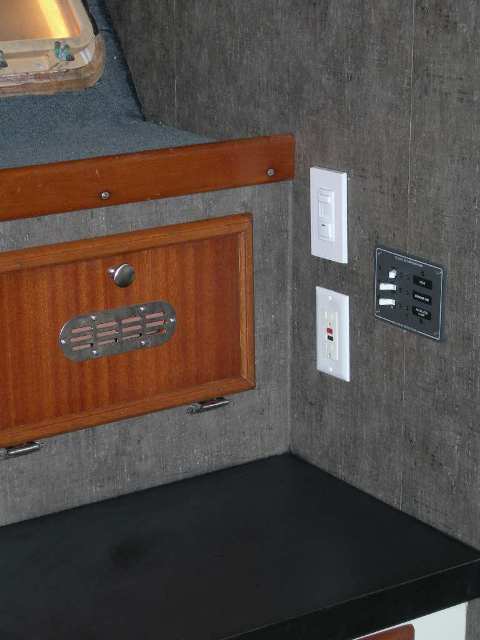

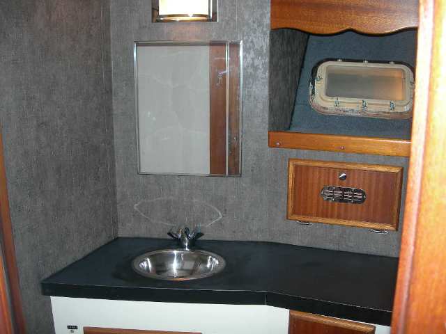

    I have most of the renovations completed on the head.

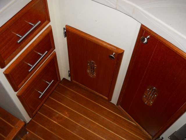

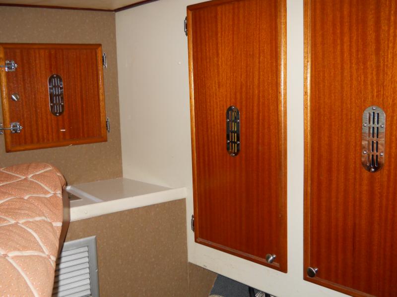

    I removed all the doors and installed new hardware. I never did like the handles in the middle of the doors so I removed them and cut ventilation openings in each door and covered it with the SS vent shown. New hinges, new knobs and new handles on the drawers throughout the boat. (There are a LOT of drawers and doors.....)

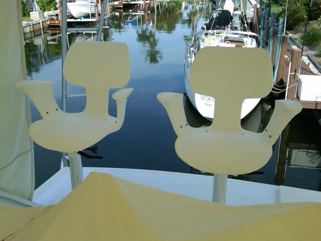

    Installed two new Pompanette helm chairs on Pompanette 27 inch pedistals. Companion seat required some glass work to build up a level surface due to the camber of the deck. It's never as easy as it looks......

    rc, I intend to have a railing up there on the flybridge but have held off because what I really would like to do is replace the old Pipewelders tower with a new hardtop. Then the railing would part of the new hardtop pipework. I got a quote on a railing a few years back for something 2 grand +/- and I don't want to invest that much money if I just end up scrapping the whole thing. On the other hand a new hardtop will be pretty big $$ so until I resolve that in my mind I am just very careful up there.
