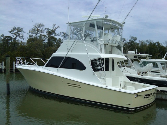

    Island Runner great thread. Thanks for sharing the pics. That is one hot looking Post. Your wiring makes me say "wow". If I was shown the pic of the wiring and nothing else I'd assume I was looking at a new sportfish. I know your planning on replacing the bow rails but I must say she looks great without them as you have it now. The argument for with vs without is endless but I'm a big fan of no bow rails. Eitherway she'll look awsome and very nice work indeed!

    Thanks Hattsoff. I prefer the look of no railings and I even like the look of no bow platform and the anchor tucked away in a locker out of sight. But with the way I use the boat and the fishing I do a railing would give some added security in working the bow. In our part of the Gulf of Mexico we do a lot of bottom fishing for snapper and grouper and the best tactic is often to anchor up near a wreck or structure and chum up the fish. The Gulf is so shallow here we can run out 25 miles and be in no more than 60 feet of water (!). Asking someone (usually me) to go out on the bow and take off the safety cable to lower the anchor and then cleat off the rope after the scope has been let out can be daunting in anything more than a flat calm with no railing to hang on to. So I plan to sacrifice form for function and put a new railing on when the budget allows. I also need new handrails on the house to hang onto when going forward on the narrow side decks. I removed the old ones because I didn't like the looks of them but something is needed there.
    There was a bow railing when I bought the boat, a stainless steel one with clunky "T" fittings and socket bases that looked rather shabby. And the bow platform was enormous. You can see from the photos I still have a pretty long platform jutting off the bow and that's after I cut off approx. 3 feet of platform! The original platform was so long there were supports under the platform running back to the stem on both port and starboard with a cross brace between them. They are all gone now and I am happy with the end result. I tapered the platform sides to add an aesthetic touch and the anchor roller is working well.

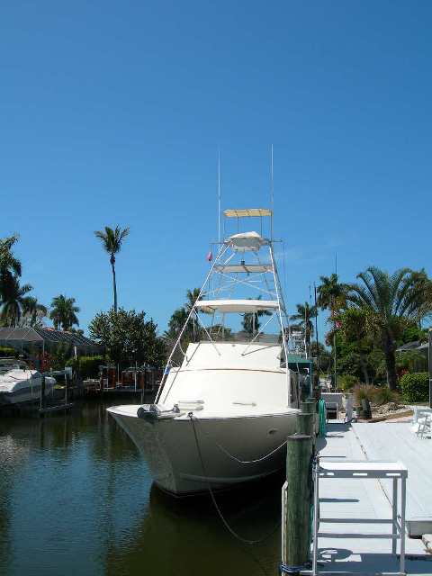

    Holy Cow! That's a great photo! I had no idea those old swordfish boats had bowsprits THAT long!
    Thanks for sharing!

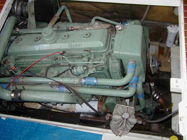

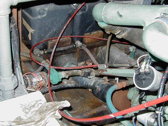

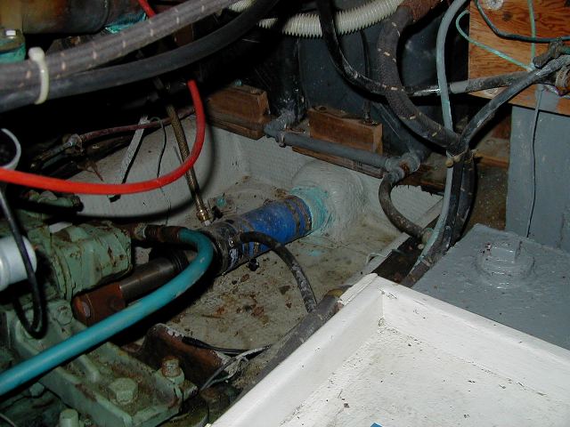

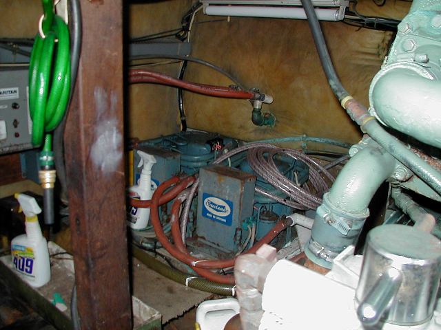

    I don't want to wear out the forum with my boat but here are a few "before" photos to accompany the "after" photos already posted.
    If you spend much time looking at broker's listings of old Posts you see very few engine room photos. I think this is why.......

    It is one thing to comment on your great work, but once I looked at the "before" images I ask, how about the courage to start such a project!
