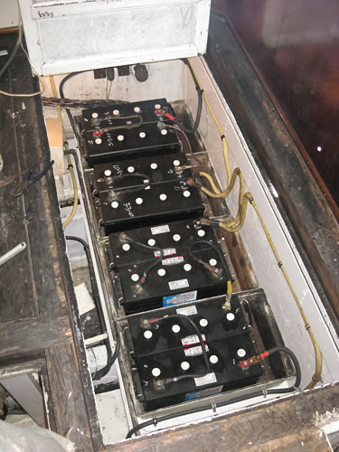

    Just got back from my battery guy's store, he is able to supply me with Interstate 4 D batteries 8 vdc, 560ampsfor $100 ea, he also has tractor battery about half the size
    8 vdc 560 amp:rolleyes: s for $95.00 ... Any comment from those who might know. I have always been under the impression that electricity is magic, and have avoid it.
  2. Joe... check on the 8V195's which are probably the correct units. Smaller batteries wont handle the start load on the internal connections for very long! ws

    Have 8 v 71's. instinct is to go with the 4 d's ..Next.. Replacement charger/inverter..

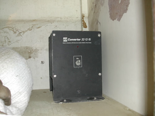

    Still wondering about 12vdc for GPS, RADIO, DEPTH SOUNDER ETC. I guess a fall back short term is having individual step down units using s cig lighter correction.
    Thanx to all your valuable feedback.
  4. My Hatteras has a 32 vdc system with several step down converters for electronics etc. Noting the condition of the wiring when I bought the boat, I eliminated them and mounted an 8D 12 volt battery. The new heads are 12 volt as well. The battery is on an impromptu charger while on shore power only, and its a winter project coming up to mount a 12 volt 1 wire alternator to one of the mains. ws

    We have our batteries configured in two ranks of four 8V Dekas Port and Starboard of the 8V 71N DDs and two 12V batteries to handle the electronics. While our Kohler 7.5KW generator runs the charger for the 12VDC system, it has gone south for the Summer (along with most of the repairmen in the area) and that negates using the radar or any other heavy draw 12V item. What kind of one wire alternator would you recommend and how could I find instructions for such a setup?

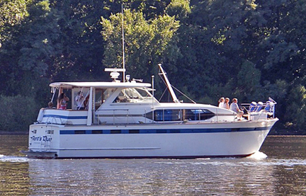

    In the past someone had asked to see a picture of our 1968 46' Roamer Riviera underway... one of my former students took one on Friday last and here it is:

    Nice picture!!! Just added it my desktop.. I am looking forward to have my 1969 46 underway soon. Hoping the existing battery charger is in working order. I have been searching the net for alternatives. For a new system and 12 vdc power source. Your comments have been valuable.

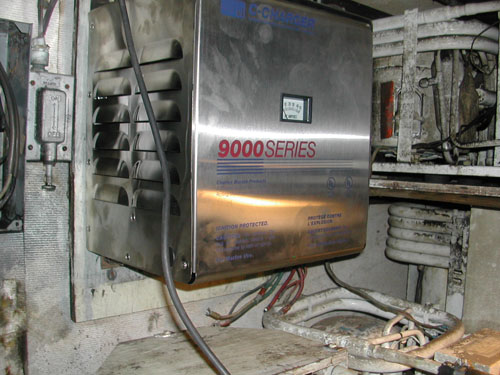

    In an effort to be prepared I have purchased a 32vdc charger, I really don't know if the one on board is functional, but in any event it is old and looks very worn. I have purchased a CHARLES series 9000 - ci 3230A, three bank from Charles it is a factory rebuild and come with a war. it was $532.50. I am hoping that the 30amp is ample for 8 ea 4d's.
    Appreciate input regarding this unit.
    Thanx -
  11. $532 Is cheap for the 9000, mine was about 800+ in '06. I bought that and 8 new batteries and the system is still performing perfectly as of this morning. Period. All you need to do is keep the batteries full of water and clean. Another period! Guys will bash you about the F-R type of chargers, but thems the ones that have the mechanics come down and change their fuel filters! The new charger and the old one(s) when I bought the boat as a recovery project! ws
