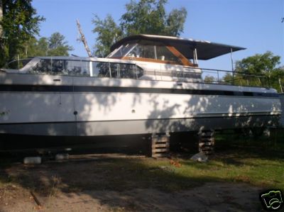

    In the process of closing on my new purchase, a 1969 46" steel Roamer. Love the boat and VERY EXCITED about getting herf ready. Last project was a 1972 Grand Banks Alaskan, 49"with 2 Deutz eng. Bought her in 2000 and sold her 2005. Trying to get my arms around the CC 32volt electrical. It appears 4 hd batteries are hard to come by, any suggestions appreciated. I am impressed by the Web Site, certainly as good as the Grand Banks Forum.
    Hope to learn from the old timers here. Good luck to all.:)

    Now Bill, you know they don't go for that cross-forum linking thing here. fer shame, fer shame, fer shame. lol
    I have two 32v banks on my Connie; my 1968 Roamer 46 was 12v from the factory. Do you have 8-71s, JOE.B?
    8V batteries are out there--Deka makes them. You can also build a set with Rolls. I've been running Sam's Club 8v golf carts in my Connie since 2006--two banks that I parallel for engine starting. It's not absolutely necessary to parallel them, but given that they're GC batts (i.e. not specifically made for starting) I figure sharing the load is a good thing.
    If memory serves, they were <$400 per bank. Keep the water topped up and they seem to last pretty well.

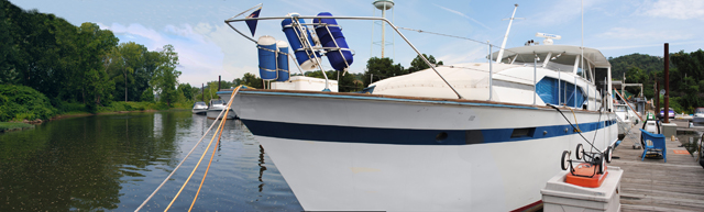

    New picture
    Here's a composite shot of our Roamer at dock in Pittsburgh.
    The photo looks due west at the left edge and due north on the right edge.
