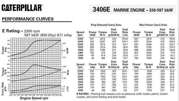

    The S60 is a 14 liter engine, producing up to 825hp at 2300rpms. The nearest equivalent of the time was a 14 liter 3406 CAT, which came in at 800 hp at 2300 rpm. Both are inline 6 cylinder engines.
    Since Torque (foot - pounds) is calculated as (5252 x hp)/rpm, you can only change hp or rpm so not sure what you mean by not as "torquey"? An apples to apples comparison would have to include the same gear ratio for each vessel, otherwise you are introducing another variable.

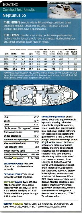

    i ran 3 identical boats with the exceptions of the power plant, all at the same time and all were 2007's (as well as 45' cabo's with S60 and cats and mans). I ran 3 55' Neptunus cabriolets. 1 had 825hp series 60, 1 had C 15 cats 800 or 825hp, and 1 with 1000hp C18s and ran them all 1000s of NM's. They all had the same gear ratio. For a matter of purpose I won't talk about the c 18 boat. The series 60 boat full of fuel/water and food would only cruise at 23.6 knots at 80% load, then once you burned off 1/2 fuel 80% load would run the boat 25.6-26 knots..... the C15 boat would cruise at 25.6 knots at 80% load full of fuel, 26.5 knots 1/2 full of fuel. The C18 boat loaded......80% load was 2 knots faster than the same HP series 60 boat. The series 60 didn't have the torque to carry the weight. The series 60 boat also took noticably longer to get on plane......boats were sisterships with identical equipment. In larger waves rpms would dip and rise as much as 75 RPMs at the same throttle setting with the series 60, whereas the most the rpm's varied were 20 rpms with the CATS. The series 60's acted the same in the 45' cabo's versus the 800hp cats (cabo used 3196's or later C15/18s).....

    Different motors make different torque ratings at different RPM points, pull up the propellor charts for both a series 60 and say 3406 Cat both 800 HP and you'll see the CAT's make more torque and they make more torque early on in the rpm range.......

    The CAT 3406 has a torque advantage in the 1600 - 1800 rpm mid-range while the S60 has the torque advantage above and below that 200 rpm mid-range.
    But how was the Neptunus 55 Cabrio with S60 propped? The only boat test I could find showed a max rpm of 2250, which is about 100 rpm off for a test boat. What rpm where you running at 80%load?
  11. Capt J
    14,649
    I don't remember how either boat was propped. I do remember both barely made it over factory rated full RPM's at full weight. Both made 10-15 rpms over factory rated. Series 60's are 2300 rpm motors.....C15's and C18's are 2350 rpms . Had issues with both engines. The series 60 had a leaking aftercooler on the port engine at 2 years old and 200 hours....they changed both aftercoolers under warranty.......Port V drive also had a leaking lip seal taken care of under warranty. The C15 boat had a head gasket leaking coolant on the port engine and they had to yank the head. The 55' Cabriolet is a very good riding and running boat though.
