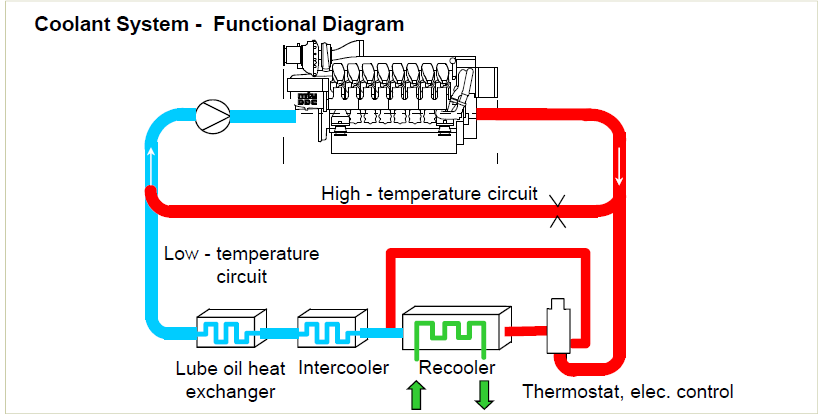

    The S4000 uses a split-circuit cooling system, here is a visual aid:

    Interesting.
    Yep, the oil temp is thermostatically controlled.
    Both engines failing at the same time is still funny. I wonder if a coolant change or some other service was preformed to help the thermostats fail at the same time.
    I (we all) have learned something new. Probably good re-reinforcement why I call FDDA for MTU work.

    From what I was told (but did not see for myself) was that MTU 4000 have 4 thermostats.
    There where no other issues other than the engine lube oil temp.
    My friend did not get a lot of information on exactly how that was the failure. He asked the tech if they could test the thermostats but they told him no. He did not feel like pushing any issues with them now the job is done and they are gone, he is on to other battles like the VFD for the bow thruster that quit working and the fuel separator that wont go out of alarm mode and a captain who wants to leave yesterday... Oh the joys of engineering on yachts.

    Per the diagram in post #22, I would think the charge air temp and dentistry would cause errors.
