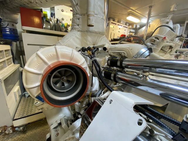

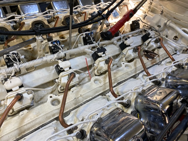

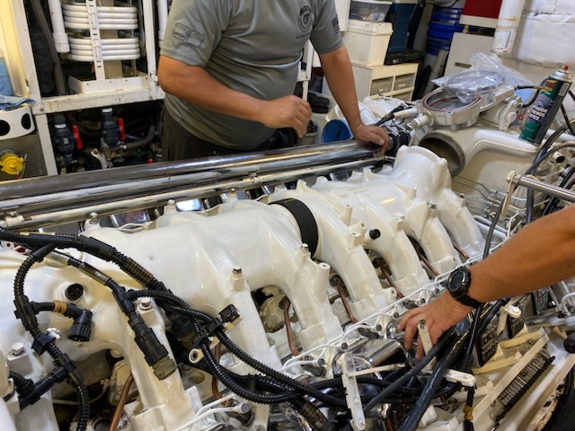

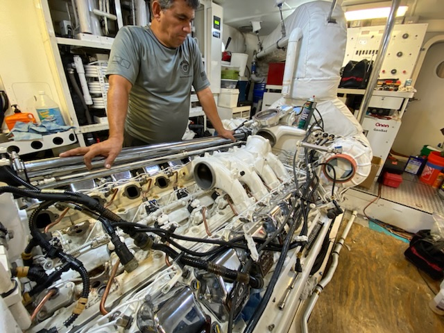

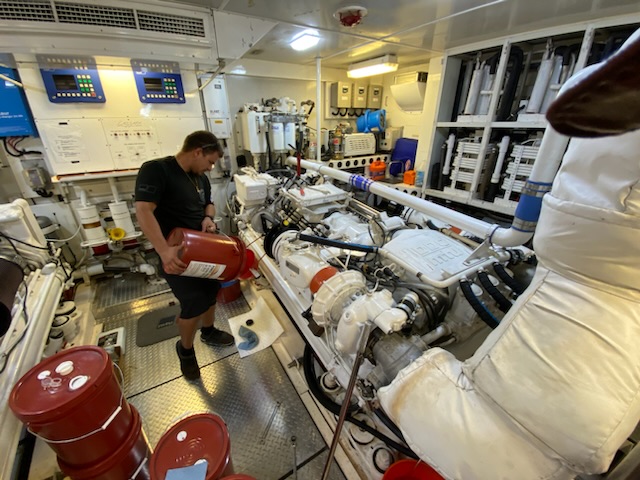

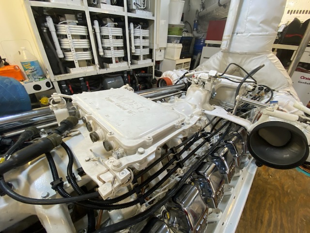

    Fuel lines installed, intake manifolds as well and a bunch of other things. Getting close!

    Looks like a LOT of work, Pascal. I feel guilty for watching the rebuild from the comfort of my office chair!

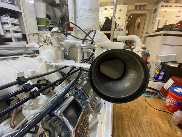

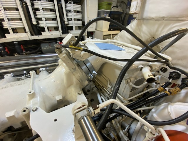

    More…

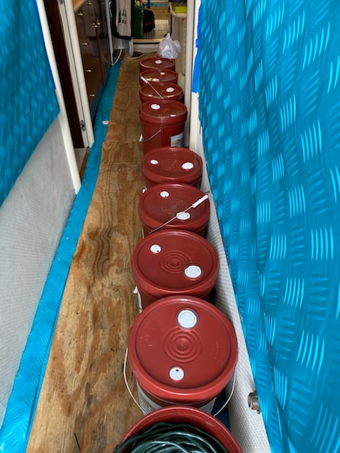

    Always a good sign when the oil goes in….

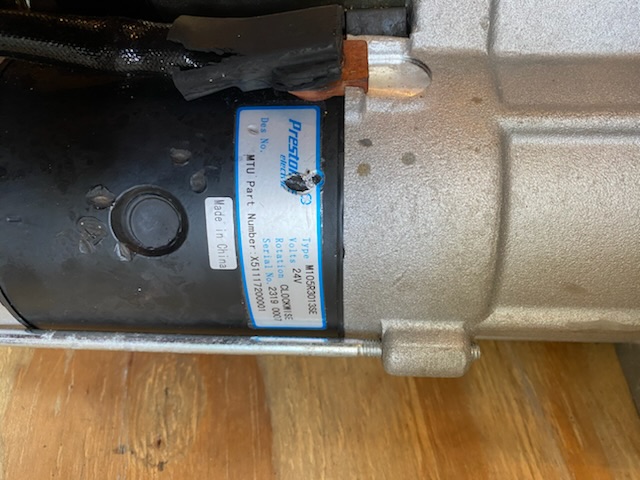

    the only glitch of the day was this morning when I went to fire up the port engine to check hydraulics and steering. Starter spun but didn’t engage. They replaced the starter when they got in. It was only 15 months old (replaced last year when we rebuild port).
    it also had a nice little sticker made in china…. Luckily I had kept the old one and had it rebuild. Turns out that MTU is having starters made by Prestolite in china …. And the kicker is that parts to rebuild the older MTU starters are no longer available.
